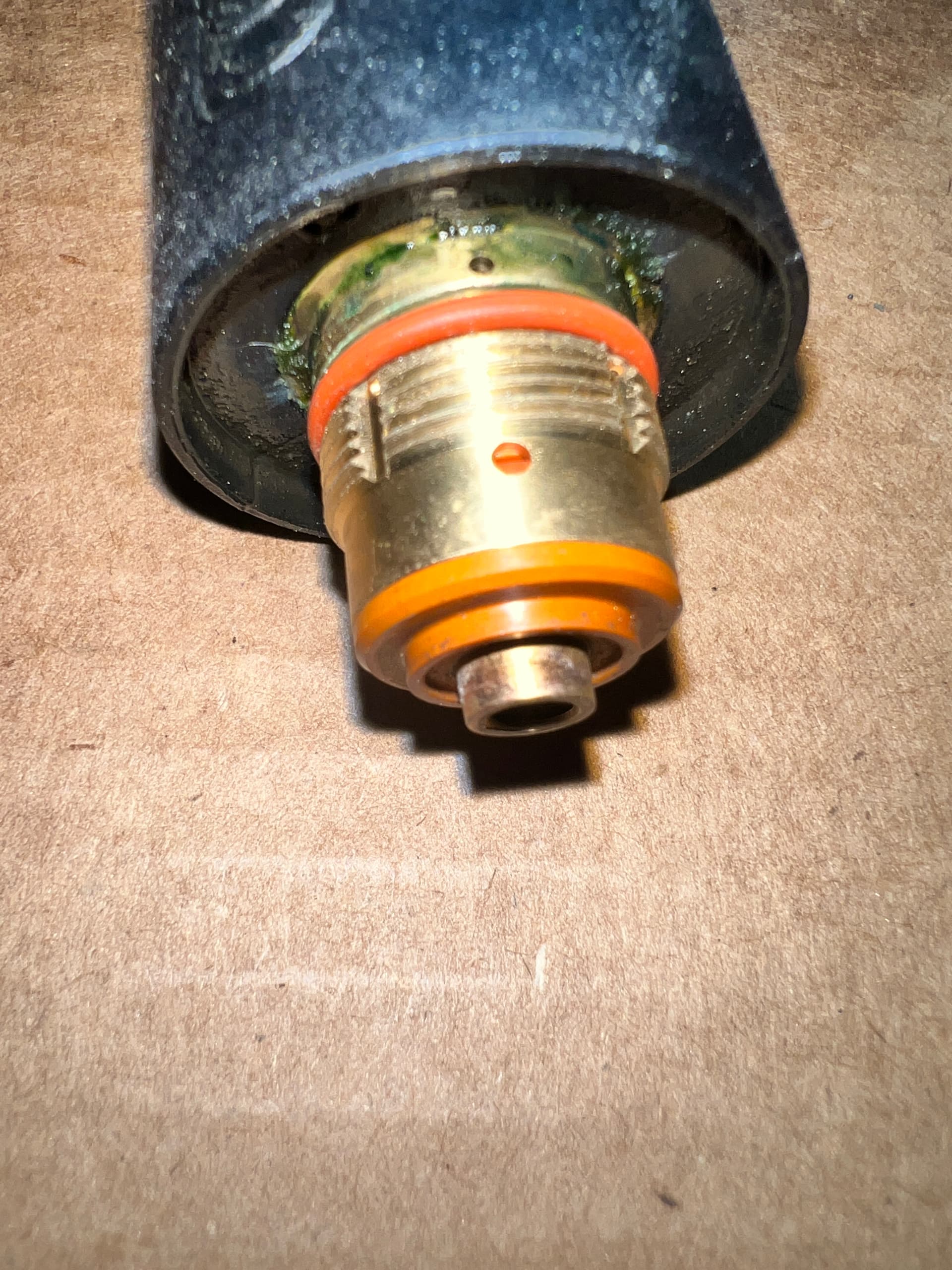

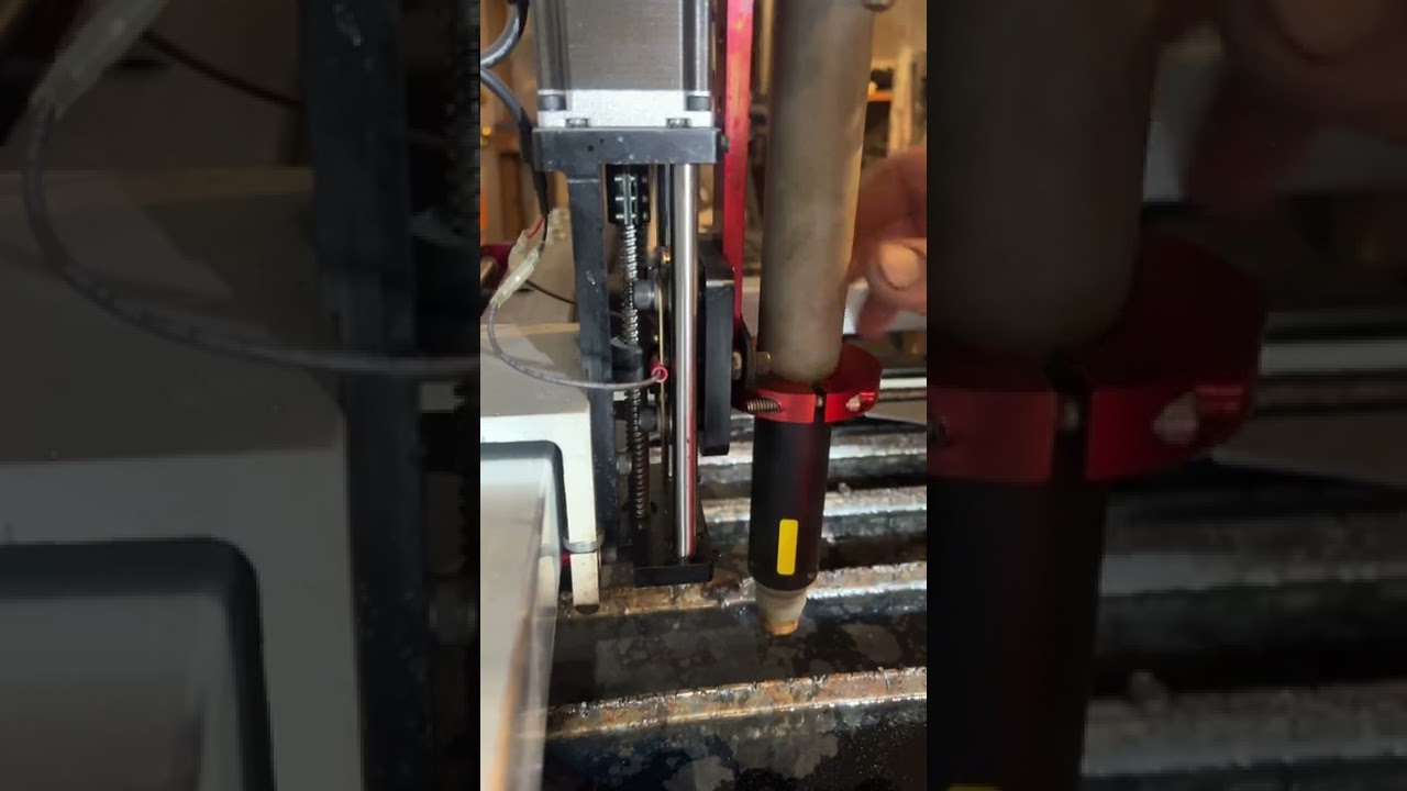

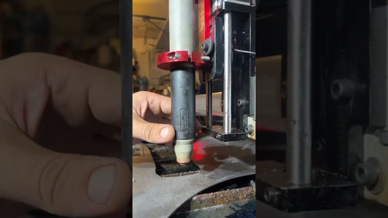

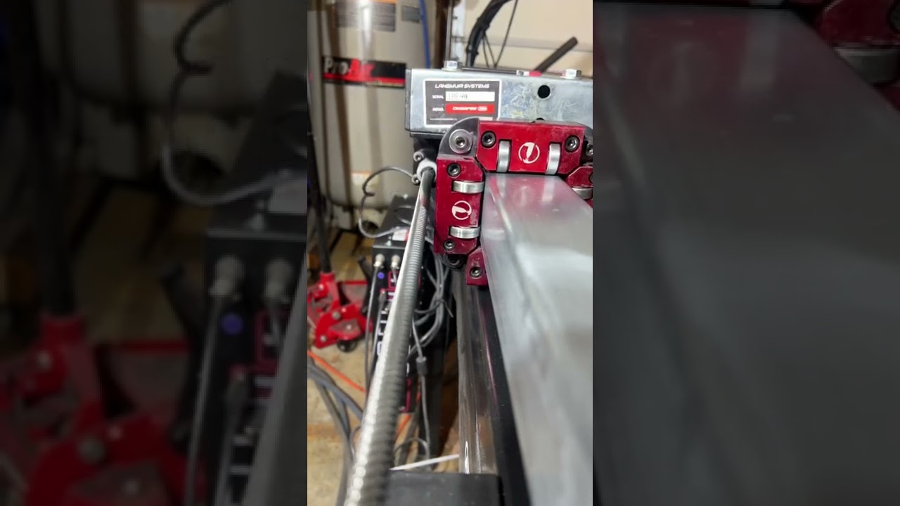

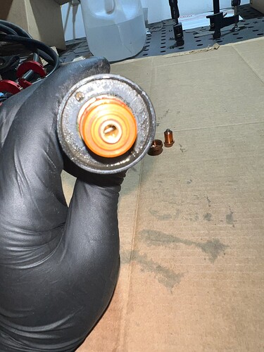

I cleaned the all the square tube as some spots felt a bit sticky I’m guessing from the water table additive, after that I took all the videos and pics I mentioned I would.

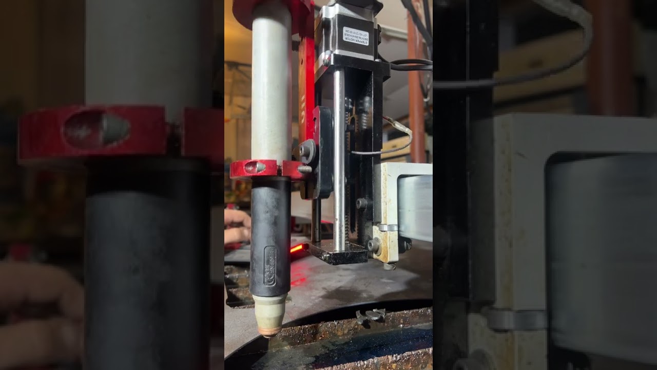

I didn’t do it during an actual cut but I was running at 100ipm, I can do it during a cut once I have the hand torch installed, which I’m in process of doing

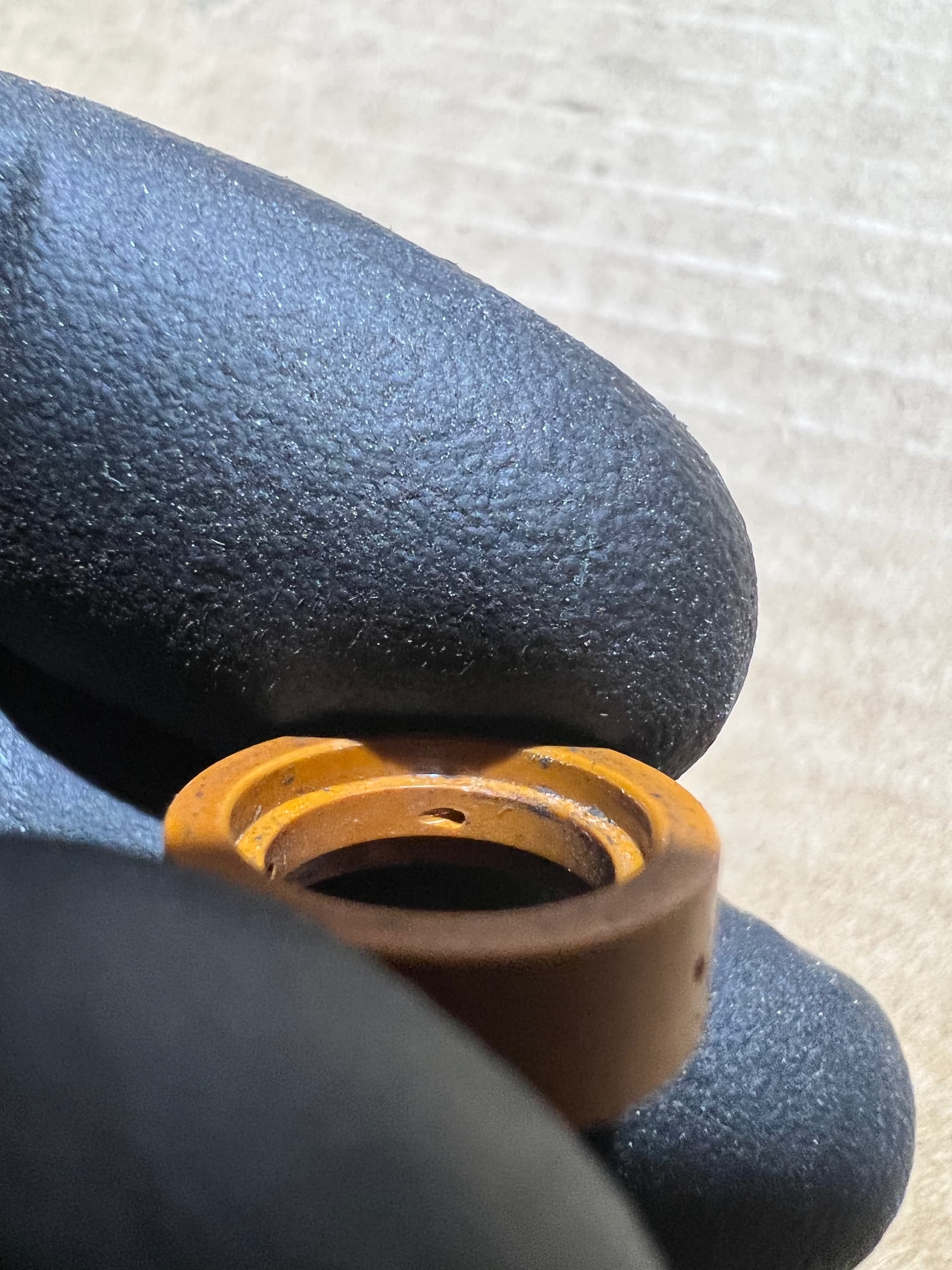

The torch was last used to cut the “good” example in my OP which was right after the bad cut. So consumables have just two signs 18x16 on them it’s probably 100 or so pierces I could be off tho
VIDEOS:
Z Axis Movement:
Z axis moving
Z Axis Other Angle
Z axis wobble at different height

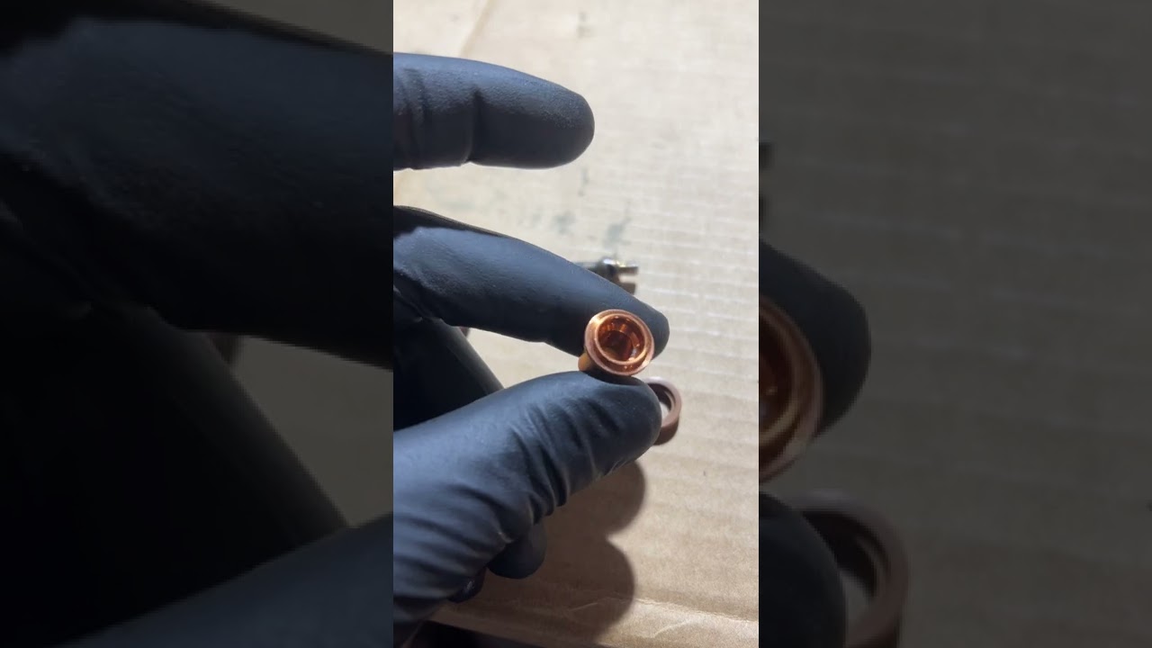

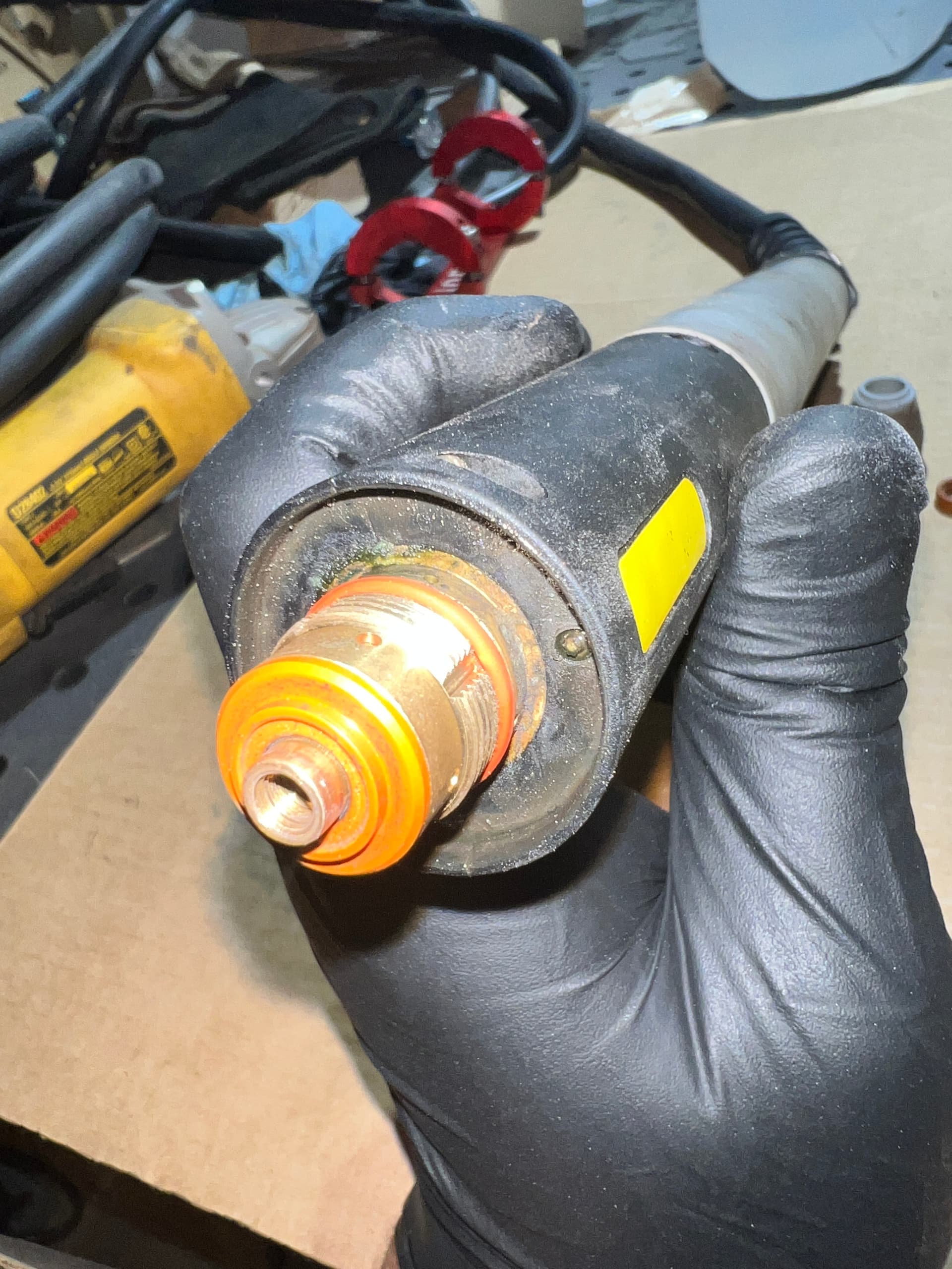

TORCH:
PTM60 Torch Parts

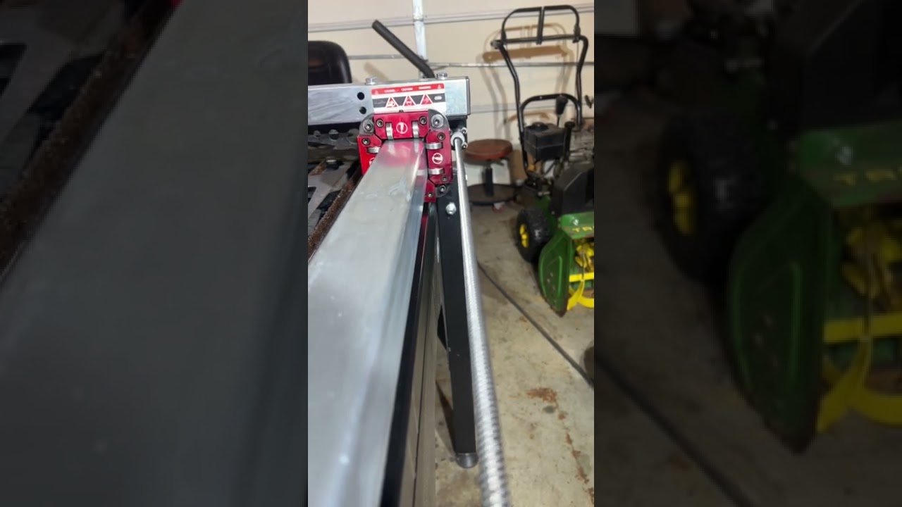

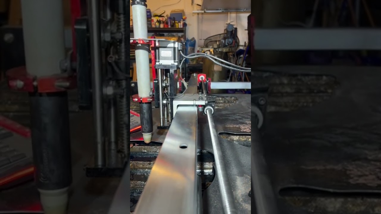

SCREWS/BEARINGS:
Gantry Bearings (all sides were just like this)
X Axis Lead Screw
Y Axis Right Lead Screw
Y Axis Left Lead Screw

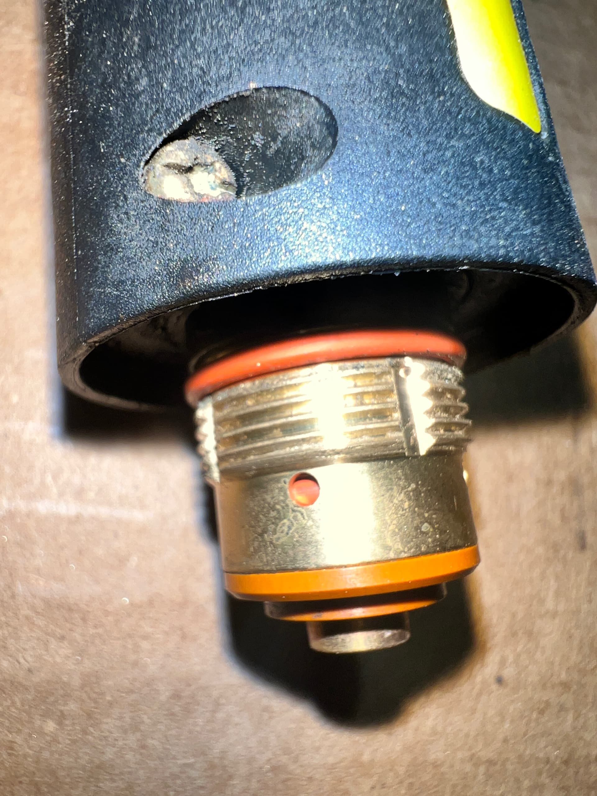

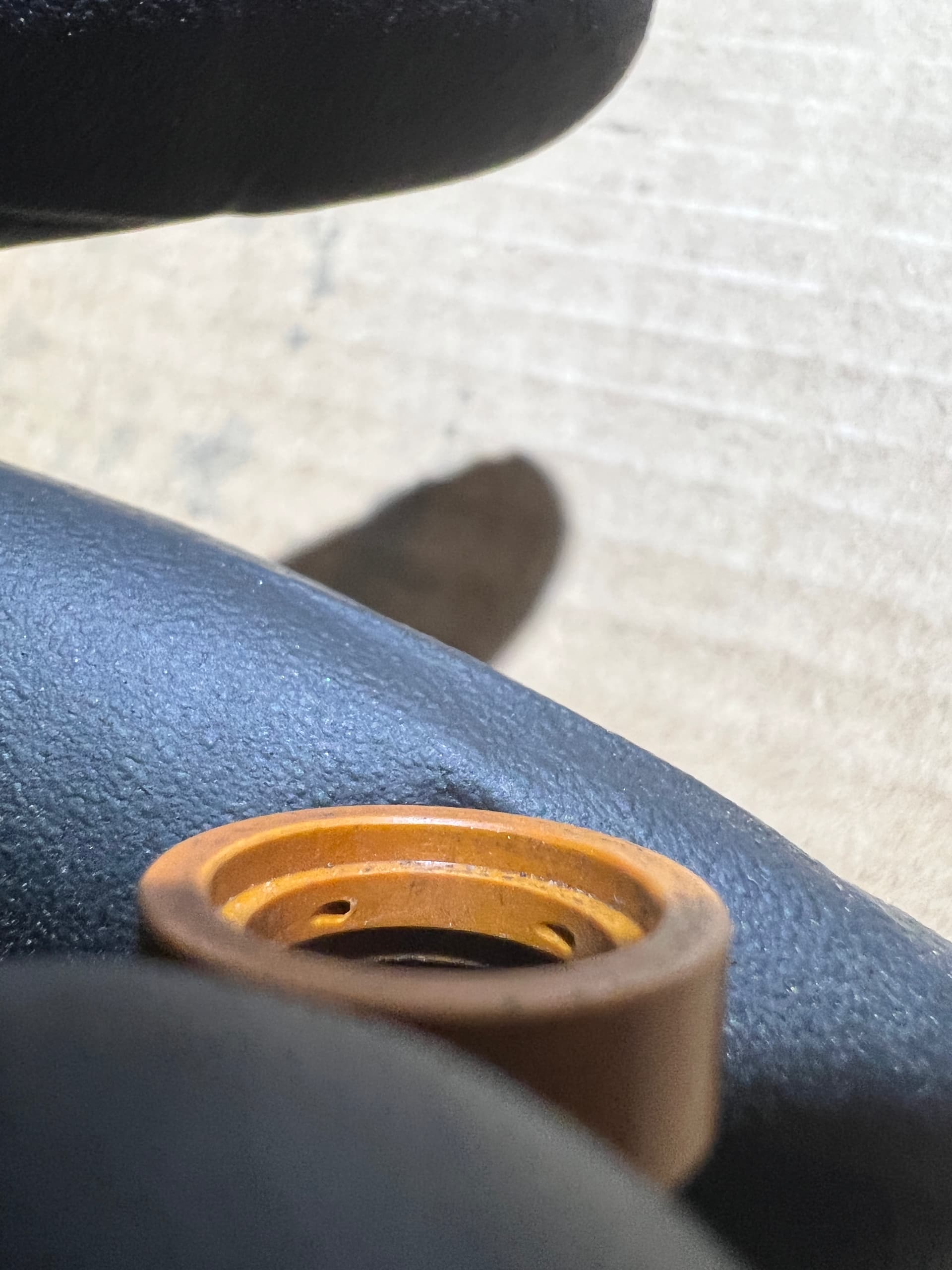

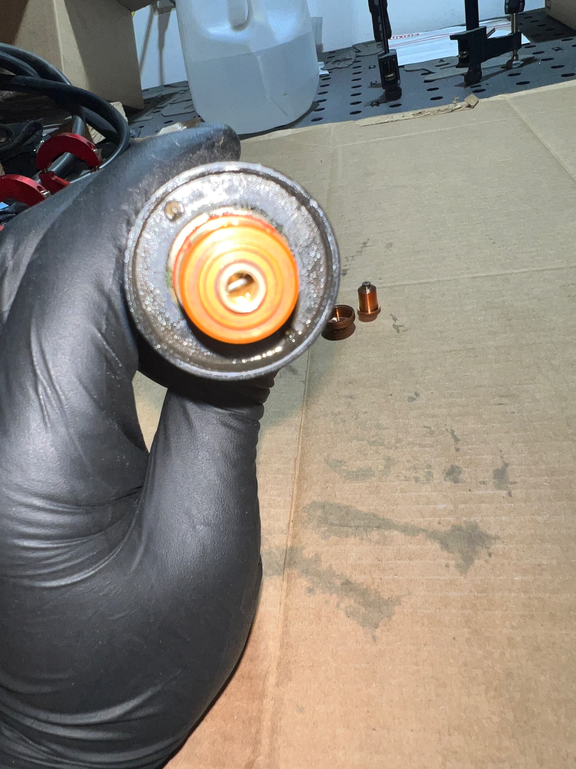

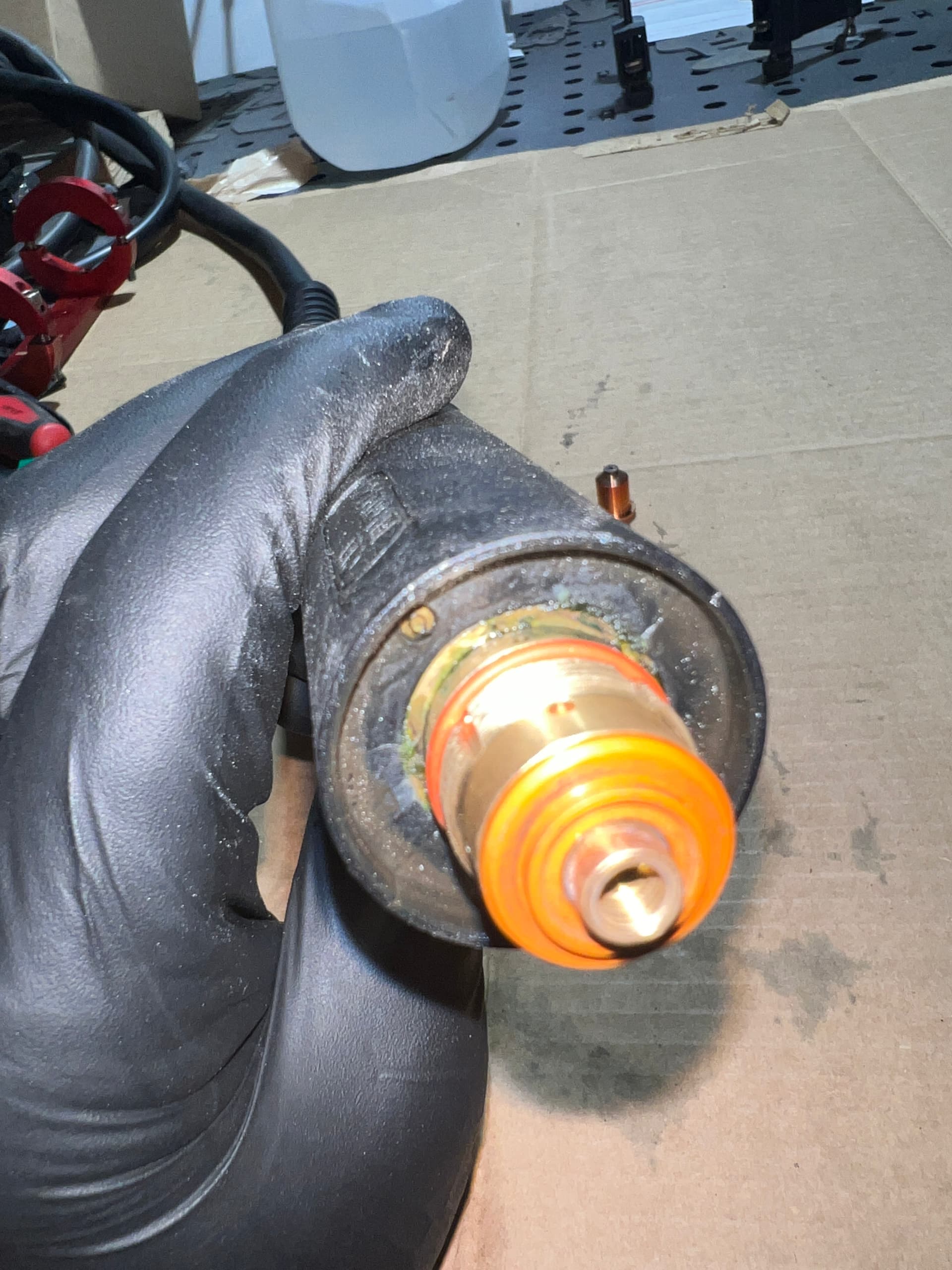

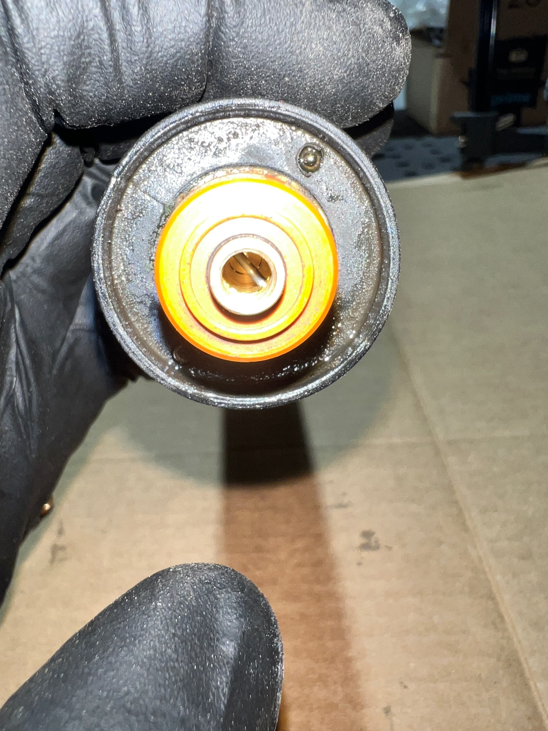

PICS (some water because I dunked torch doing Z Axis video):

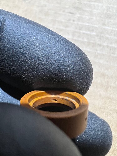

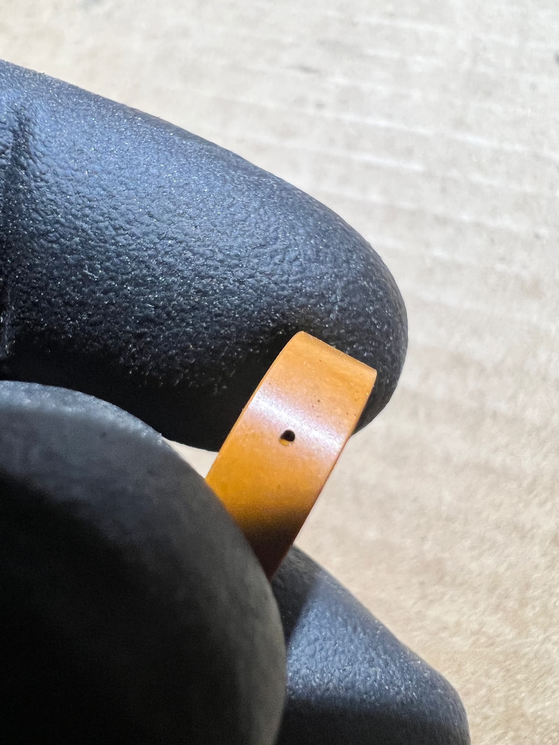

make sure your swirl ring is in the correct direction. I had a similar issue like your having and that was most of my problem. I don’t remember off the top of my head which way it goes, and I’m not at my shop to check. I marked mine with an arrow so I know which way to install it. search on here and you’ll find the right way it needs to be
Yea I refer to George’s pic on here with the bits of metal sticking out every time I change consumables because my memory sucks lol
i also marked my lead screw to coupler and coupler to motor shaft with paint markers to see if anything ever gets loose. if a coupler is loose it can cause issues like this.

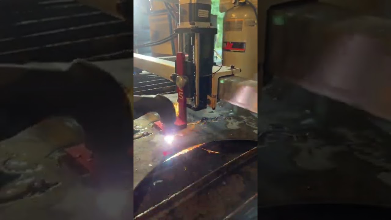

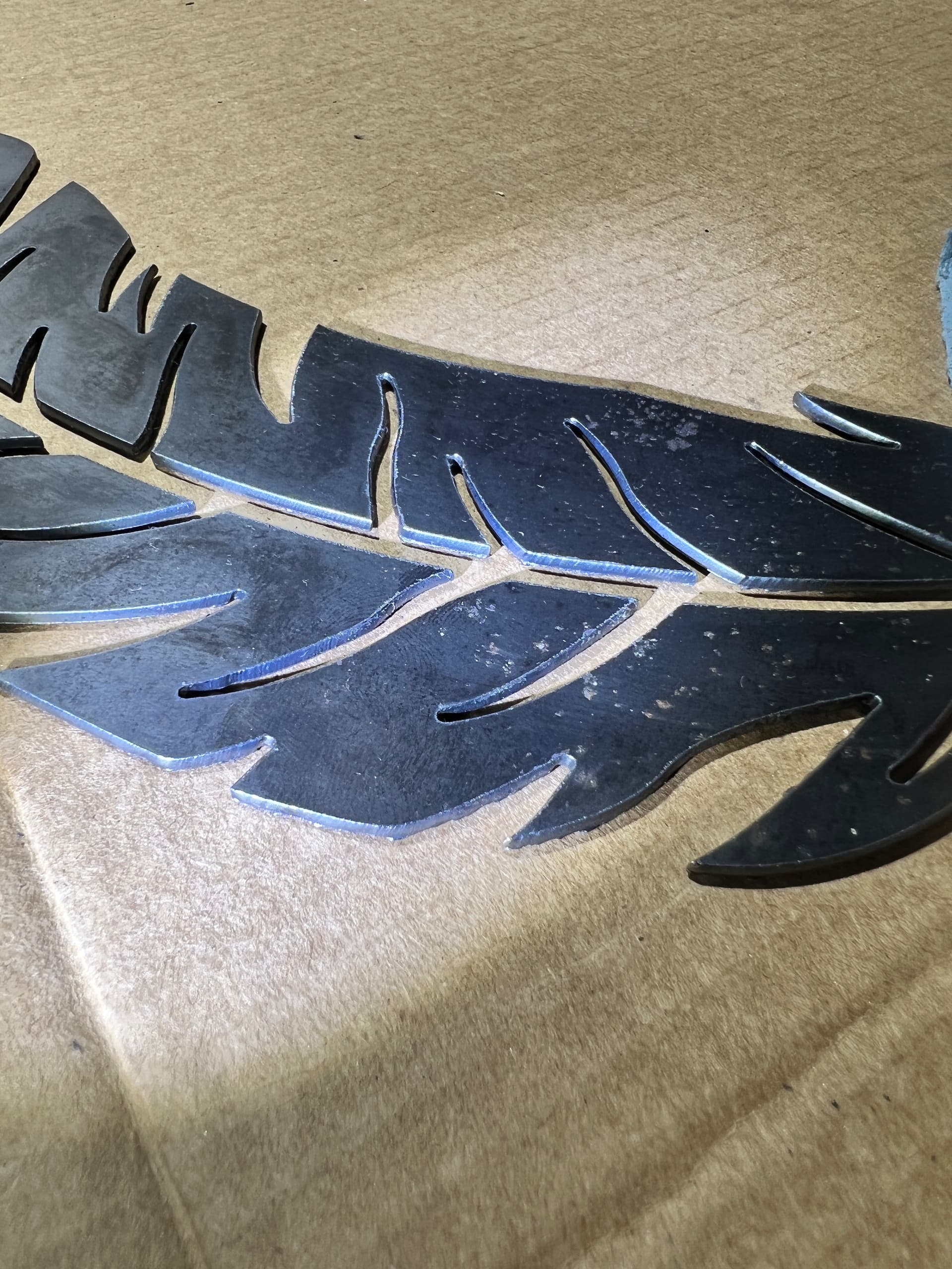

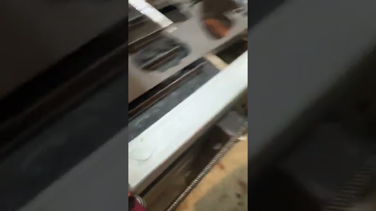

Well, since I need to do test runs to try and solve this I’m cutting inventory now. I installed the hand torch last night, Running a screen recorder on firecontrol and video-ing the cut with my phone.
Let’s see how many things I can cut now that it knows I’m watching lol
I reinspected everything all seems tight where it should be and free moving where it’s supposed to be.
brief side note: i had been running at like 120IPM for a long time, changed to 160 not too long ago (had problem at 120 as well, but in my mind i thought slower = safer) and boy do these things cut quickly now. Feels like this thing is so close to perfectly dialed in, thats why this issue annoys me… besides the wasted steel.

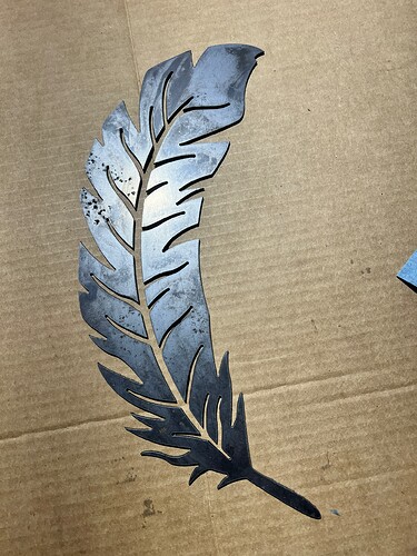

It’s cutting great with 0 issues so far, cut out a bunch of signs, only grabbed pics of these
So if switching torch whip fixed problem. I would have to switch back to try to reproduce the problem. Glad to see the improvement.
so far its working better, i dont trust it further than i can throw it. So i’m going to keep monitoring it, got a ton of stuff i can cut so we’ll see if anything occurs. The random-ness of the issue has always been the worst part. I’ve tried making sure I’m doing these cuts close to where i know the issue popped up last time just in case

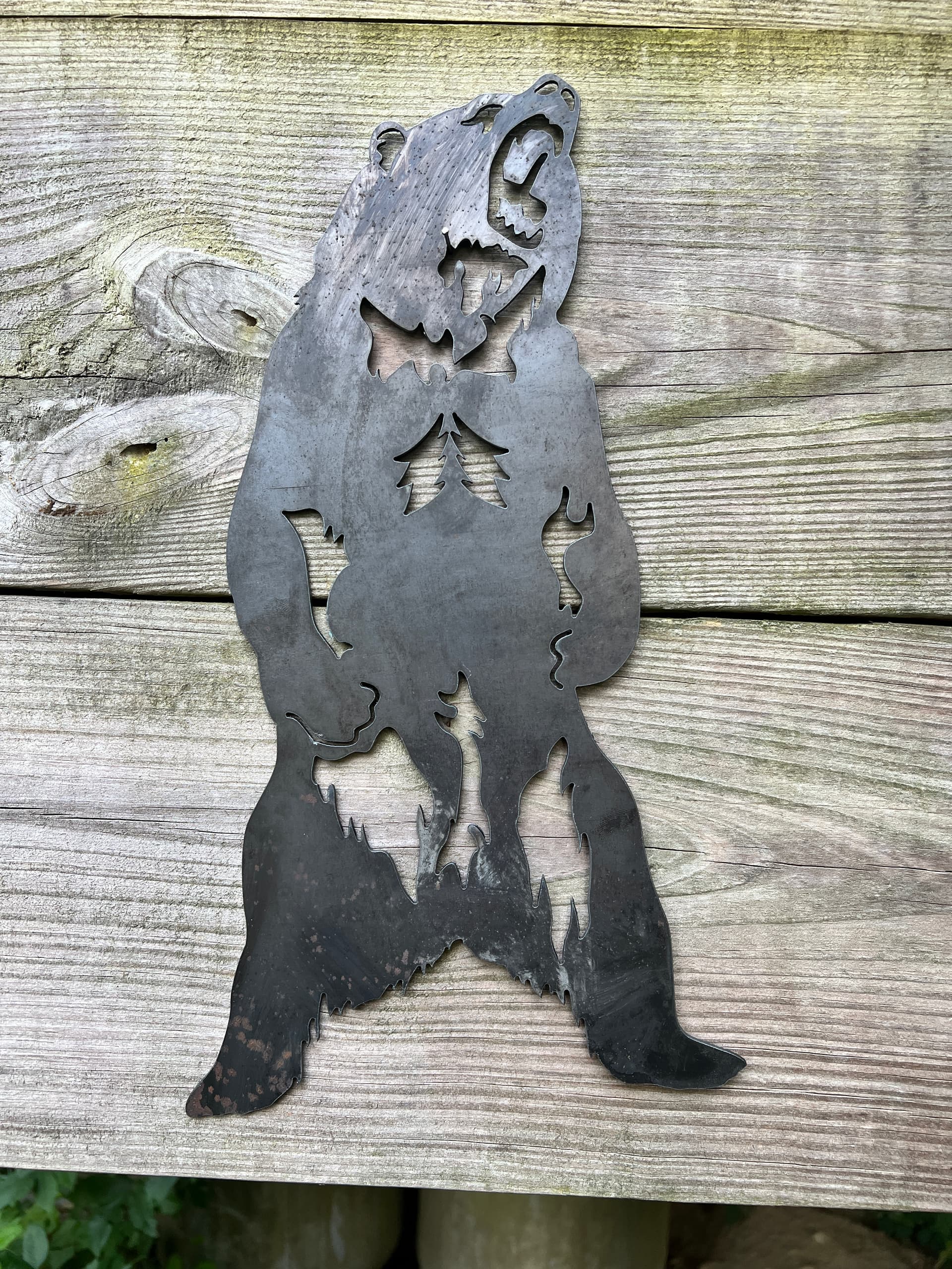

Since i recorded it i might as well at least share it, here’s me cutting out the grizzly bear
Grizzly Cutout
What is that bracket used for that is attached to top of the Z axis motor?
Bear looks great.
It was for the “better laser mod” or something posted on here for laser cross hair. I removed it thinking maybe my cheap lasers could be putting out RFI or something
Gotcha, I was thinking if you had machine torch lead attached to that bracket that it could have been giving you jagged cuts, because of lack of slack on torch lead.
Oh yea definitely not, made sure had plenty of slack for both torches, but I had thought about it and interference from grouping it with other wires so I had it run to the plasma by itself and made sure it wasn’t pinched anywhere and had slack at the mount

So it was your machine torch having an air flow issue causing your problem?
Is that what ended up solving this issue?
Congrats on your hypertherm I was very happy to switch out my Everlast 60s for a PowerMax 85 a while back.
And I just purchased a 45 XP, I really wanted to try out marking capabilities.
As of this moment since swapping that torch I haven’t had the issue occur in that time I’ve done 5 average pieces (for me), but in a little while I’ll be putting it to the test cutting out another of my car designs.
If everything goes smoothly on that cut I’ll be comfortable saying it’s fixed.
Only things I did was torch swap and cleaning the x/y rails
