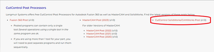

My son uses Solidworks, since he attends a college which has settled on it. He had designed and 3d printed hundreds, if not thousands of parts for robot combat. We have made a small handful of UHMW CNC parts on our MR1. However, I am disappointed in the SW support, specifically their post processor. Admittedly, I am not an expert, but so far we need to basically disassemble the g-code that the prost processor makes into smaller chunks, and run it a little at a time. Am I missing something? Why cant cut control understand canned cycles, such as peck drilling and milling out a larger hole with a smaller endmill? Anybody make a ‘converter’ that can take solidworks, or the full language of g-code, and make it usable on the MR1? Is there a definitive writeup on how to better utilize the post processor? It seems the Langmuir kinda stopped after they wrote CutControl…
I am way out on a limb on this one. I can barely open my hobby license edition of SolidWorks so I don’t know if my response has any merit:
Did you load the “Post Processor and tell Solid Works to use it?”
This file needs to be loaded on the computer that has Solid Works. When you go to the post processing screen, be sure that it links to that file.
Here is the Download page link:

Yes, we have the post processor loaded, its just not very functional.
