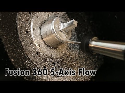

And here is a crazy fun video (5th axis???):
Note: I changed the title of the topic from access to axis
