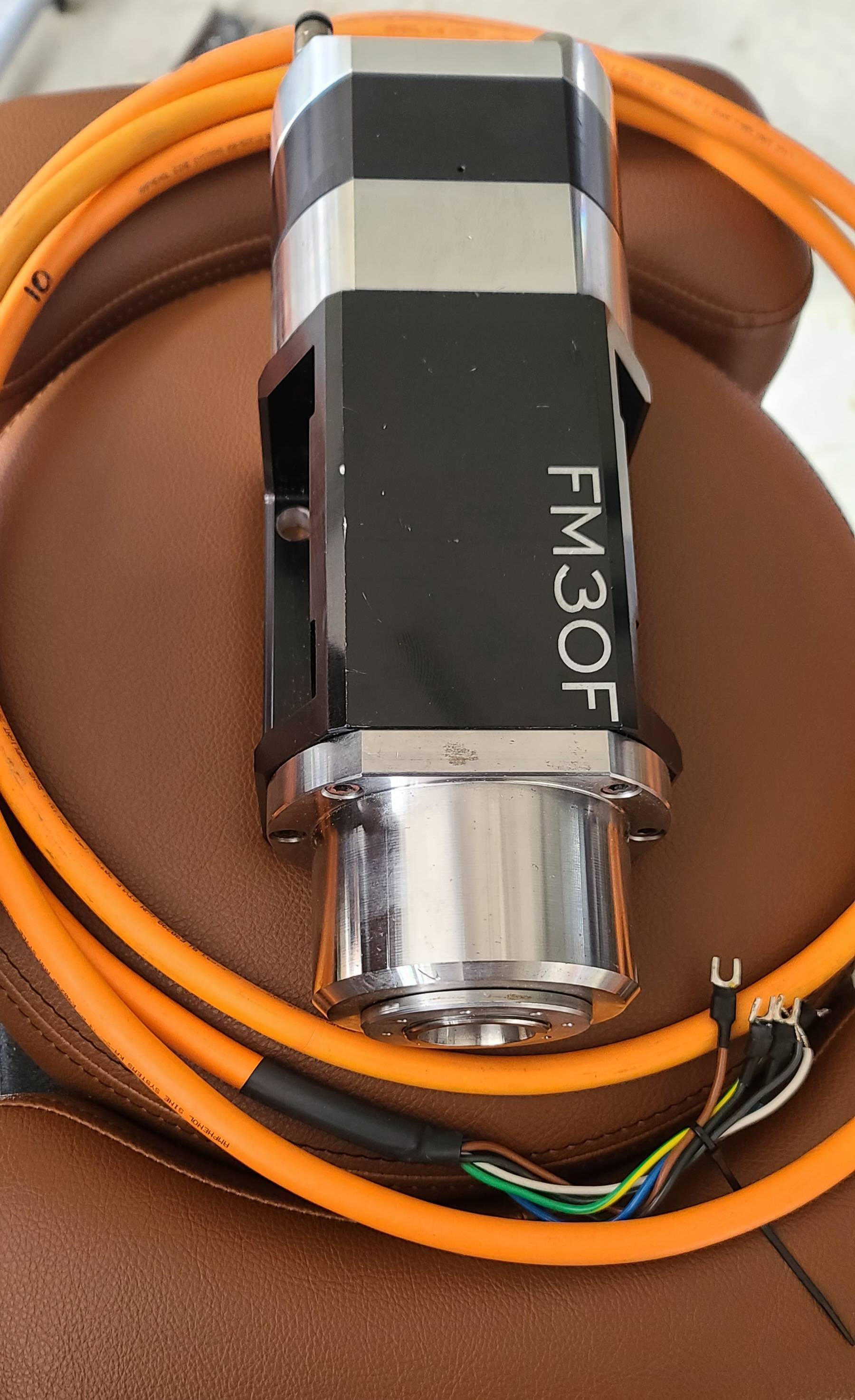

I know a ton of people are wanting an ATC for their MR1. I wanted to show what I’ve been doing.
Precursor: My machine has already been converted to LinuxCNC, closed loop steppers, and different touch probe. If you want more info check out @AlexW Github: GitHub - alexphredorg/mr1: Langmuir MR-1 configuration for LinuxCNC Just note that I had to do a good amount of changes due to updates of items from Linuxcnc. It’s inexpensive hardware but definitely can be a time sink to figure it out.

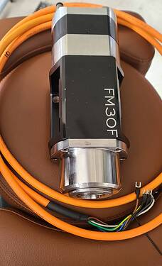

Moving on, a few weeks ago I was able to pick up a FM30F spindle off eBay for pretty cheap, this is not common to find these used.

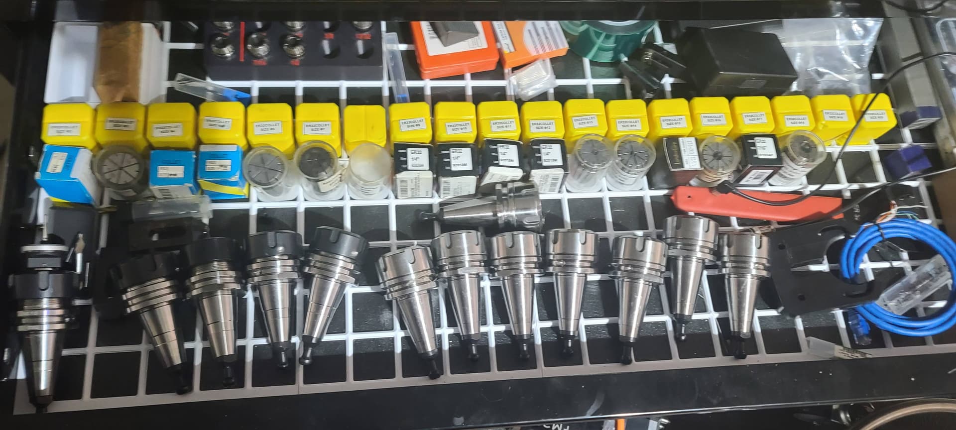

Also, received a good amount of collets and Tool Holders, had to make room.

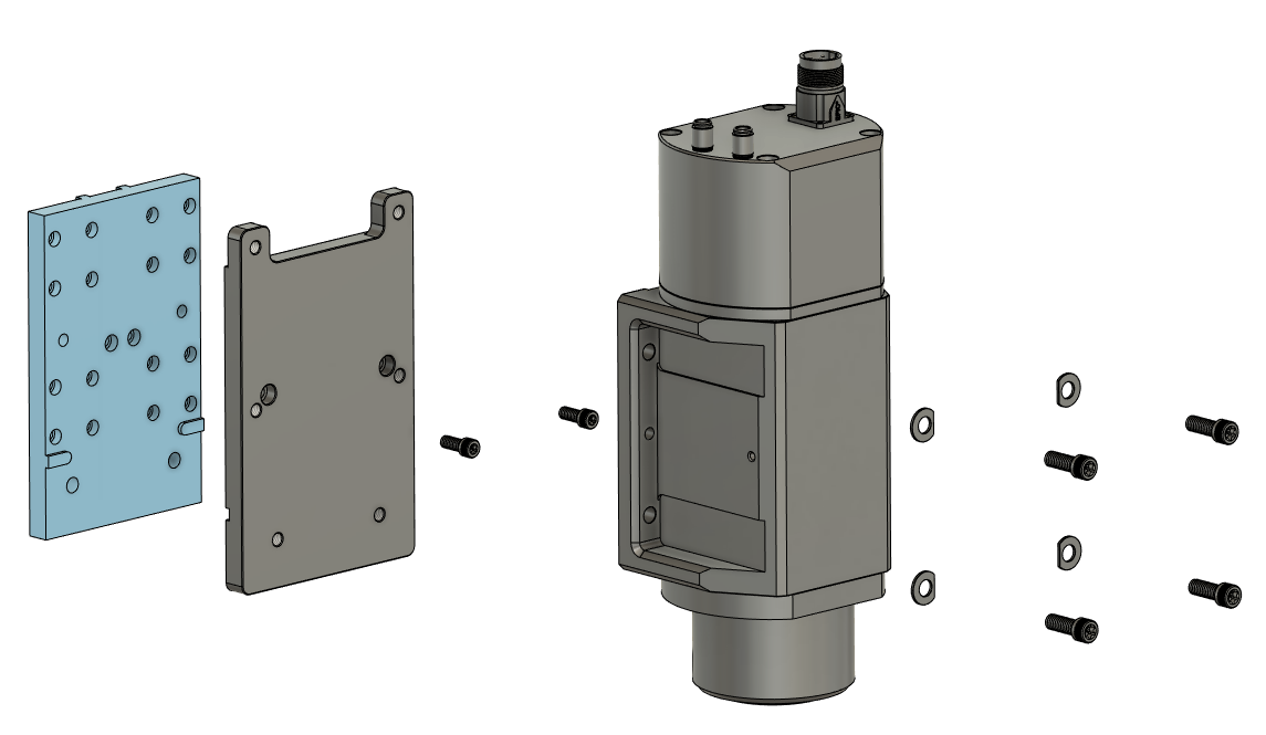

Since then I designed an adapter plate that will bolt directly onto the MR1.
This uses some 1/4-20 and 5/16-18 bolts with some clipped washers.
Slowly working through the electrical cabinet layout and redesign for air and spindle control using the Mesa 7i84u.

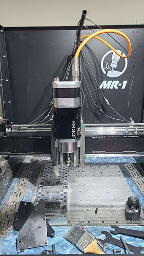

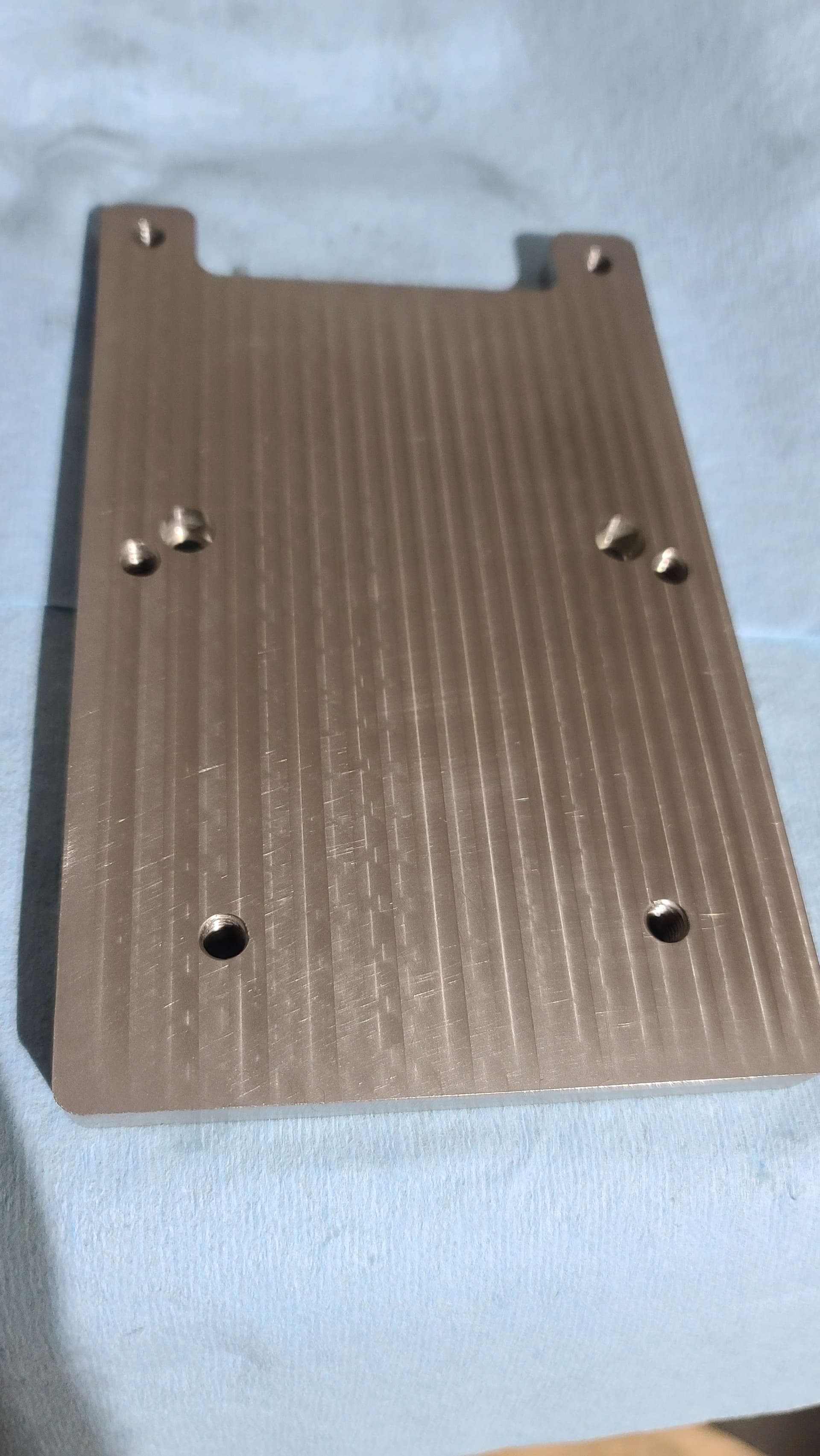

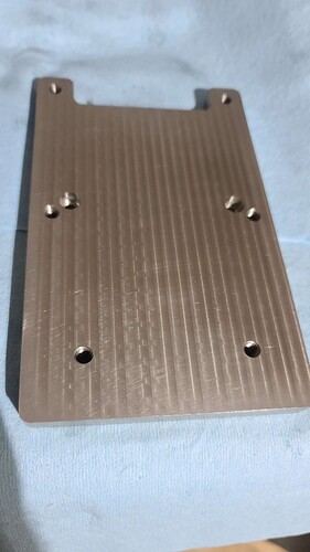

Made some progress over the weekend and got the adapter plate made.
I have the FM30F temp. mounted to make sure everything fits.
Now its time to get to the electronics!
