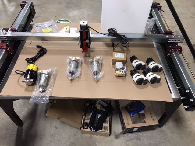

Well, some of my stuff has started to arrive (funny how this table has become its own project)
Wow, it looks so clean…that wont last long. LOL :laughing: Having a blast with ours.
