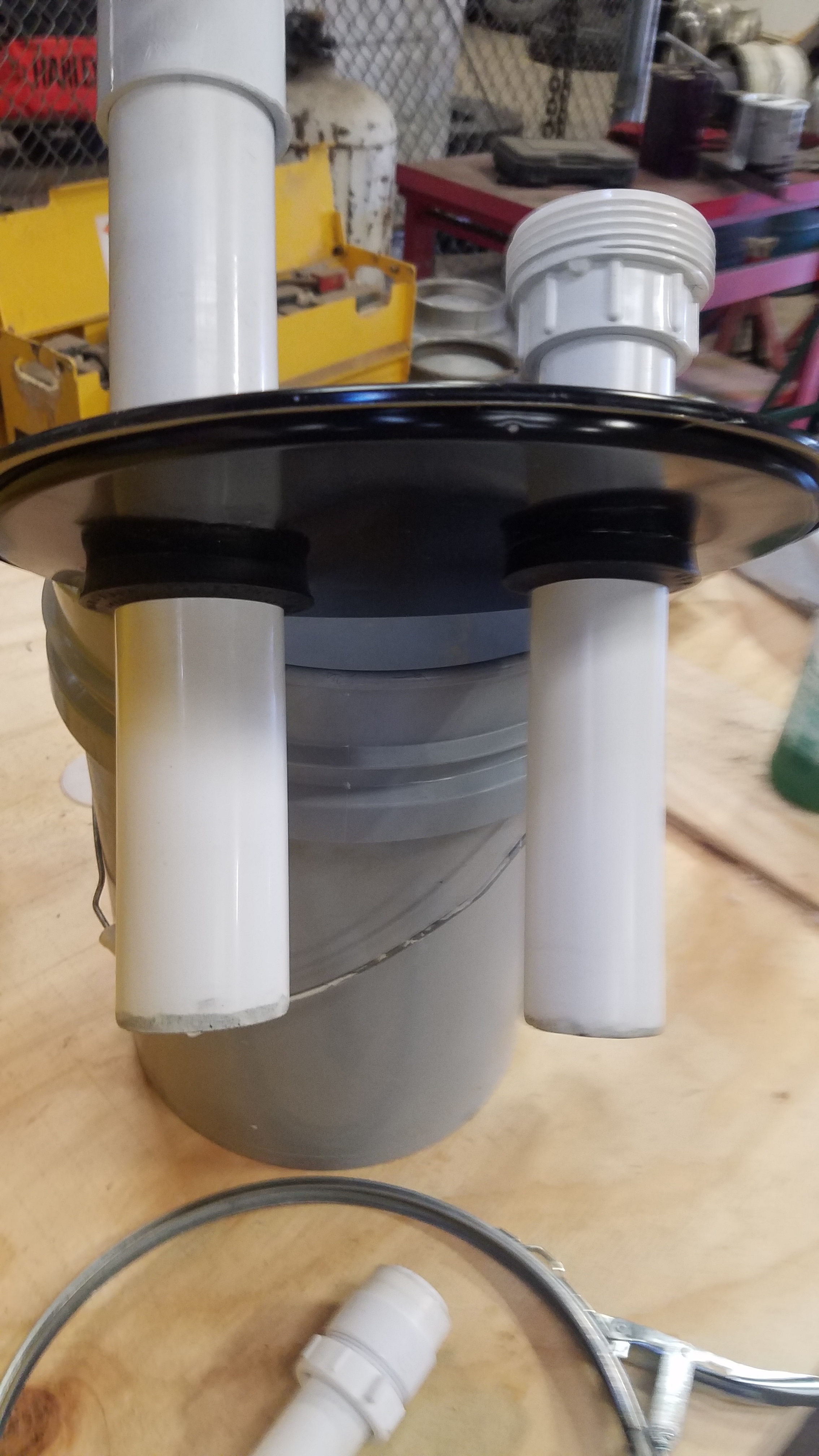

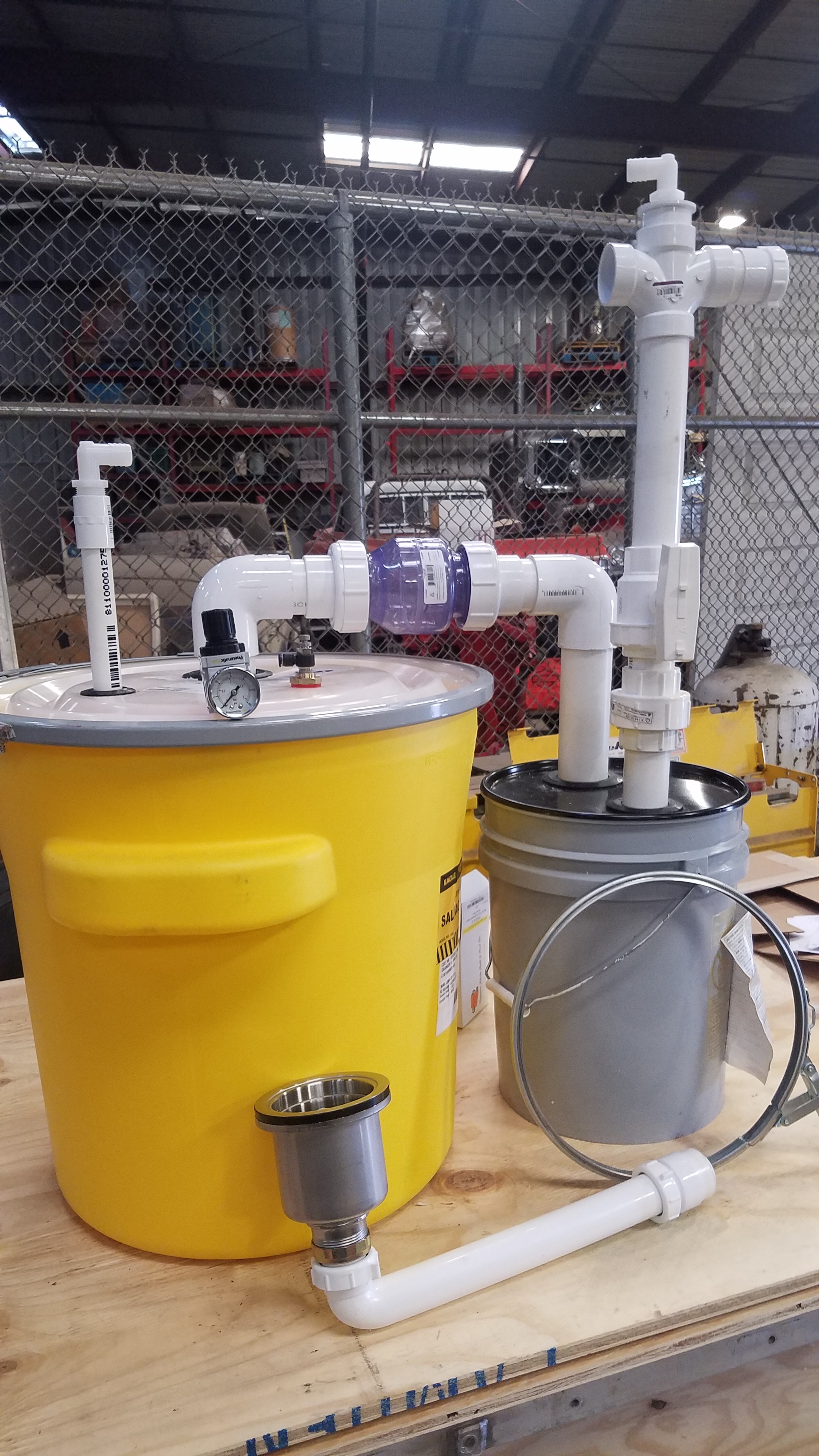

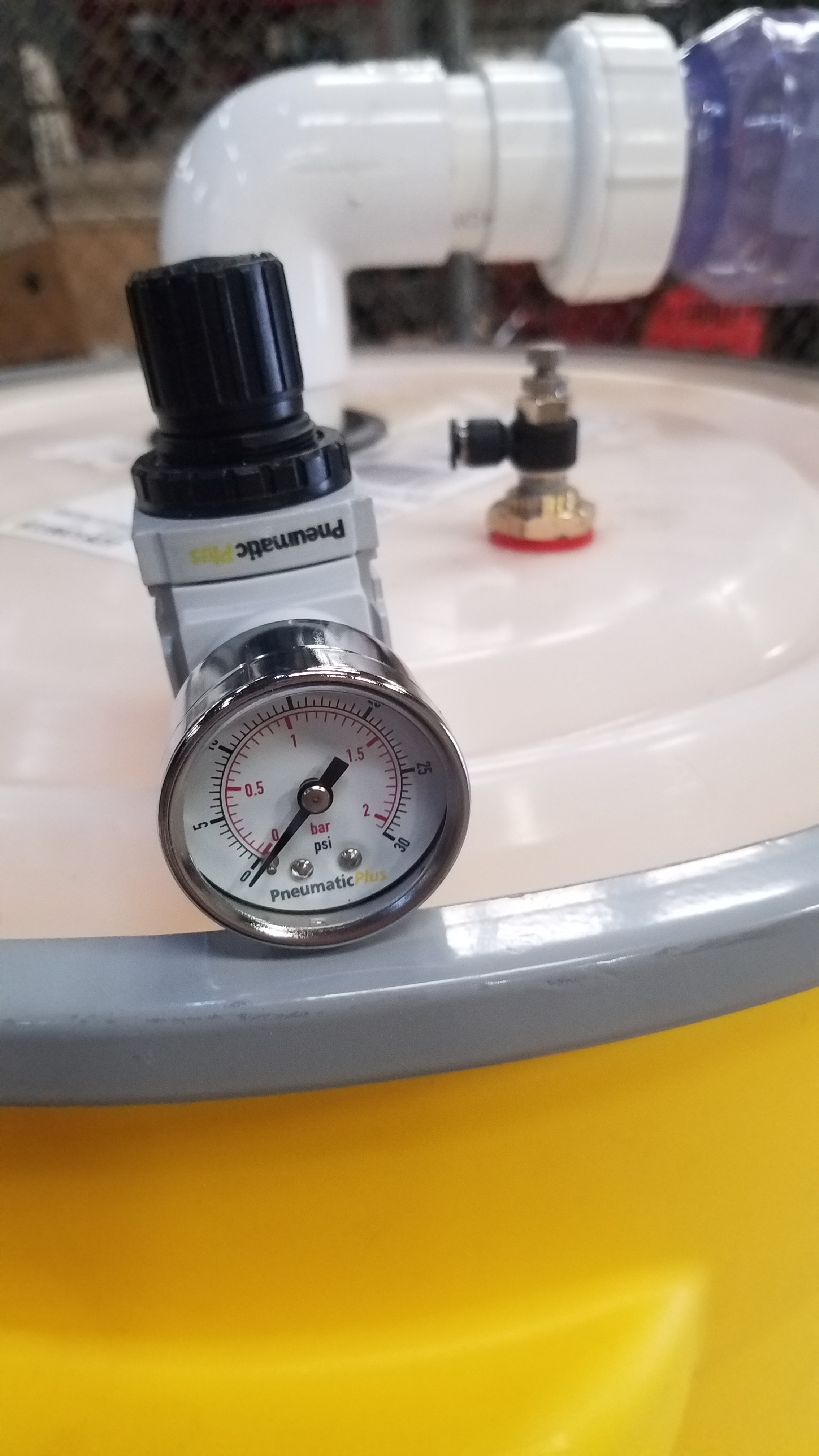

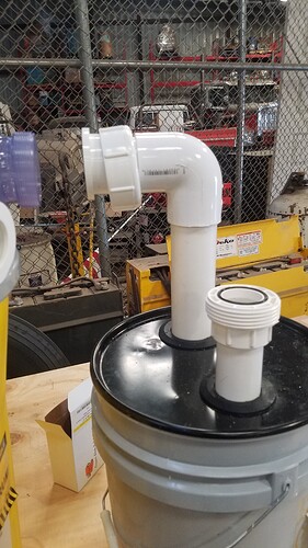

My take on water management. 5gal bucket will catch metal that doesn’t get caught by sink drain basket. One way flapper valve will close when a couple of pounds of air is applied to fluid in yellow barrel. Using low pressure regulator 0-30psi and adjustable orffice to keep from shocking tank with initial pressure. Easy disconnect unions to allow 5gal bucket to be dump or replaced. Steel clamp to hold lid on the bucket. Height and drain pipes will need shortening once table is together.
Close the drain valve when filling. Water will fill back thru 50micron filter to drain tee with 3/4 hose .
Pipe size is a little overkill. But i had some of the pieces on hand. Still need to add close able vent valve to yellow tank.

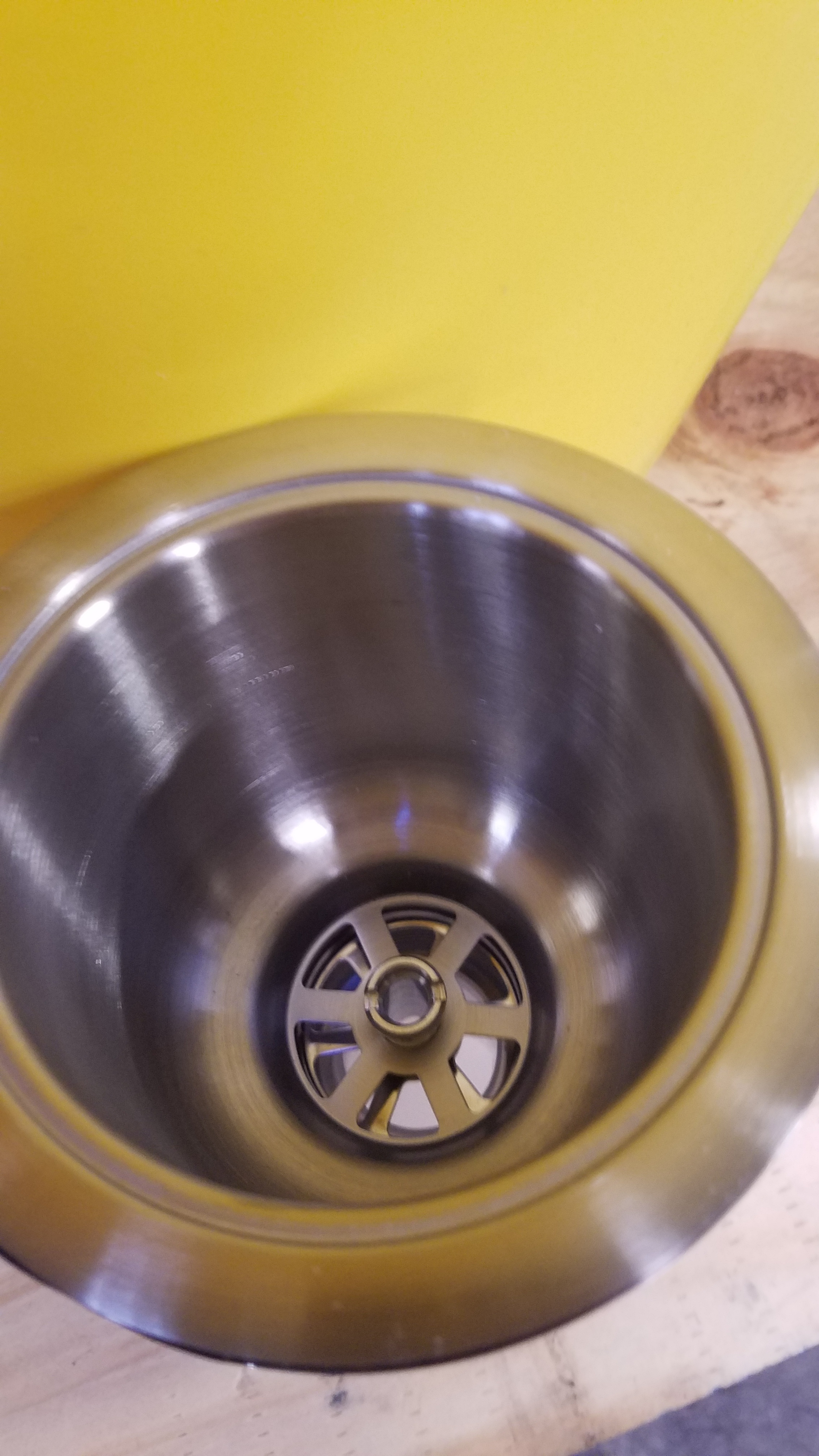

I used a standard kitchen sink stainless steel drain…has never leaked…easy to install and plumb to…and cheap…and you can add a stainless strainer to it easy…
and it is so close to flush it works great

how do you get the “clean” water back out of the salvage drum? I guess maybe I don’t understand how salvage drums work?
trying to manage wastewater as simple and low-cost as possible, as I only use the table about once a week, and it doesn’t feel right just dumping the water outside :zipper_mouth_face: can’t keep the water in the table as my shop dehumidifier works hard enough already…
I get the water out by bailing with a bucket (or pumping with a $10 drill pump). Once it’s down to 3-4 gallons or so, I just pick it up and tip slowly into the water table, leaving the junk at the bottom. It’s a 1-2 minute process.

I love the simplicity of using air pressure to fill table. You need a tank that can hold about 5psi. The table gravity fills the tank from the bottom and fills the table from bottom of tank with little air pressure. No pumps to wear out, no filters to plug. I made a 4x7 sump in the table. I put about 3 layers of furnace filter in it for filtration. I use a magnet to clean table and get any micro pieces of steel in filter. I don’t know what is inside the tank, but the water solution comes out fairly clean.
If your referring to my setup. The water flows into the salvage drum thru a 1 way flapper valve, A small amount of air pressure (a few pounds ) will cause 1 way valve to seal shut putting pressure on the top of the water. It will be forced up and out of the 3/4 pvc pipe. Then thru hose to back feed into the drain pipes filling the table.
what is the second little hose coming off your drain system for? Curiosity has me thinking it’s a way to refill table?
