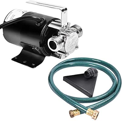

what kind of water pump are you using?
the HF pump i got makes a fuck ton of noise and already ruined one impeller with only a handful of uses.
@KSiegel
The pump I’m using makes a ton of noise too (only negative I can mention) but works perfectly. I’ve been running it at 100% for hours without any issue. Just make sure it never runs dry as that will destroy the pump impeller. I’ve got it hooked up to 1/2” inlet and outlet leading to a distribution system and bypass valve too.
That actually looks identical to the harborfreight unit, including the accessories. The black color is nice though :slight_smile:
thats basically the same pump i have, the one HAWKFABSHOP has looks different.
i dont know, maybe it the same thing
Honestly not sure. Either way it works great other then being a bit noisy! I’m using it to run my fill and recirculation system without any issues.
