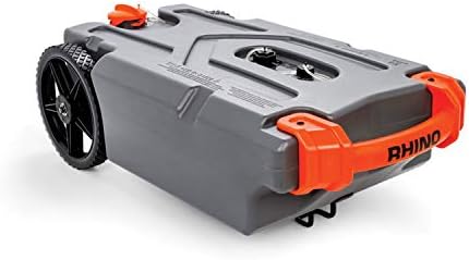

I just ordered a Camco Rhino Heavy Duty 21 Gallon Portable RV Tote Tank from amazon. $109+tax free next day shipping. I liked the idea of having wheels to move a full tank around if needed. I’ll post more after I get it plumbed this weekend.

Just for discussion I too bought an enclosed tank with the same idea as a few others here. Drain into the tank and pump it back into the water tray whenever I want to use the table. I stopped short of this and after a weekend of use I am glad I did. The coolant gets so fouled with whatever byproducts that are generated from cutting that I am convinced an enclosed tank will eventually get crapped up with sediment . The open top type seems to be a better design. At least you can clean it out when it gets nasty.
