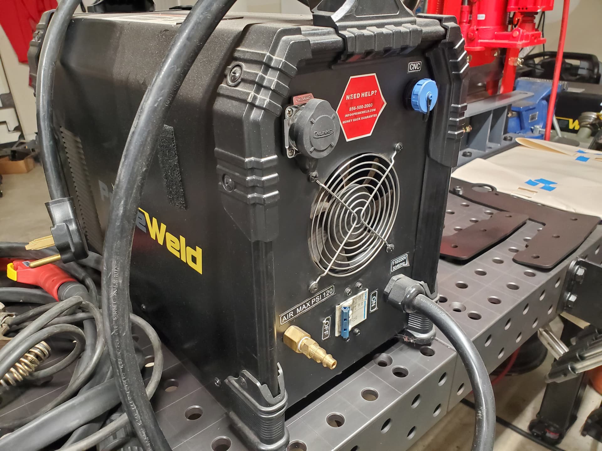

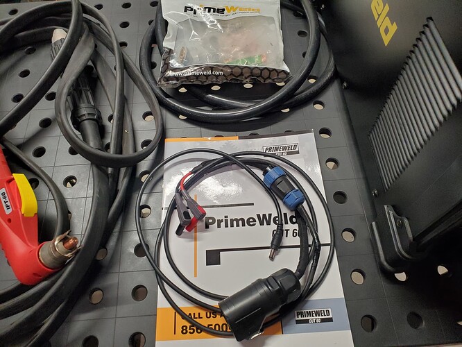

Also, just dug through my phone pictures to show you these. I sold off my CUT60 so these are pics I used in the ad.

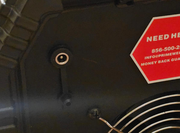

You’ll see the second port there on top. I tapped in for raw voltage and wired them directly to the port so I didn’t have to deal with any cables hanging out the side or anything.
There’s the cable there wrapped in a sort of techflex and heatshrink.
I’ve never seen anyone do this before or after I did the mod myself.

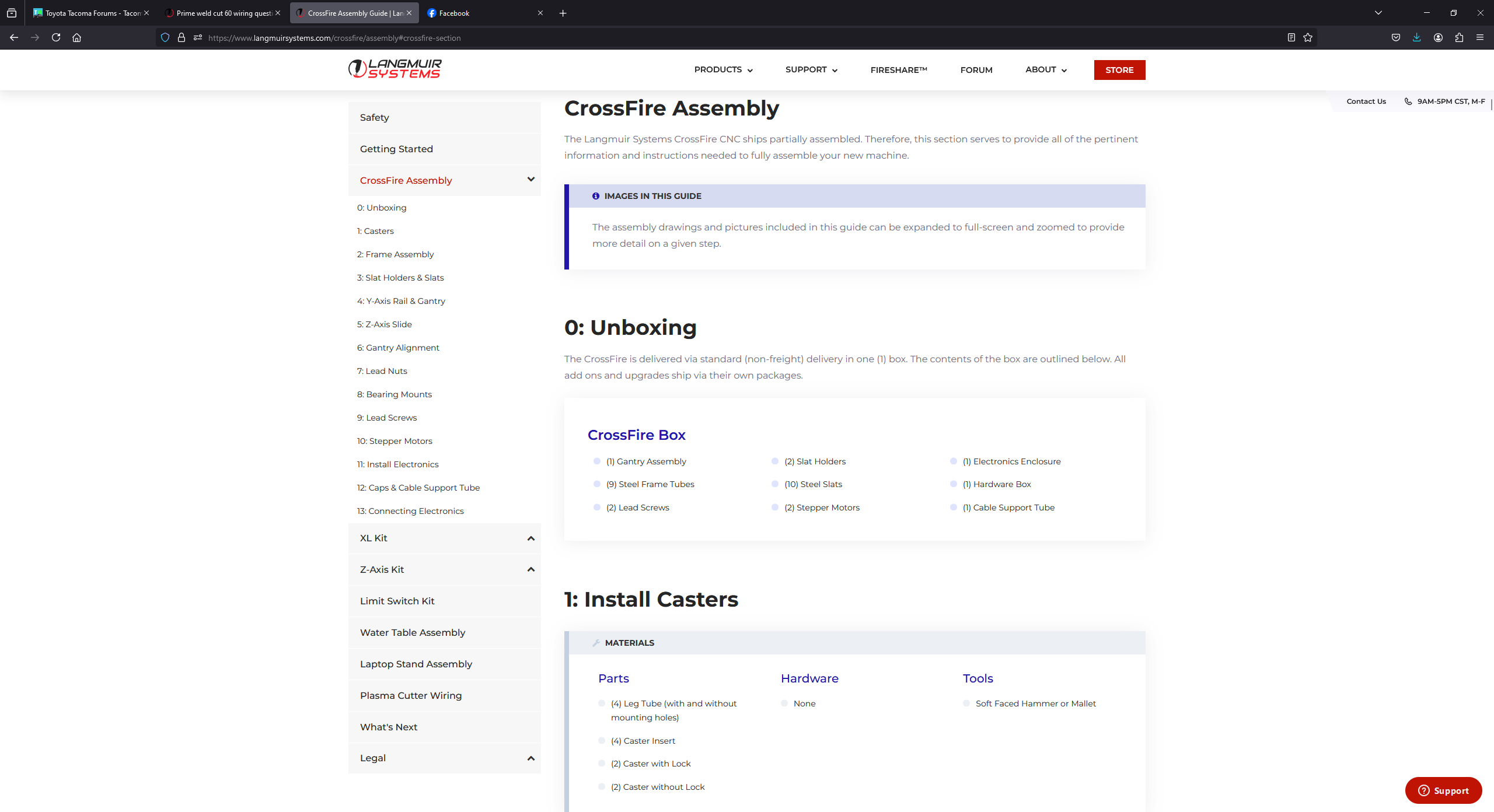

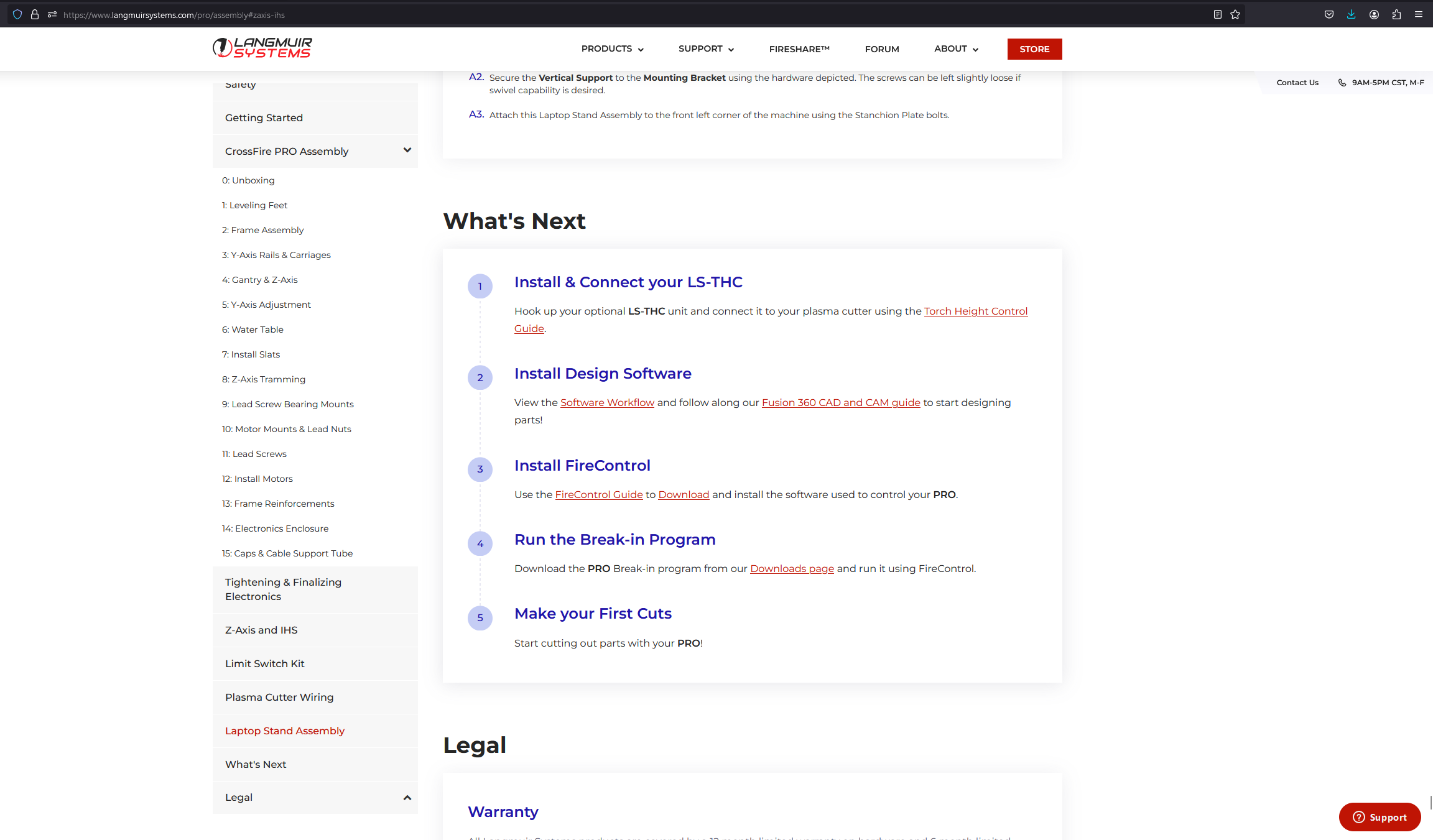

Just looked, it IS there.
Unless you skipped it?
Gives you a link and everything.
Edit: To add, the XL kit only applies to the regular Crossfire but the instruction is also located right there with it. I know because I started with a regular Crossfire with XL kit.
I don’t work for Langmuir, and have no affiliations, but yes links and steps are all included there without having to search for hidden links.
Yes, I actually saw a post of yours with the plug plugged in. I will likely do the female barrel connector inside the back of the case where you did your plug. It’ll be there with the CNC plug I’m still using for the fire control. This reminds me of an unanswered question I have. Are there blade connectors inside the Cut60 case for the fire control so I can skip the CNC plug for fire control?
I just saw the answer to my question. It is possible to tap into the trigger switch wires inside the case to fire the torch without using the CNC plug pins. I guess I have to decide which method I prefer.

I was assembling the CrossFire table, not the CrossFire Pro. There is no link in the CrossFire instructions to THC. It never occurred to me to check the CrossFire Pro instructions, so I’m happy for those fortunate folks!
Oof sorry I thought I was in a Crossfire Pro section :rofl:
My fault for assuming.

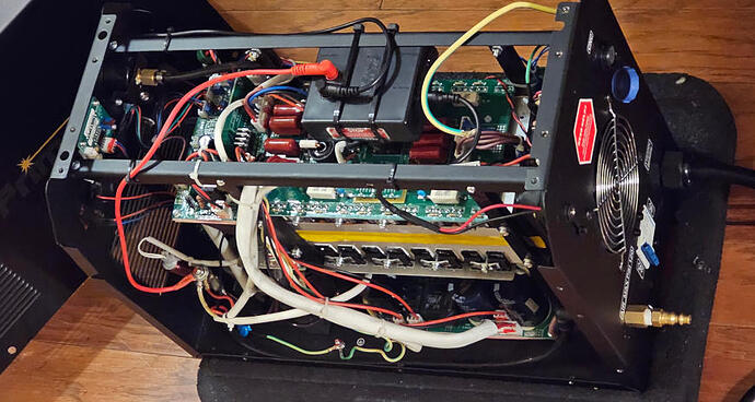

The effects of divided voltage from a CUT60.
This is what happened in my own VIM.

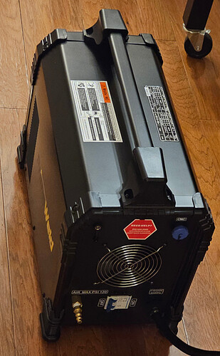

Wow! Makes me glad I did the raw voltage. My brother is using the divided voltage with his CF-Pro table with no problems for him so far. Here’s my installation. The PV out goes to a female barrel plug with a dust cap at the back. The VIM box is mounted inside the case which I like. I’ll be testing this weekend. Thanks for your assistance (and everyone else too)!
20250102_211445
Clean looking setup!
Looks great. Lets see how it works. Having it outside the cutter gives it a Fariday shielding of sorts. It may not be bothered at all.
This will be the test. It is a great installation.
I am John. I have been using divided voltage for about a year now and up until the day I have had no issues. Now I am getting, no voltage is being found when I do the THC Test. I started a cut today and it kicked out saying no voltage detected. It seems I lost voltage from the CNC plug so tomorrow I will like others and have been wanting to do anyway to switch to Raw voltage inside unit. My question is, I hope it hasn’t done any damage to the control unit like you show in the photo. I have noticed lately that on cuts sometimes the torch Z axis will rise due to warped plate but then it seems to stay up and won’t go back down after the hump and continues to cut at a not desirable height. I am hoping going Raw voltage might correct this problem. My voltage from cnc port did seem to be eractic and I am using th Primeweld Cut 60. Thanks for any help you can on this. I just been using the torch today with the THC turned off with no issues.
the damage Kwikfab shows is from the divided circuit in the VIM box. you should be able to use the RAW side of the VIM box since its on it’s own separate circuit.
Remember to use the PV output once you switch over.
Just like @nicaDd stated, the circuits are separate.
I continued to use the same VIM on my machine and set aside the replacement Langmuir sent as a back up.
Never had an issue with raw and I still have it now “just in case”.

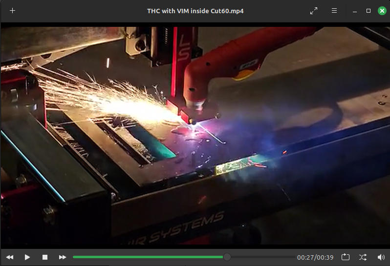

Here are the results of putting the VIM inside the Cut60.
THC seems to work fine. This was my first time using the Crossfire table. I didn’t think to record the first bracket I cut, but I did record the second one.
I realized I should turn down the air a little, use less water, less clearance height on rapids, and cut my pieces perpendicular to the slats. Lots learned and I’m very happy with the results! Thank you everybody for your insistence on using the raw voltage with THC.
The blue water is borax and food coloring. I like the look. The table cleaned up just fine afterwards with nothing trying to rust and my borax water is in two buckets with lids for next time. I did caulk the inside corners of my water table with silicone after cleaning because three of them leaked slightly.
The video is small resolution inside the zip file to fit under the 8 mb post limit. Here is the video:
THC with VIM inside Cut60.mp4.zip (6.2 MB)

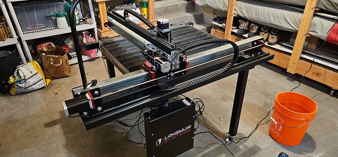

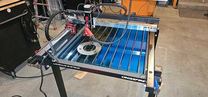

I cut four brackets so I can manage my CrossFire cables with X and Y drag chains. I’ll post pictures when that’s assembled.
Here are my drag chain upgrade photos. I had to lengthen the Z axis torch height wires and the Y axis serial cable. It all works great.

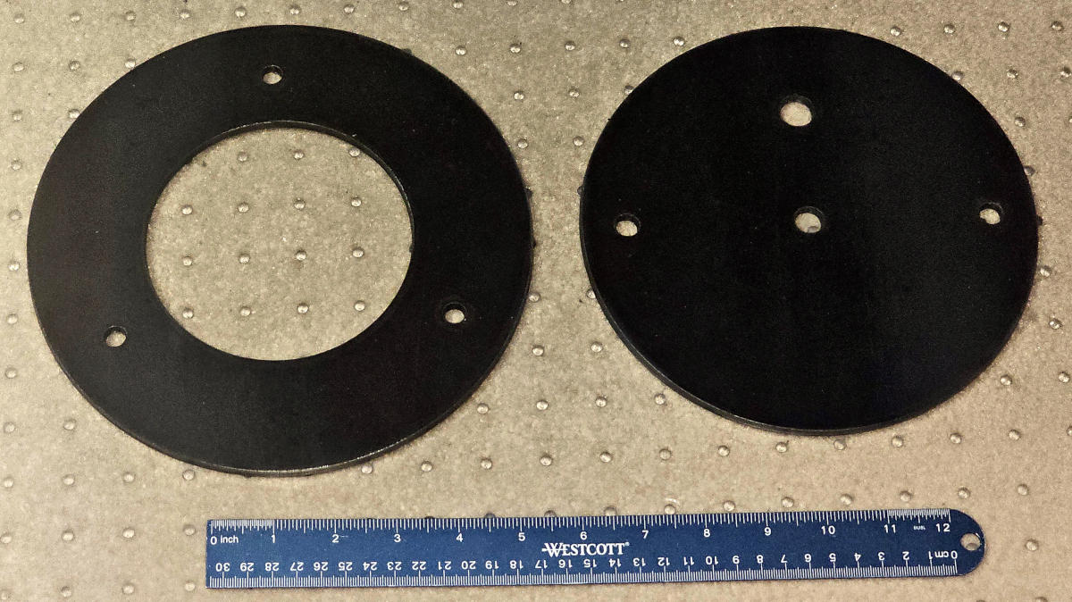

I used FreeCad Sketcher workbench and then SheetCam for the left disk. I then used FreeCad Draft workbench (much simpler) and then SheetCam for the right disk. The PrimeWeld Cut60 cutting speed reference table in the instruction manual was right on. I got great cuts! These are 3/16 inch plates for a telescope stand.
I also discovered the warning about using more than 45 amps with the water table was not a joke. I could see the outline of the two disks on the bottom (using 60 amps) after emptying the water. 99 percent of the outline wiped away, but not all. I need to get a square plate to cover the bottom of the water pan between the slat holders to take the extra juice when cutting above 45 amps.
The water table does a great job of keeping the air clean so I can keep the garage door closed longer in the winter time. But I’m wondering if anyone has stopped using water to avoid the time it takes to clean the water pan afterwards and how that’s working out cutting in a garage?
It’s not a good idea to have no water in the pan. Additionally, please ensure the work clamp is securely attached to the metal you are cutting. I’m not sure if you have parked it on the pan. Just a heads up! Great job on the drag chains as well.
You’re definitely correct, but I think he means he had water while cutting, then emptied. However, if the 2nd pic is the amount he had during cutting, to me it looks too low.
Thank you both for responding. I mean using no water without the water pan attached so the sparks and slag (and dust) go down to the floor maybe on a welding blanket for easy cleanup and floor protection. I’m wondering if too much dust gets put into the air without using water (and without the water pan, just the slats).
Yes the water was closer to 1 inch below the workpiece instead of the 3/4 inch recommended by someone at Langmuir (read in somebody’s post somewhere). I wanted to try with less water to avoid more splashing. I’m sure I would have had less of a mark on the bottom with water 3/4 inch below workpiece instead of 9/10 inch when cutting at 60 amps.
I understand allowing the metal to cool slower yields stronger metal (not as brittle), so I wanted water further from the metal but also I wanted it to trap dust from the cutting process. It worked great, less splashing, no perceivable dust in the air unless the steam in the air afterwards contained dust.
