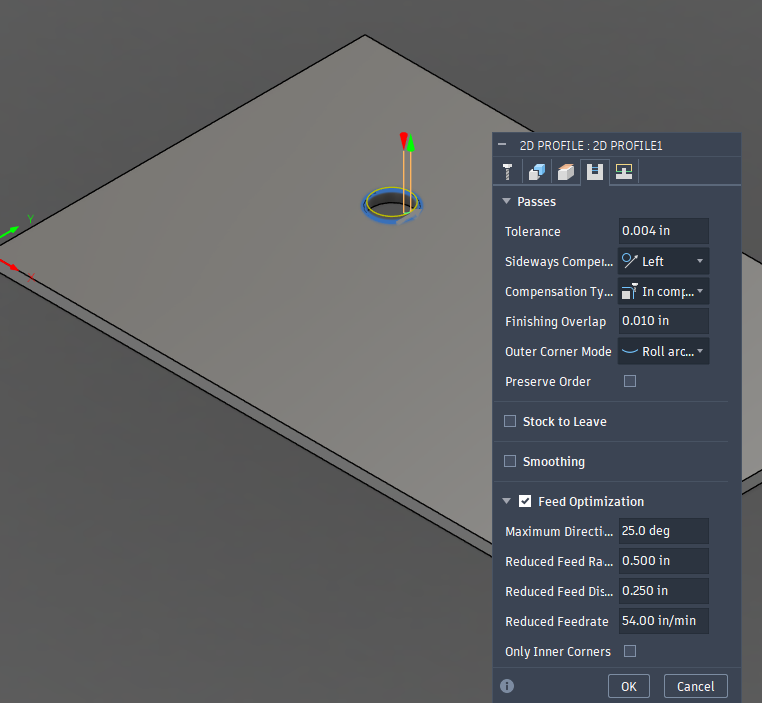

Son of a chicken biscuit, feed optimization was the issue. I also didn’t check smoothing.
So for reference, anyone who gets a “validation error, no program speed found” I would check this if using fusion

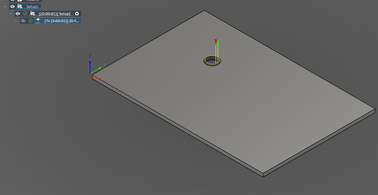

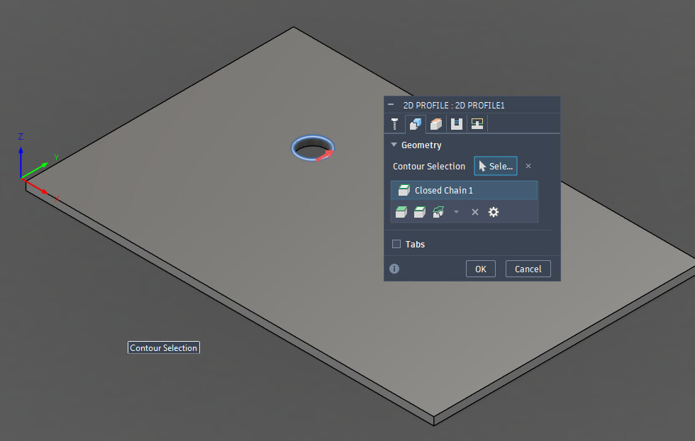

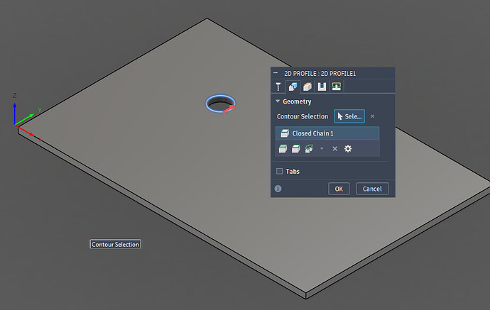

Another simple example is to just cut a single hole where “feed optimization” kicks in. In this example there is never a blue cut path (normal cut speed) as I only pick the hole for the contour selection and I turn on feed optimization. The entire cut is yellow.

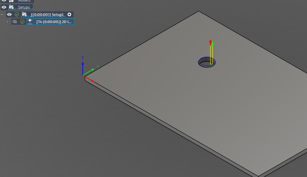

If I turned off the feed optimization, then the path turns blue and the cut speed is realized. No error will occur:

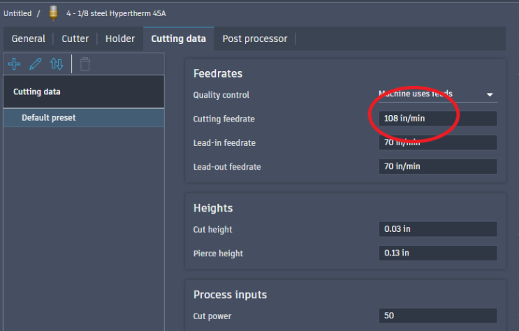

Cut speed of my tool, was satisfied:
