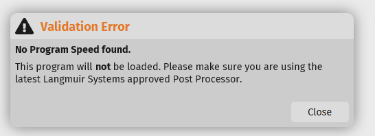

Post processing error all of a sudden - Feed Rate Optimization Results in Cut Speed of Zero

Zachary, thank you for taking the time. I did a quick test and it did not work for me but I did not test it on the actual enclosure. (Note: I am using a Langmuir Forum member’s FireControl program mod.)

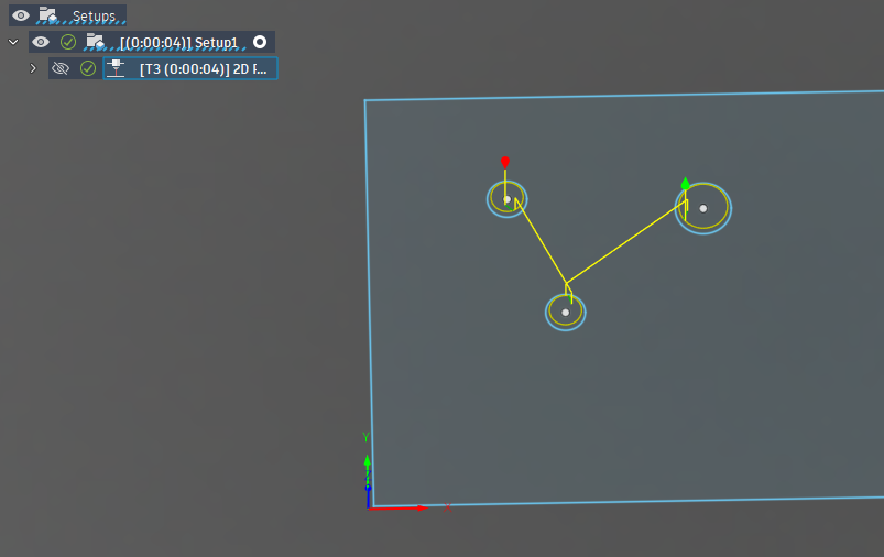

I may have done something wrong but this is the design I cut. The largest hole is 0.48 inches. The cut path is yellow so it is slowing down for these cuts:

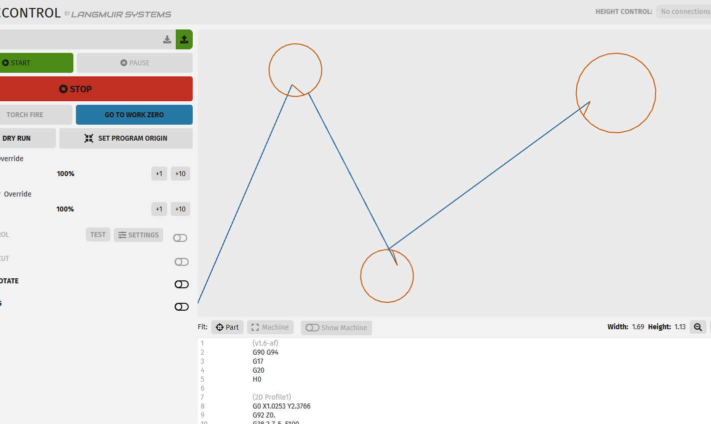

I processed this first with the Post Processor v1.6 and my mock-up on my desktop showed the expected error and he does have the expected final notation of “(PS0)”
No surprise there.

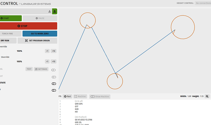

Now, I used the 1.7 Post processor and the gcode shows the same thing “(PS0)” at the end of the code file.
The mock-up is still showing the same error.

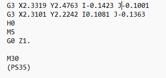

Here are the last few lines of my test file:
And it loaded into FireControl just fine:
