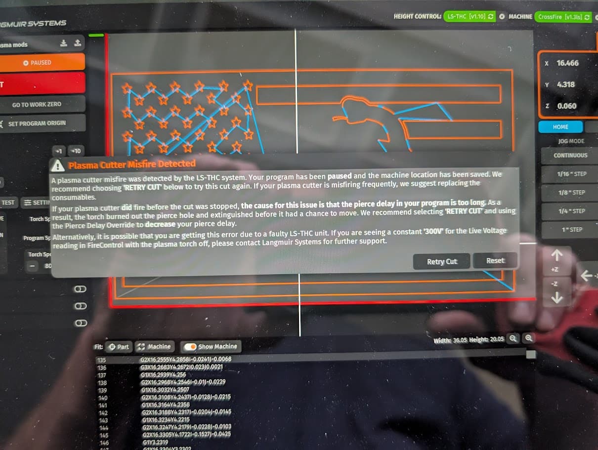

I’m writing to report a frustrating issue I’ve been experiencing since purchasing my Langmuir system over a year ago. While I’m generally happy with the machine’s capabilities, I’ve consistently had misfire problems that significantly increase my cutting time.
I have read all the other topics that are similar and troubleshooting steps that are recommended to no avail. I am really trying to figure out is this a Langmuir issue a bad THC module, a Everlast issue or and PEBCAK issue.
Specifically:
  • My current setup is a Langmuir Crossfire Pro with an Everlast 52i plasma cutter.
  • I’m using raw voltage for arc voltage control.
  • The misfires occur across all cutting settings, regardless of material thickness (16 gauge to 10 gauge).

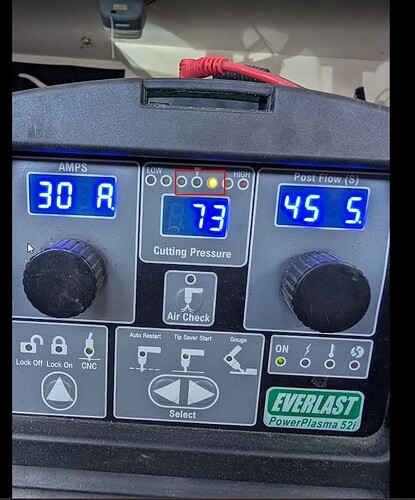

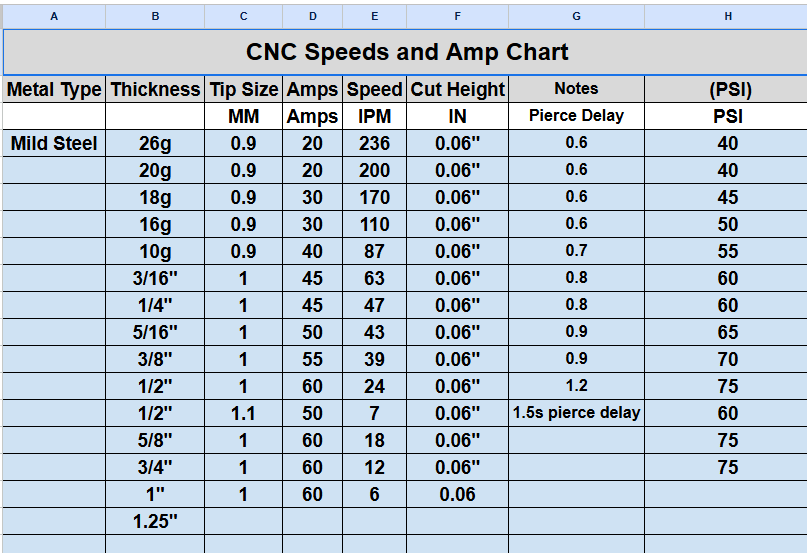

  • I’ve attempted to follow recommended settings from the forum (e.g., the chart), but I maintain a consistent 75 PSI air pressure to the machine due to its sensitivity.
The misfires are frequent, adding considerable time to my cuts (e.g., a 10-minute cut becomes 20 minutes). This is a significant problem for my side business, as it reduces my efficiency.

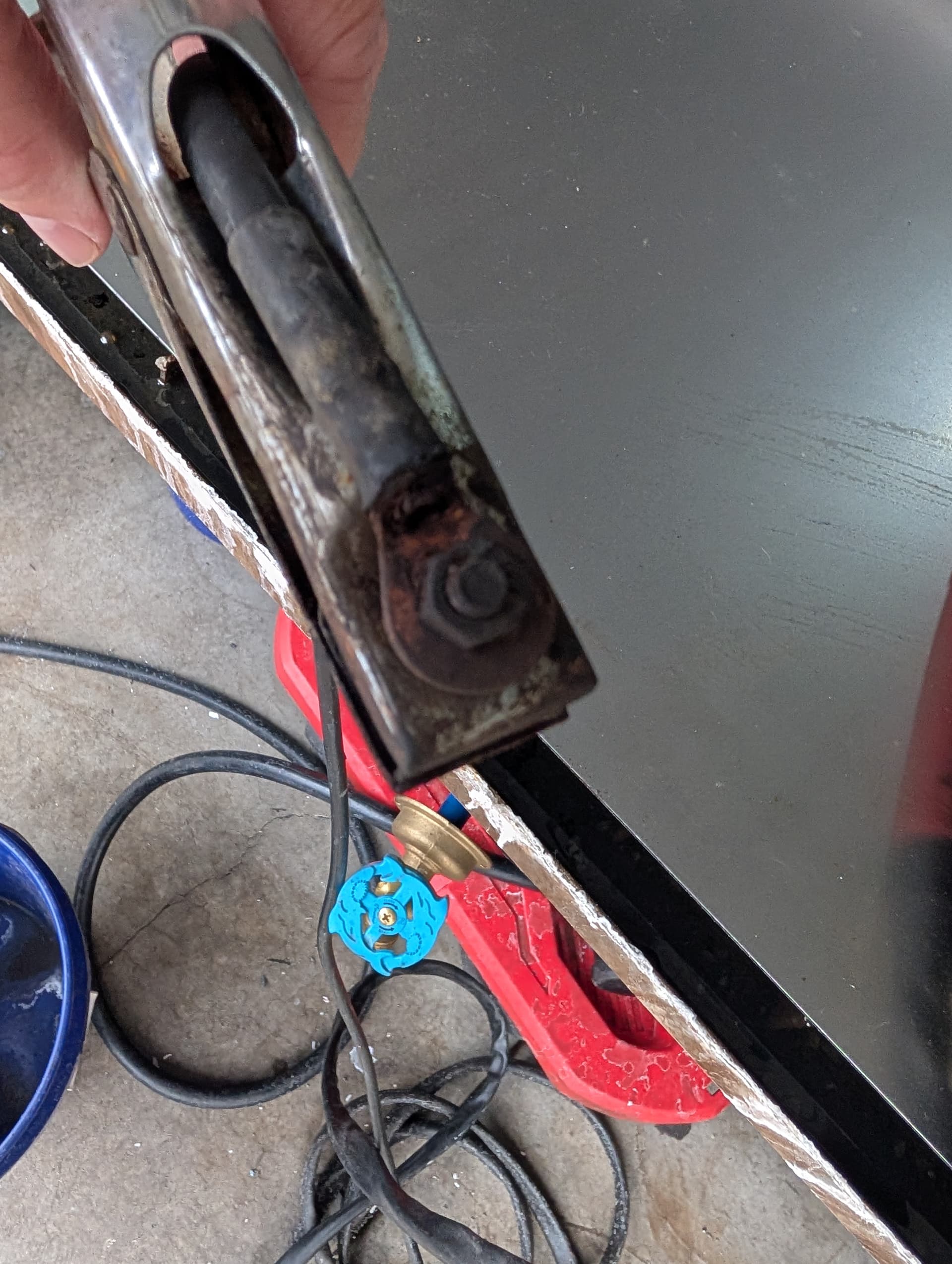

  • Ensuring a solid connection of the positive cable to the metal.
  • Cleaning rust off the positive cable connection.

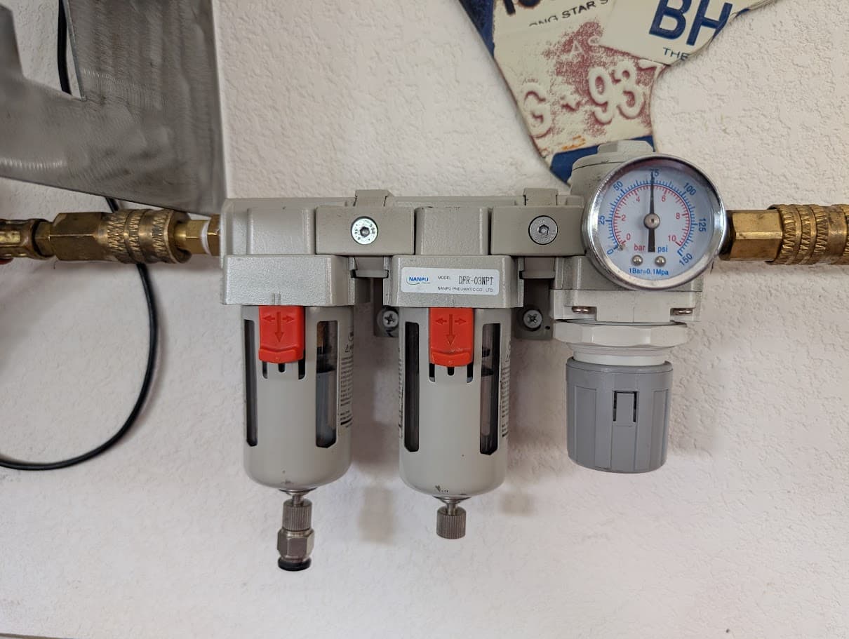

  • I live in Las Vegas, My air is dry as it can be even if the compressor runs alot, I have a inline regulator with 2 stage dryer and then one on the back of the plasma cutter. I never see any moisture in these traps.

Update: I did check my compressor and emptied it out and there was some moisture at the bottom but nothing made it to the traps

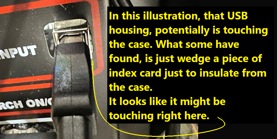

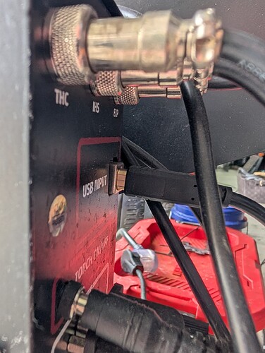

It probably not the Everlast. I would do the ground loop test. Use a multimeter on Ohm’s
One on the chassis and the other lead on the printer style usb shielding.
It should be open or have no connection.
I would also consider this ground loop ( bulletproof) device to power your USB port.
I don’t think your issue is related to moisture but you might consider having an auto-drain on your tank. If the auto drain opens regularly, there is seldom more than a small amount of moisture being ejected; thus, nothing is really accumulating.

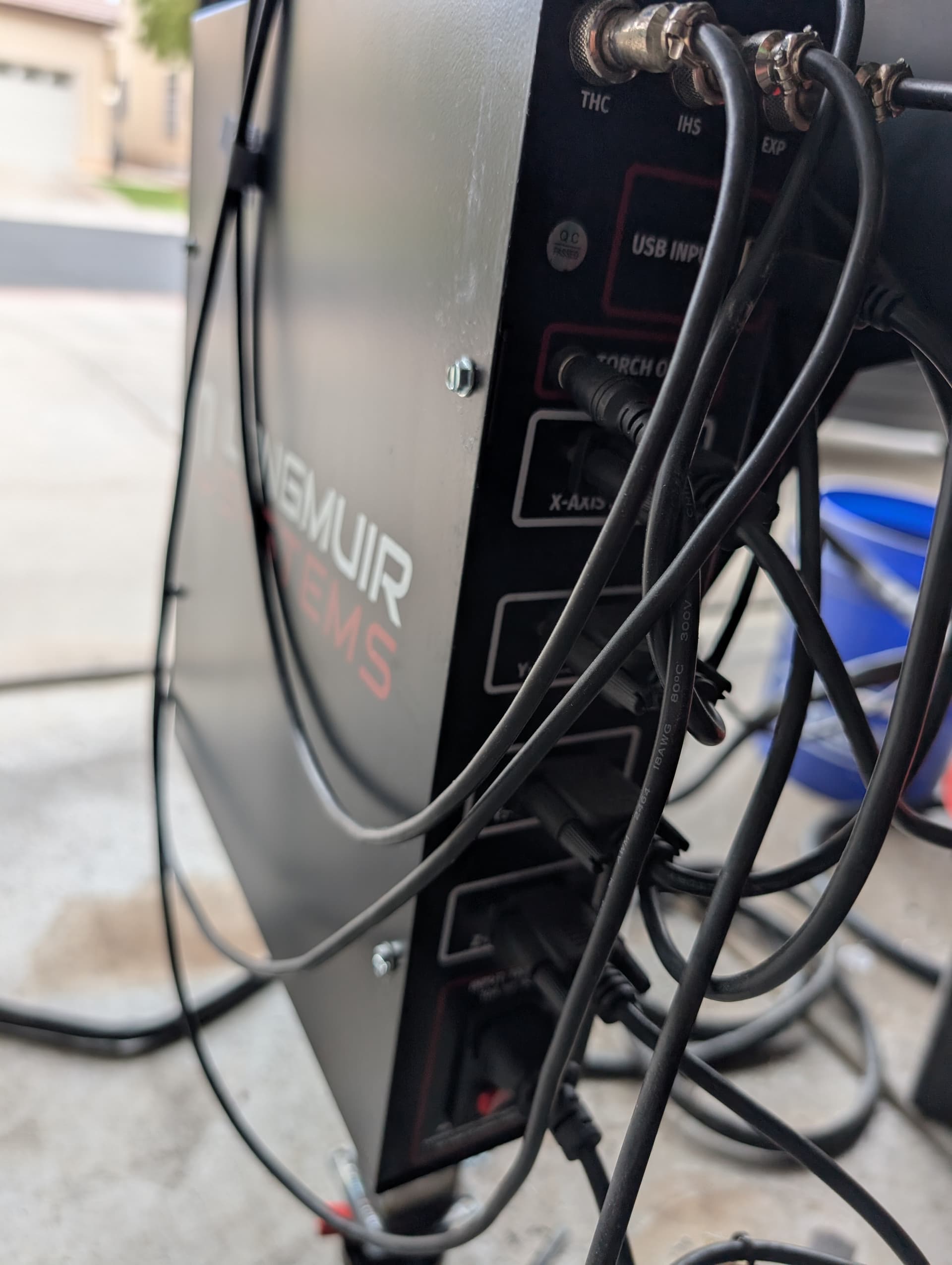

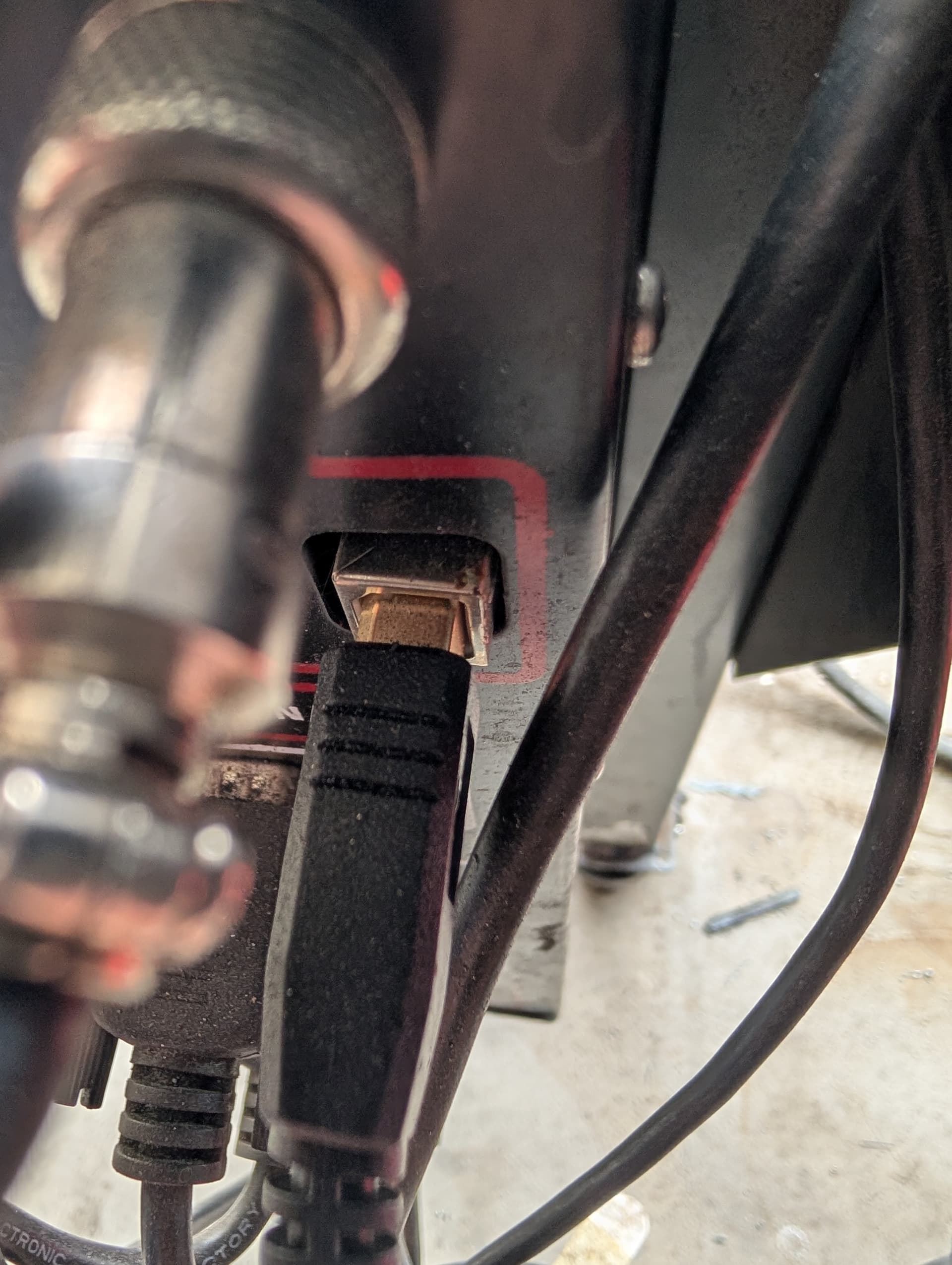

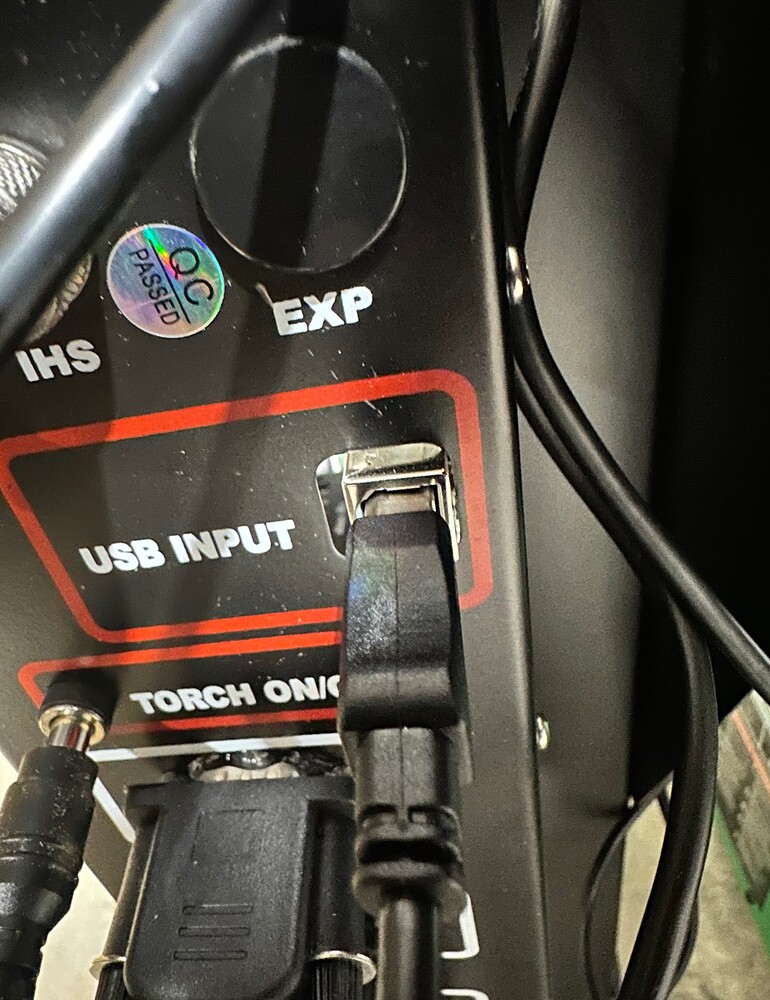

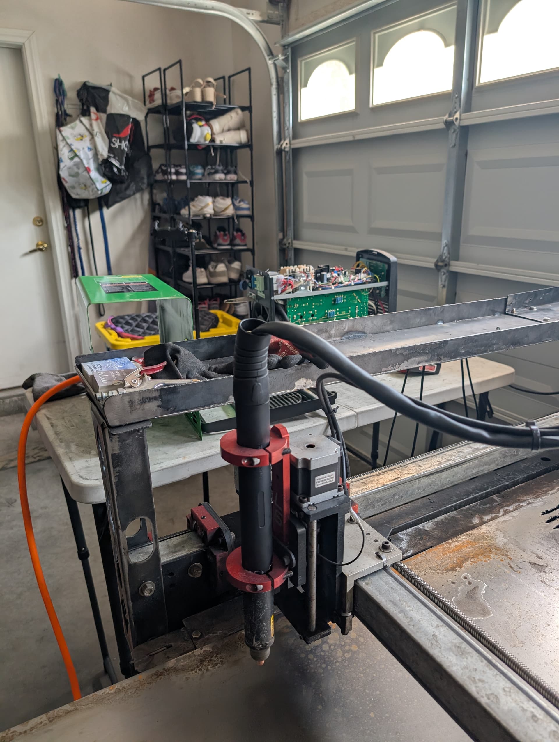

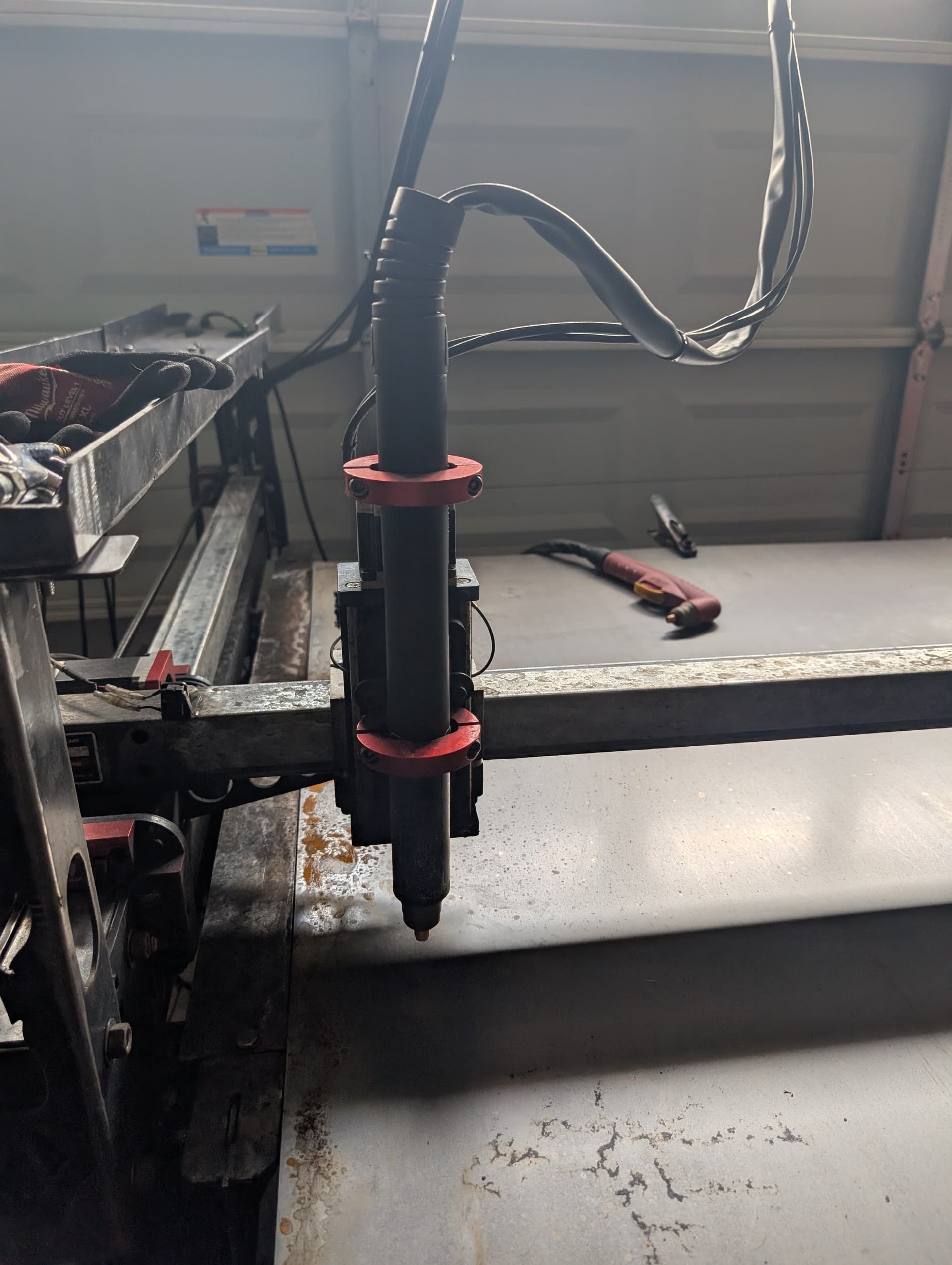

Can you take a photo of your torch mounting and another photo of the lay of the cables (torch, THC voltage from the VIM box to enclosure, work lead and the USB cable from computer to enclosure).

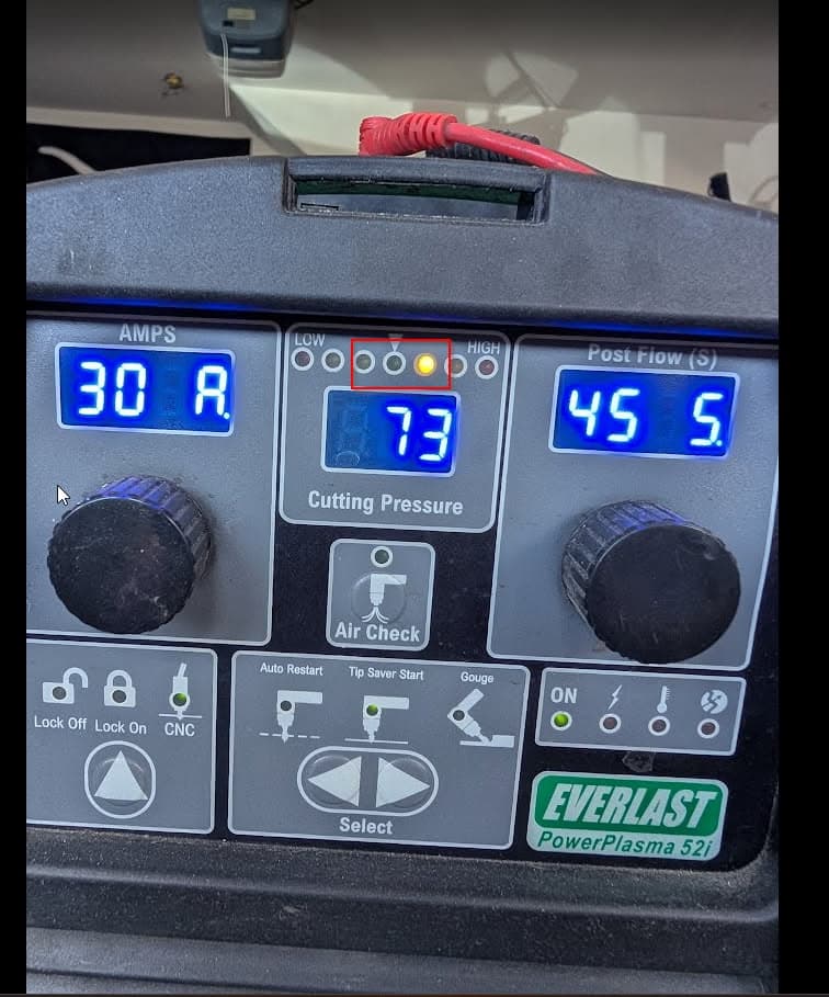

  4. I would consider moving the air pressure, supplied to the machine, up to 80-85 psi (what have you got to lose?)

Thank you for the reply, I will get those pictures and post them later today.
No. Just put the red lead on the chassis and the black lead on the outside metal shield on the printer-style USB.
Set the meter to continuity. It should be open.
Also make sure the shielding on the usb is not touching the control box enclosure.
Here is further detail illustration from BidDaddy’s photo:

Here are my pictures when I tested the continuity, there was not any. So I assume that is a good thing. I don’t see anything touching.
Here are the pictures hopefully I got all that you requested. Just want to mention again this issue is something I have had since first putting the machine together.
  1. I checked all the connections on the wires everything seemed tight. I do remember when I was first assembling the machine that Langmuir had sent some extensions for the serial connections because I guess the terminals were to short, does that sound familiar? I never put them on because they seemed at the time to connect just fine.
  2. That is a possibility that I had a bad one to begin with.
3 not sure what you mean by that. My machine is currently down and I have to replace a sensor and a solenoid. However this was happening prior to that.
  1. I am 99% sure if the machine registers pressure above 80- it will error out and not fire at all.
Auto drain on the compressor, is that a universal unit that I can buy?

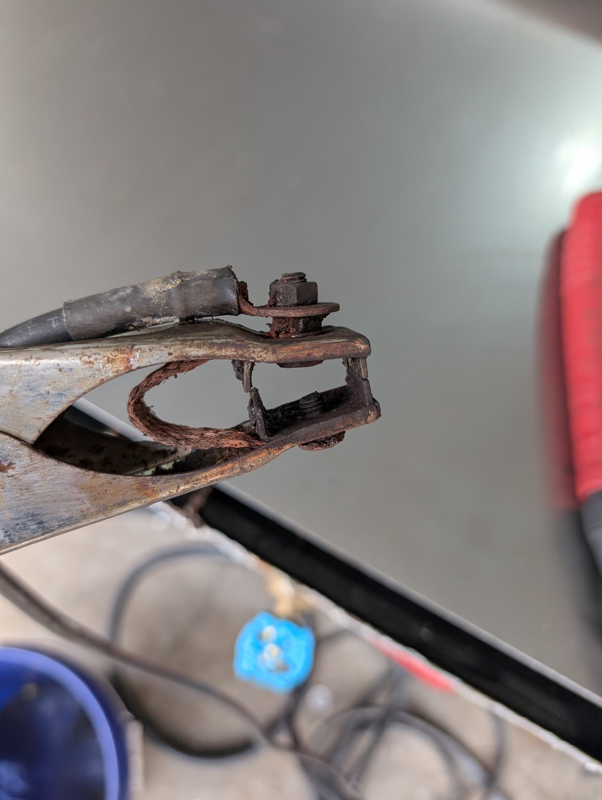

The ground cable I have cleaned recently with CLR but it seems there is some build up of rust and gunk.

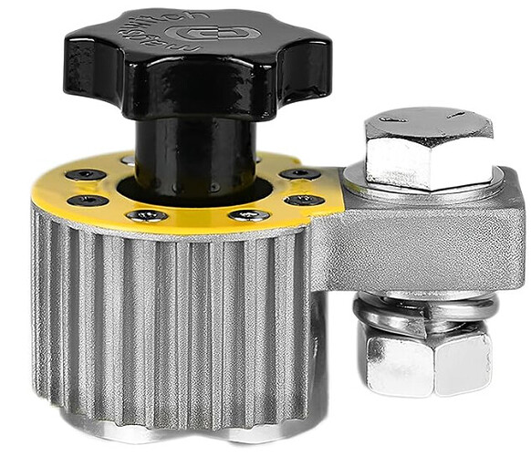

That work clamp looks fried. Get you one of these:
As stated that work clamp is toast. You need a new clamp and the end of the cable needs cut off and a new end put on it.

That might be true. I would try it and see. I am lucky that my cutter (Hypertherm) is more accommodating to higher pressures since it regulates what it needs.

And as far as your ground clamp, unless you took it apart and cleaned rust off all the wire and washers and clamp, cosmetically you might have improved the looks but that is probably the extent. Again, like the pressure, make the suggested changes to at least rule out all of the possible contributing factors. As for the work lead connection inside the plasma cutter, some have found that it looked solid but as soon as they started to loosen the nut, the entire connection crumbled.

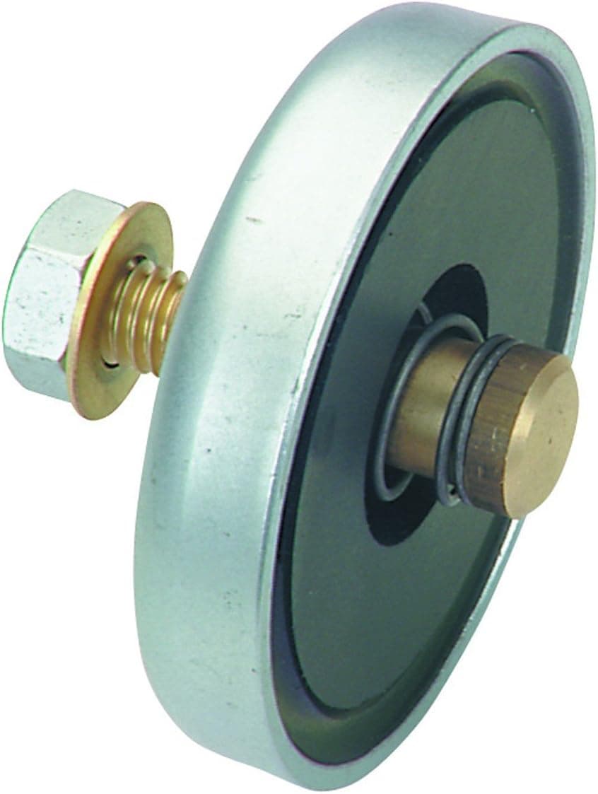

What is that and do you have a link?

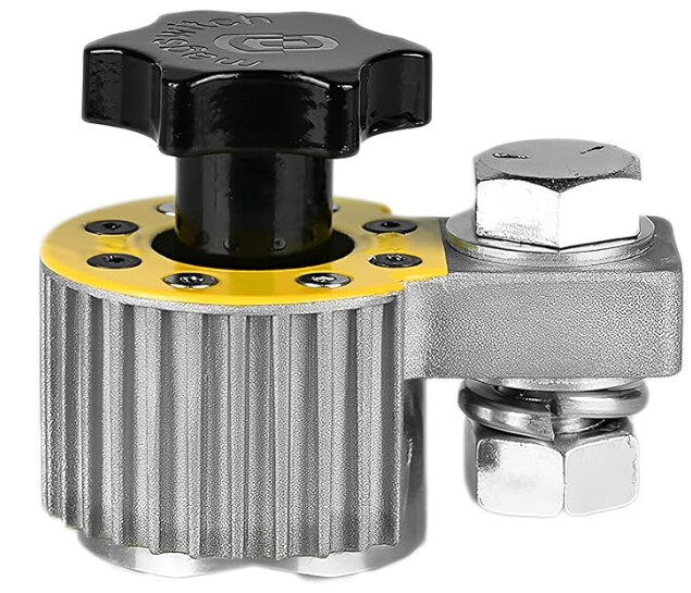

I don’t mean to butt in and answer for Bret but that is a magnetic ‘ground’ clamp for welding.
Don’t call it a ‘ground’ clamp once you put it on a plasma cutter, though!!! It becomes a “work” clamp when on a plasma cutter.
Here is another option many people use:
https://a.co/d/2vAeYK4
Another option some are doing is to have two work lead clamps with a clamp attached to the slats and the work lead wire splits off and continues to the magnetic clamp and is attached to the actual piece of metal.

Do you guys prefer these magnetic clamps vs the regular? Pros/Cons
Magnetic won’t work on Aluminum or some Stainless Steels…
I use my spring clamp 95% of the time. There are times that I use that mag/clamp when the piece of metal is too close to the edge of the water bed and the spring clamp would cause the metal to be levered up. Or the lower part of the gantry/torch mount might hit the clamp. In those cases, I attach the mag clamp and then clamp my spring clamp to the mag/clamp.
