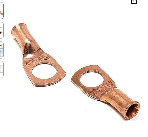

You would just do a piggy back cable. The primary wire goes from the cutter to the spring clamp cable connector stud. A second cable attaches to that same “spring clamp cable connector stud” and continues to your mag clamp stud.
You use this sort of compression cable connectors on the ends of the cable:

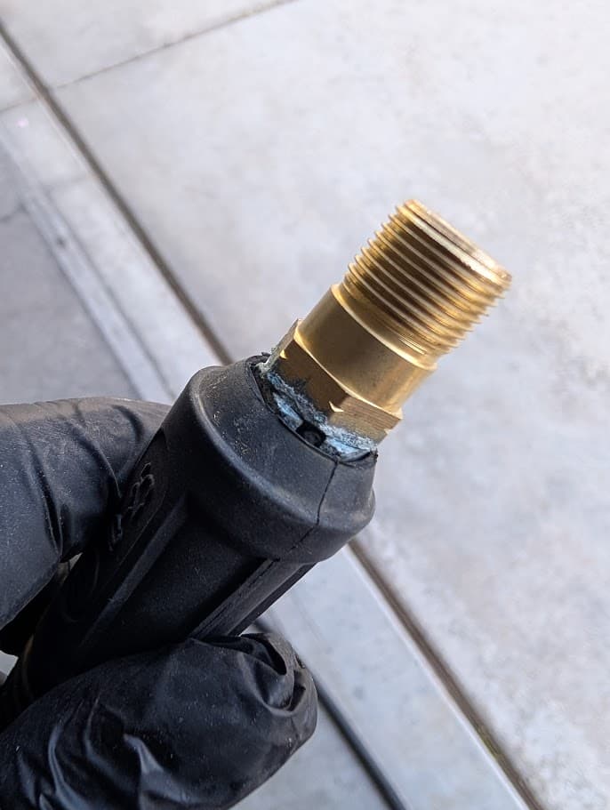

I took off the work ground from the machine, this is what it look like and I dont think it should look like that, as stated above I have another one coming.
Did you take it apart from inside the plasma cutter? That connection is a bayonet-type connector. Twist it. It’s hard to tell from the picture. That is the positive work cable. That bad connection may very well be your issue.
Yes, I had to take it off from the inside of the machine as I was not able to disconnect it the regular way by twisting it. The hard rubber coating on the outside would turn but it would not disconnect
Damn that thing is corroded together. I would say that was a lot of your trouble. You will have to replace the plasma cutter end also.

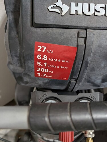

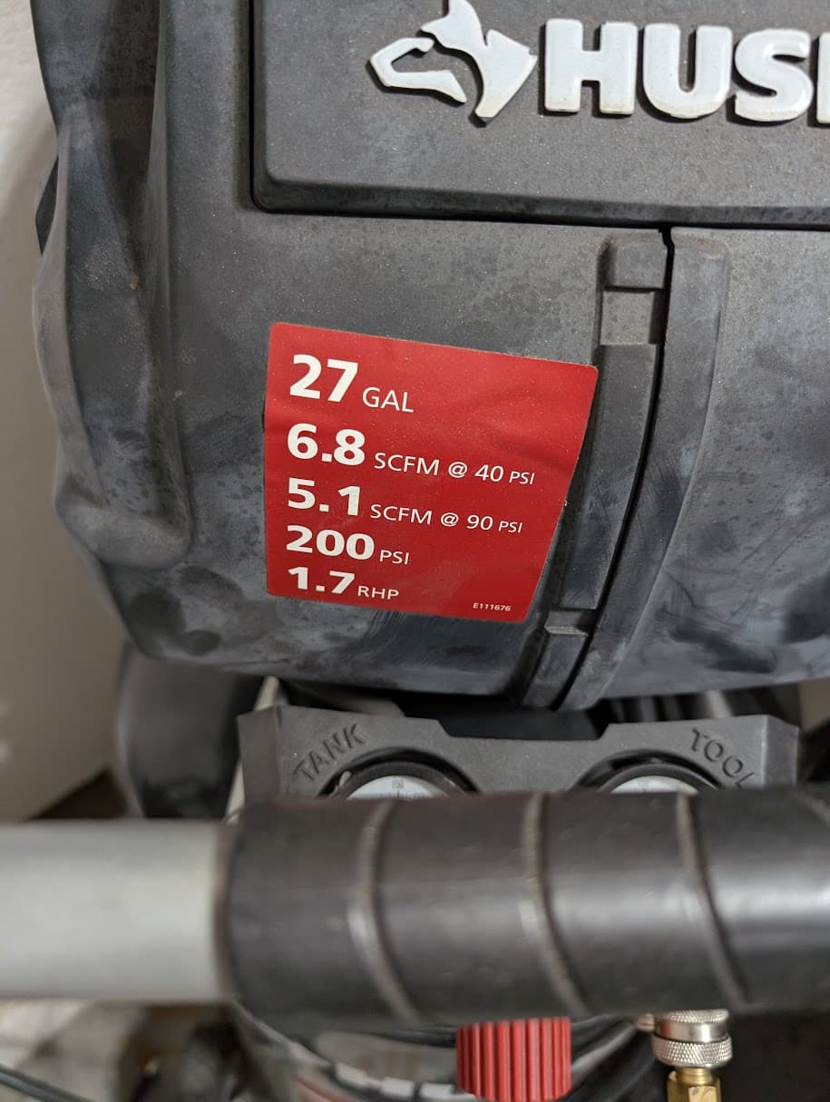

I’m running a husky 27 gallon 200 PSI. Pictured below. I have the NPT Air Drying System - Double Air Filters, Air Pressure Regulator Combo with also the air dryer on the back of the Plasma cutter. Not sure what the difference is with a desiccant moisture trap and the one I have.

None of those things is drying your air. They may catch some condensation as the air cools, but there is much more water vapor still in the air that is getting to your plasma cutter.
Add a 1 quart sized desiccant dryer and a motorguard filter for much improved consumable life. You’ll be surprised how quickly those blue beads turn pink from absorbing the moisture in the air.
That may not fix your problem, since I think you have a solenoid problem, but it may have contributed to the sticking solenoid.
Hopefully you have some small projects because under normal circumstances that compressor will be running 100% duty cycle damn near to keep up.
And because it’s always running at 100 it’s going to run hot and because it’s going to run hot it’s going to sponge up and hold on to moisture in air longer.
That compressor is not an ideal pairing for plasma cutting. Unless you’re really just doing tiny art projects once in awhile.
