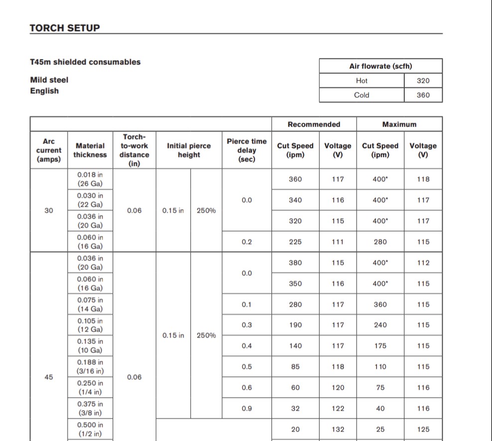

Now that Jasic has released their own line of CNC tables, can Langmuir, who specifically recommend the Razorcut 45 request the data from Jasic to be used here?

Thanks for that feedback. It seems here the Jasic team are offering the SC80 torch in machine configuration, using the same consumables as the SC80 hand torch which is rated max 80A and seems to ship with the 45A models. So thought it might be good to get a ball park set of “feeds and speeds”, as the original cut charts were pretty light on.
Yes I have seen that torch offered being used on the Razorweld 45 also. Think of it this way the smallest cutting tip I offer for that torch is 0.9mm/40 amps and that is a shielded tip. The 1.0mm/50 amp tip is the smallest for none shielded. Those would both work. So unless you can get some Chinese copy smaller tips you can forget doing fine detail work.
Hi mechanic416, yes you re correct the 0.9@40 maxA 1.0@ max50A and 1.3@ max65A are the main consumables.

The earlier brackets that were shown was cut from 8mm plate. In looking at the original skimpy material the Jasic guys suggest pierce at 4.5mm, cut at 3.0mm wound up to full 45A, no pierce times (or limited) and no lower amp options.
So was just hoping someone may have access to the data because introducing a table with you machine requires a bit more research I would humbly suggest.

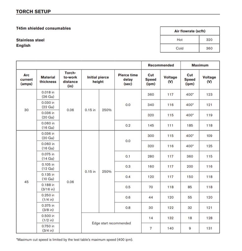

Hey FSFab, noticed the bottom is missing on the carbon steel page, would you be kind enough to re-post or if easier do you have a link to it?
That is what was sent to me as is from the troubleshooting guy at Jasic. I assume that Jasic sent it that way because that is all that is recommended to cut with the Razorcut 45. The rest of the charts are probably for a larger amperage machine.
Here is the chart that the entire Langmuir forum has been using for years. We are killing a dead horse.
I see what your are saying. The other two have .75 thickness at the bottom and that one should probably have it too but it is cut off. That is what I received in my email though I do not have a link and the original image I have is cropped that way unfortunately.
I respectfully disagree. There is a little more information on these charts from Jasic and I was having problems with my arc going out after the pierce with the settings shown on your chart. This chart may help people that are experiencing the same problems I was having. I do have to test more metal thicknesses though. I was cutting 3/16”.
