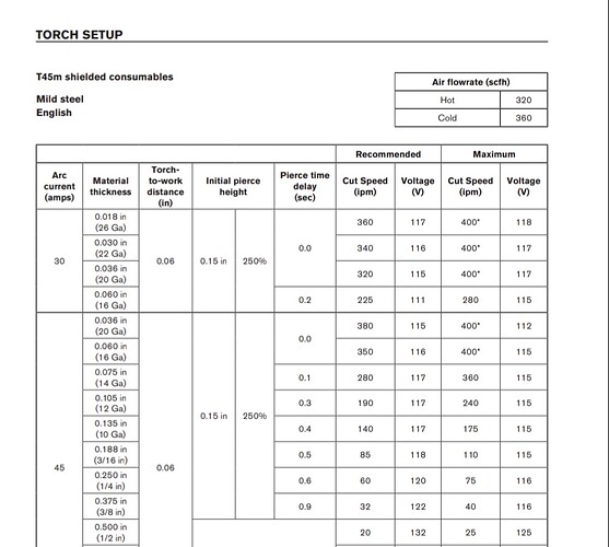

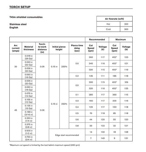

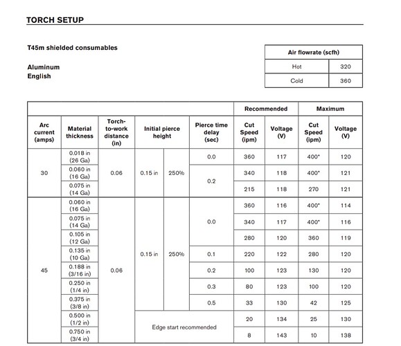

Razorcut 45A cut chart from Jasic
These are official cut charts that I received from Jasic when I was taking to them trying to trouble shoot the problems with my XR and my Razorcut 45A with a machine torch.
Thanks for sharing! Have you tested these parameters?
Those specs look very close to hypertherm spec.
Yes, for the 3/16 settings. I was actually having issues with piercing then my torch going out and then if I re-ran the program it would pierce through the already pierced hole and actually finish the cut. I ran with the updated numbers and it cut the test piece I drew up from start to finish entirely 3 times without an issue. Cutting on 3/16 mild steel.
