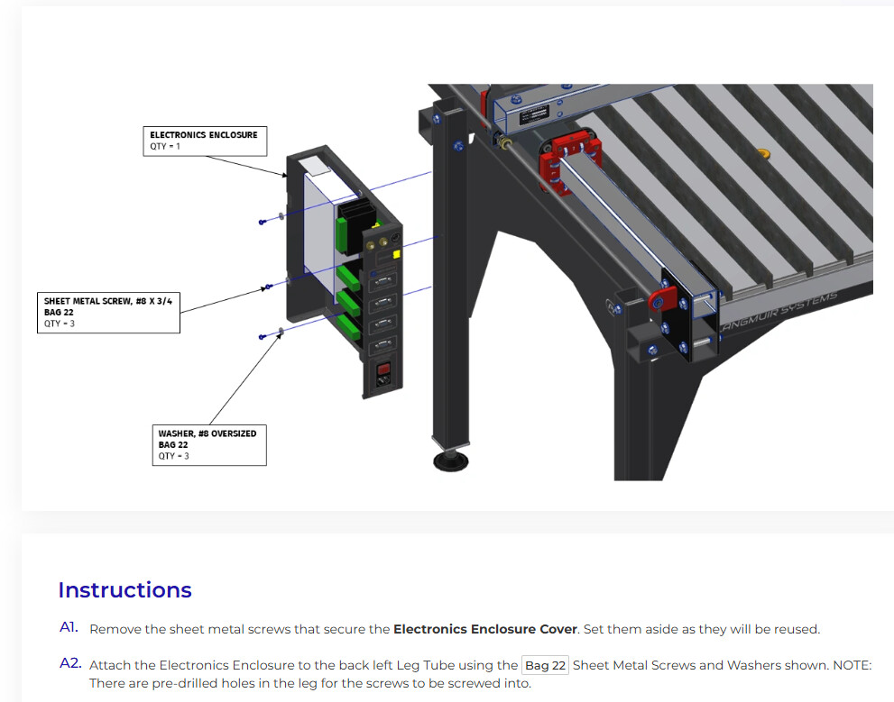

I am not sure how much it matters, but according to the directions, you have the control box mounted on the wrong leg.
I strongly encourage you to follow the directions in the assembly guide. The water pans and the leg gussets should be installed before the control box. Definitely that stuff should be on before you start jogging the machine around.
You will save yourself allot of headache if you follow the directions. Lots of folks trying to help are likely operating under the assumption that you have been following the assembly guide.
Edit: I guess it’s been too long since I have been on here… I had forgotten you had bought this second hand. I just read back through… I am not sure how much had been put together before you got it… but it doesn’t appear whoever had the table first followed the directions at all. It is always harder to figure something out when someone else has put it together having not followed the directions. I don’t envy you, but I would take it apart as far as you need to reassemble it following the directions.
72 pony why do you say the control is on the wrong leg , it is on the leg closest the motor ?
In your picture above it appears that your control box is mounted to the back right leg. The snip above is taken from the assembly guide. As you can see the directions call for it to be mounted on the back left leg.
Your motor is also mounted on the wrong side… Like I said I would take it down as far as you need to in order to follow the directions completely.
72 pony I get it , I will start over again I think I may have gotten the right and left tube mixed up.

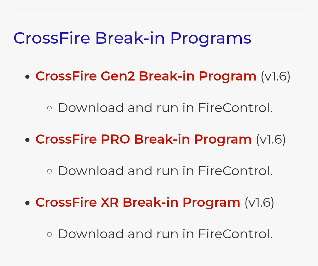

In the video are you running the break-in program for the pro or are you running the break-in program for the gen2? Seems to be traveling a little short.
You need to have an account to watch on Facebook
I think you are right Gen 2 . I will try another just happy to get it moving
