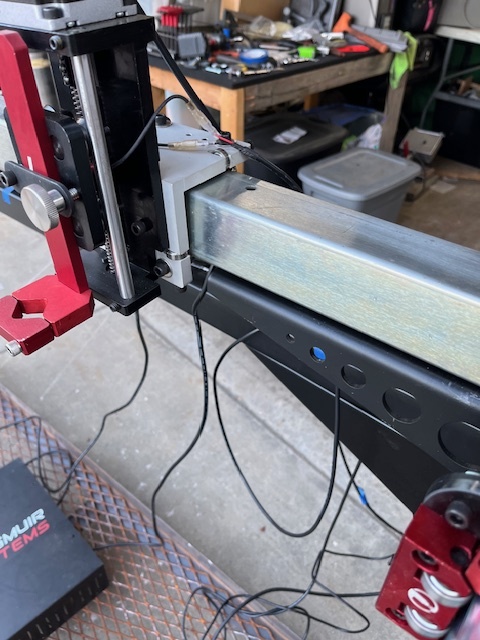

I have been unable to work on this untill today , I took it all apart and started all over I know it is square now 78.25 each way. It seems to run good in the Y direction the X direction hits the angle that holds the rail . I think i scremed up how the screw rod is mounted if I can put it on the other side I don’t think it will hit
What do you mean by this?
Loosen all the bolts that hold the X rail to the weldment and push the rail(I don’t remember if it’s forward or back)until the carriage clears. There is enough play in the bolt holes to make sure the carriage clears the weldment.

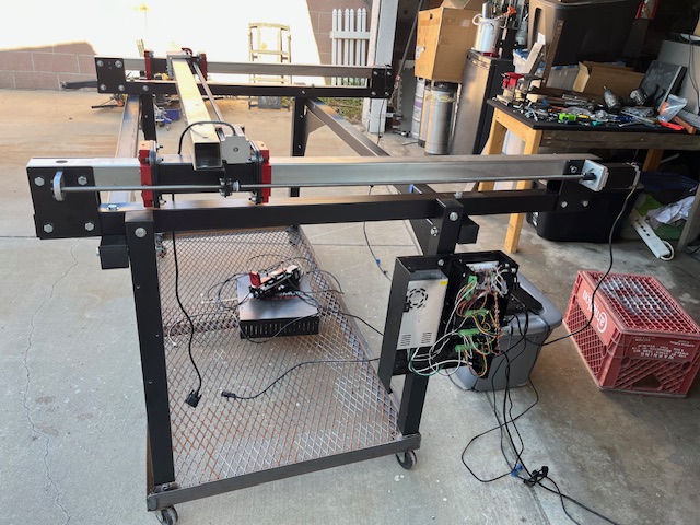

I got some help on FB site it seems I had the weldement parts on the ring side the angle was backwards . now it works better but the program shows the y access going in the worng direction .
Can we see a picture of the table? That only makes sense if you installed the motors on the wrong end.
This is what was wrong the angle needed to be the other way .

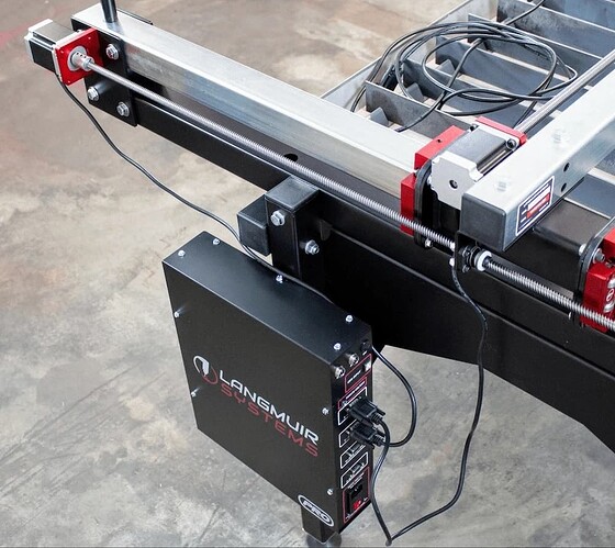

Yes, you have the carriages swapped. It hard to tell if the carriages are swaped or you have .mounted the Z axis backwards. Better pictures please.
That still doesn’t help with the Y axis going the wrong way, since we can’t see the Y axis.

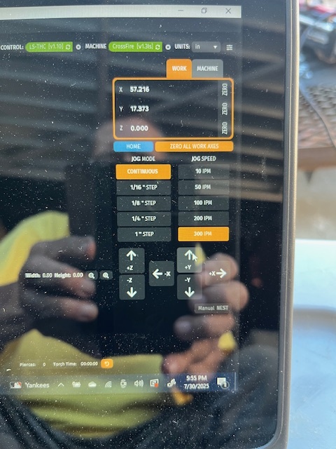

Your statement needs some clarification. Is the Y axis actually moving the wrong direction when you jog it? Meaning the torch moving toward the front of the table when the screen shows it moving toward the back. Or, Is it just showing Y+ in the direction that you think should be Y-.
yes it that picture the weldements were on the wrong side , I have fix that
I will try an explain. If I have the x rail close to me and z unit to th far left , I then try to jog the Y+ it does not go the correct way but if I press Y- it gos away from me . Is that the way it should work?
Y - is the end furthest away from the stepper motors, at the front of the machine. This assumes that your stepper motors are installed at the correct end.

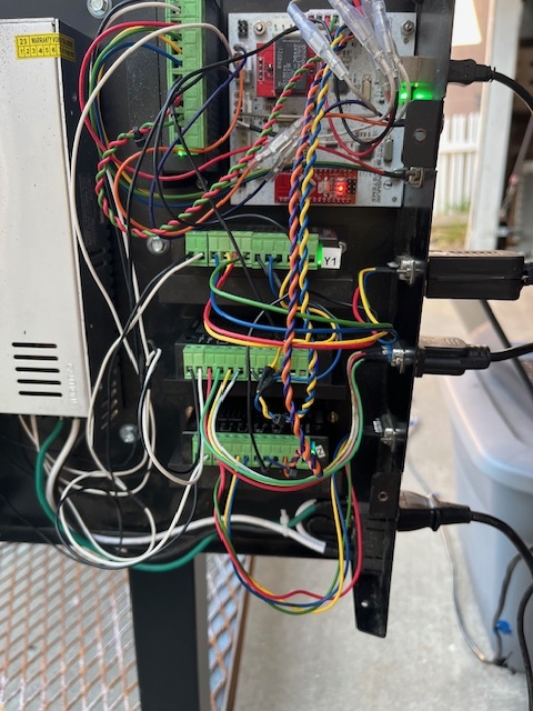

thanks ds690 . Today after going over everything again I found the answer to why the comand to jog the y rail was not working correctly. I had a wiring issue in the control panel the y1 and y2 were miss wired after changing some wires it now works as it should . Now for the other issue with the X movement it seem that when all is bolted down the y access shorts the motor controller for the Y2 side so the y1 side continues to move , not sure how to fix but getting closer. I think it has something to do with the bearings and weldiments and that beeing square.
