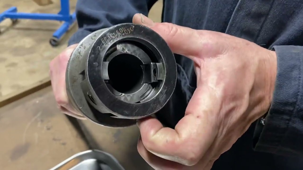

My guess is that we won’t see a factory ATC version of the MR1. Ideally it would have a higher clearance gantry (which will reduce it’s rigidity) or it would use very expensive HSK25 tool holders. HSK25 spindles cost about what the whole MR-1 costs. Proper “lights off” ATC is a lot of work to get right (requiring chip protection for the tool holders, interlocks to make sure that the tool change was successful, etc), but quick changing tool holders would really transform the stock machine.
For instance one of the first CNC machines that I worked with was a Bridgeport Boss that I upgraded the controller on, and it used this style of quick change tooling:
This isn’t designed for full ATC, but it’s a lot faster than dealing with ER20 collets.
