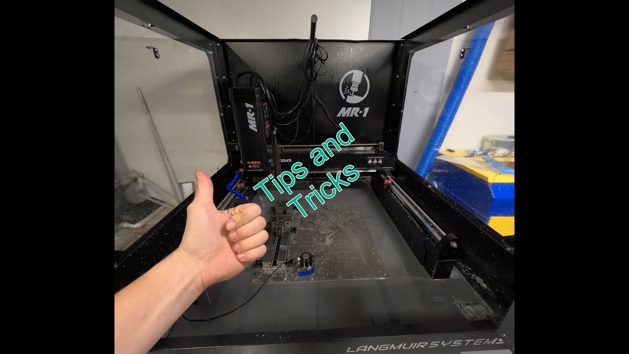

I made a video about what I have done so far with the MR-1.
