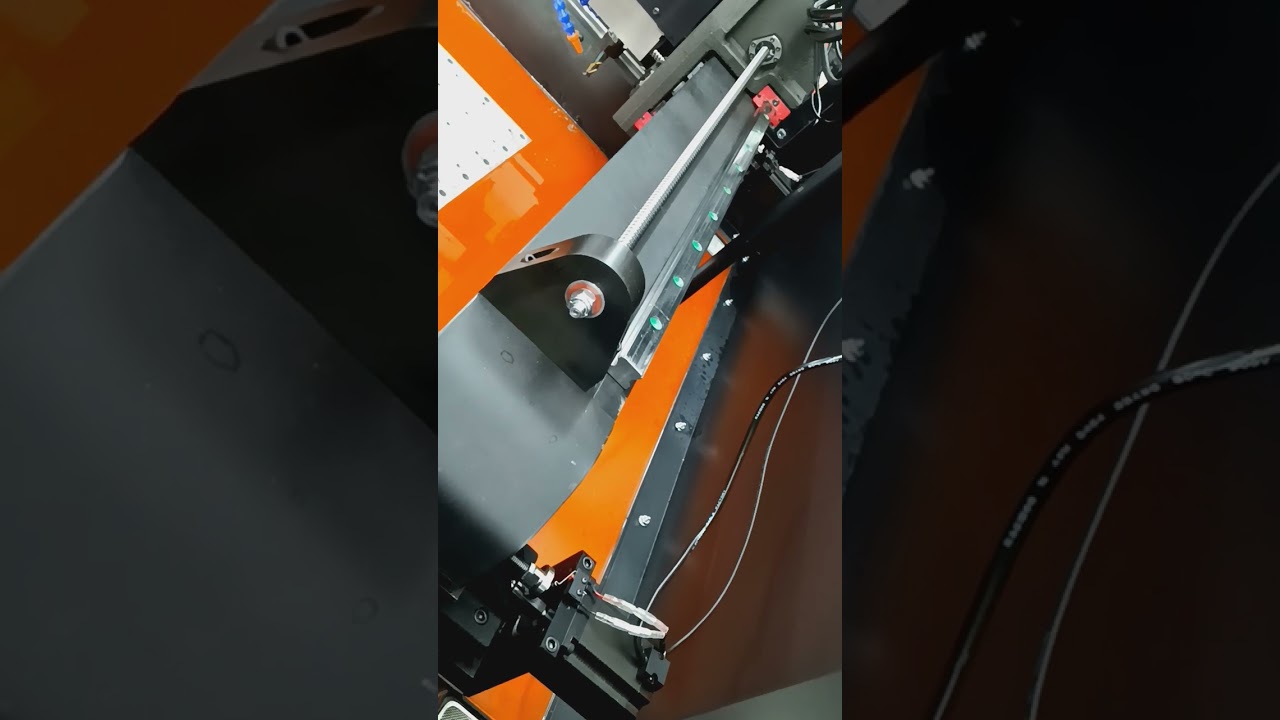

Anyone have any pointers for this. I can home the machine, but If I try to rapid away from the home position on the Y-axis, the stepper motors will stall. If I lower the speed to 25, then the gantry will move off the Y-axis limit switch with no problem. Has this happened to anyone else? Trying to upload video now. Here’s a link to some video of the problem.

Hey there- I recommend resetting your limit switch stops. This is likely caused by limit switch stops that are out of sync. The end result is that the gantry is forced into a bind when auto squaring. I’d recommend redoing the squaring process- if that does not work, then please let me know as there are some other things we can look at. If it doesn’t resolve it would be best if you send us an email so we can help you through our support system.
