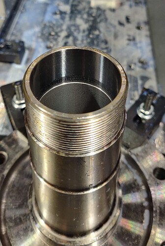

Modified some toyota spindles tonight to allow a different axle shaft to work in them which requires taking about 0.040" of it. Ran the bore probing cycle which made setup super quick and easy. Barely squezzes in the z axis range but if it fits it ships. We also swapped our coolant over to Qualichem xtreme 250, much less of a residue left, no staining on aluminum and the surface finishes appear to be better.

Awesome project for MR-1! Thanks for sharing.
