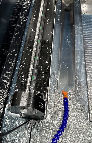

So after running the MR-1 for a week of continual use it can hog out some chips but they just all build up on the Y rails
Decide to try making some side skirts for the y rails along with some fairing attached to the X axis beam!
Was a massive improvement but think the front of the X beams fairing need to be longer both in front and out the back. I also add coolant nozzles on the X beam that help clean the chips off the fairing and skirts along with two nozzles spraying down the drains. Would say about 70% of the chips went down into the chip tray. The right side nozzle were only partial open in the photo.

Also ground down and epoxy filled the corner drains in. Not really need with my setup and where just making it hard to clean up! Easy to just squeegee from the corners out.

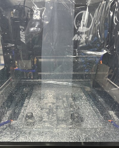

Sometime the simple solution is the best. Been trying to figure out how to stop the dripping when opening the doors. Was in the shower when the simple solution hit me. Shower curtain! Got a clear shower curtain trimmed it down to fit the MR-1 and enjoyed no dripping from the door today while running the machine.
