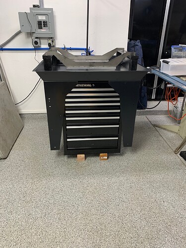

This is going to be my build with a few addition or modification. Nothing really set in stone tell the concrete gets poured! To start of I find that any floor space becomes a junk pile. Under the MR-1 is a lot of potential for thing to pile up. Solution which also helps with organizing tooling other bits is to build a tool box into the bottom front!
This will add a little more height than I want, has I plan to build a skid for a pallet jack. I know in the next year I will need to move this behemoth!
I plan to cut the bottom corner of the tool box to lower it done some has it just a little to tall on the 4x4s.

Very nice. Well thought out. Where did you move the drain lines too?
The fronts I just shorten the run to clear the tool box. May need more hose to get back to the tank. The rear is the stock setup.
