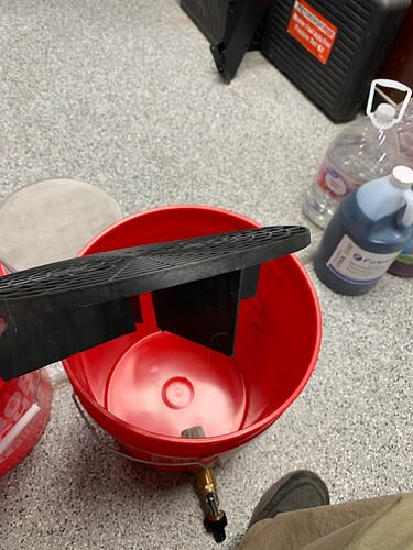

Start building test buckets for the drain and chip collection. Just 5gallon buckets with a valve installed the a screen mesh on the drain then a stand with a 200 wire stainless steel mesh that will get siliconed into the bucket. I will build stand that the bucket sit on and will drain into the provide bucket with the pump in it. If this works well I will most likely build a pull out tray setup.

Loving this build. Definitely want to copy your idea of moving the drain system around… I was debating adding some spray nozzles at the back of the machine to move the chips forward and having a deeper valley at the front for chip/coolant catch. and setup on top of a tool chest is brilliant! Just wish I could weld.
do you have a link to those particular shower drains? I’ve been looking and it seems difficult to find that style…
Neodrain 24-Inch Offset Side… https://www.amazon.com/dp/B07DN7CBZ8?ref=ppx_pop_mob_ap_share

Started some CAD to build a chip tray. Will be mounting it in sliders so it can be pulled out to clean out the chips.

Finished the pull out drawer! Now just need to build the box.
