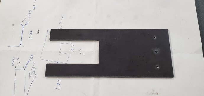

Today I made a couple of Fire Extinguisher hangers. I designed them in Fusion 360 saved the design as a DXF and sent it to SheetCAM to generate the gcode. I designed them to have three mounting holes. I wanted to just mark the hole location (just to try it out) and then cut out the main bracket.
I ended up doing two complete separate operations. I first laid out the design on a piece of scrap to make sure I had enough room, then loaded in and ran the marking gcode. I then turned up the amperage loaded in the cut file and cut the bracket out.
My question is, is there a way I can do both operations with one gcode? Say with a 30 second delay in between the marking and cutting operations so I would have time to turn up the amperage.
You can add in a code snippet and do a M0 between each operation.
My understanding is that Firecontrol does not fully understand what M0 is. The program will pause as requested but you have to press pause, then resume to carry on. Just pressing resume wont do anything. I have not tested this with the latest version of Firecontrol but it was the case with previous versions…

So all that all being said, I may have to change consumables between the marking and the cutting operations. But with the pro tip from @Craig1 on inserting the Code Snippet between the drilling and cutting operations, there will be plenty of time. I tried it today and it works just as he described.

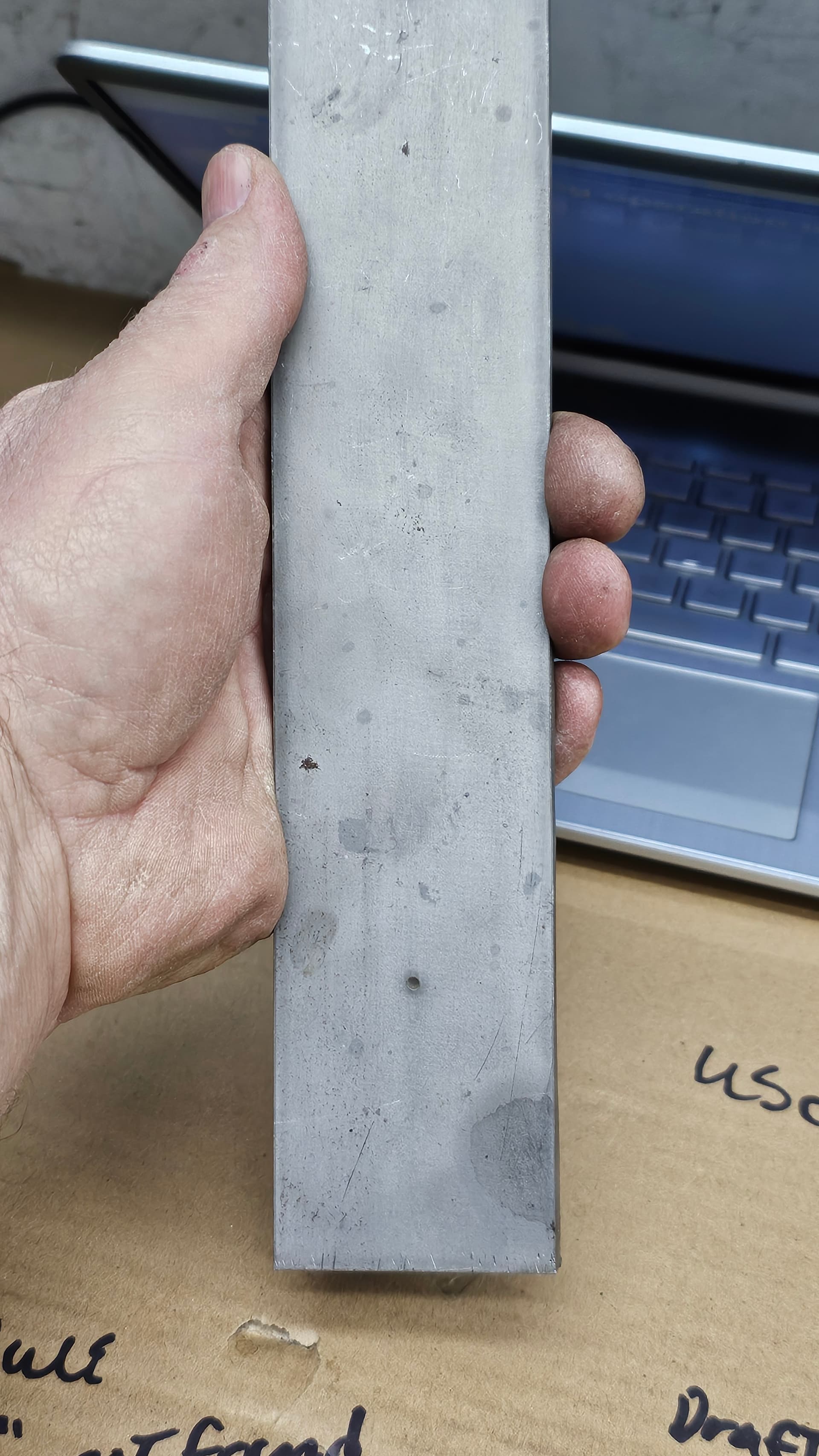

if you’re not concerned about hardening the holes initially to manually drill them out later then you could just start both operations with the higher amperage. If that’s the concern then you could have the torch pierce from a higher starting point so as not to add too much heat to the holes? all you’re trying to do is create a centerpunch anyways to drill out later.
I use the drill/centerpunch feature in sheetcam all the time with no issues with drilling them out later.
I’ll have to try it. I understand and it makes since that cutting the hole makes it real hard to tap later. I wonder how hard it will be to drill later for tapping if you just punching a small hole with the drilling operation.
I have tried to drill out holes (5/8") that were undersized and it was brutal. But a pierce in the center would not be as bad, I would imagine. I would definitely use drill press with cobalt drill bit and cutting fluid.

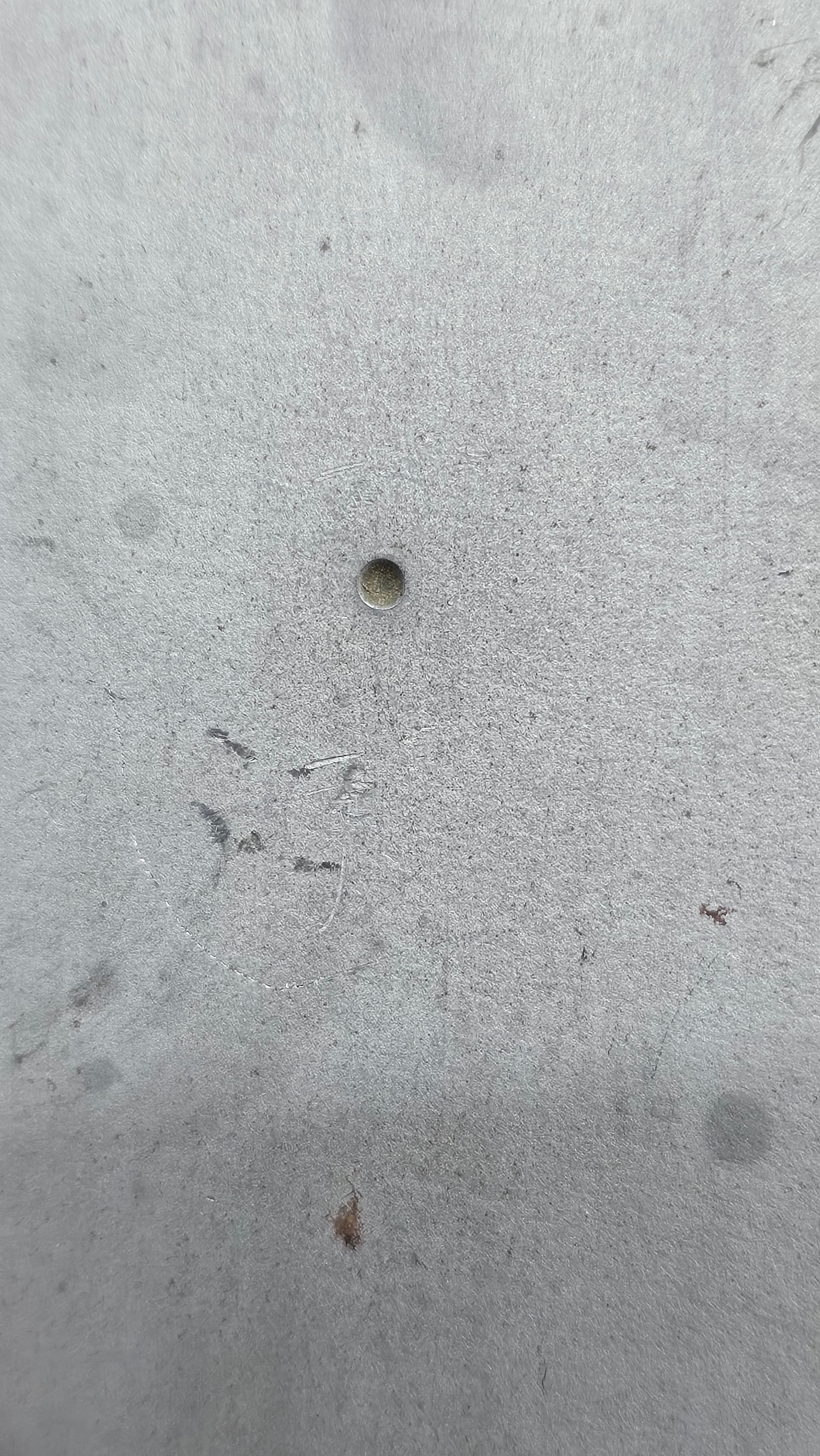

i don’t change any parameters other than maybe having a shorter pierce delay for the drill operation. the pecks it makes barely creates a divot but its enough to use as a guide for the drill later.

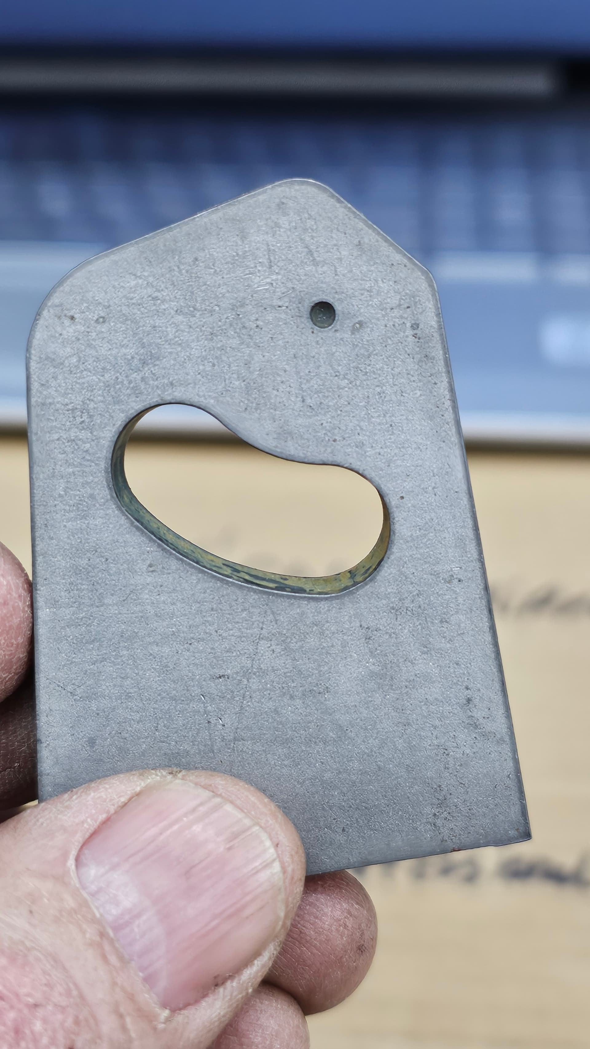

Just want to mark centers lightly,doesnt hardened hole easy to drill and tap afterwards. these I did on my XR table with Hypertherm powermax 45 XP at 45 amps and .1 delay. Drill bit 1/16" mark is about 1/32" deep

Yes, with the use of a Code Snippet. You can add the snippet in-between the drill operation and the cut operations. It’s pretty slick, I tried it yesterday.
