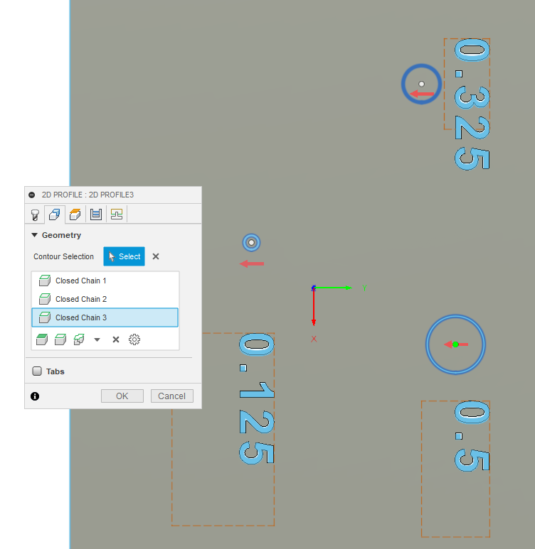

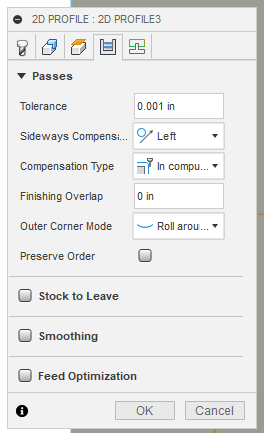

In Fusion 360 you can make this happen but you need to make your holes in the sketch all the same size and then create a tool that has a kerf width just slightly less than the hole size. You can set the amperage on the cutter to whatever you want depending on an actual pierce to only a mark.

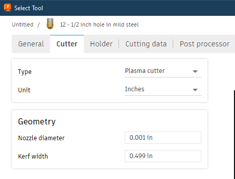

Here I have three holes. For illustration I labeled each hole. In the tool path I select my tool that has the kerf width that will just barely fit into the center of the hole: 1/2" hole tool will have a kerf width set to 0.499.

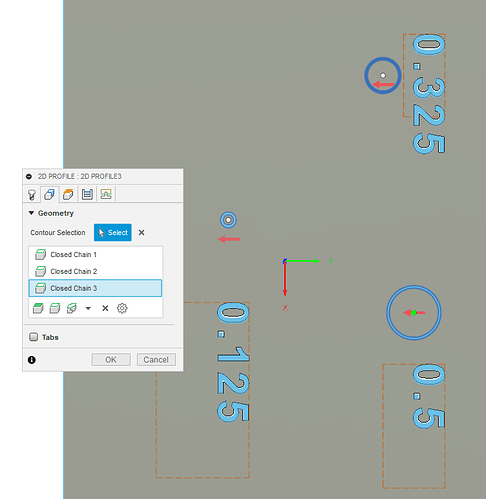

I select all three of my sample holes, knowing that it will reject the holes that will not fit my ā€œtoolā€ that has a kerf width of 0.499 inches.
I don’t want any finishing overlap and I still want left compensation otherwise it will cut on my line.

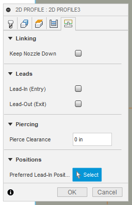

You don’t want any lead-in or lead-out:

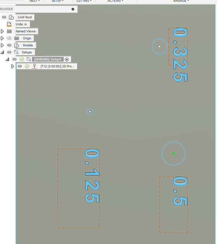

Notice all you see is the green dot. The hole has been selected and it will mark/pierce the center. It disregards the two smaller holes.

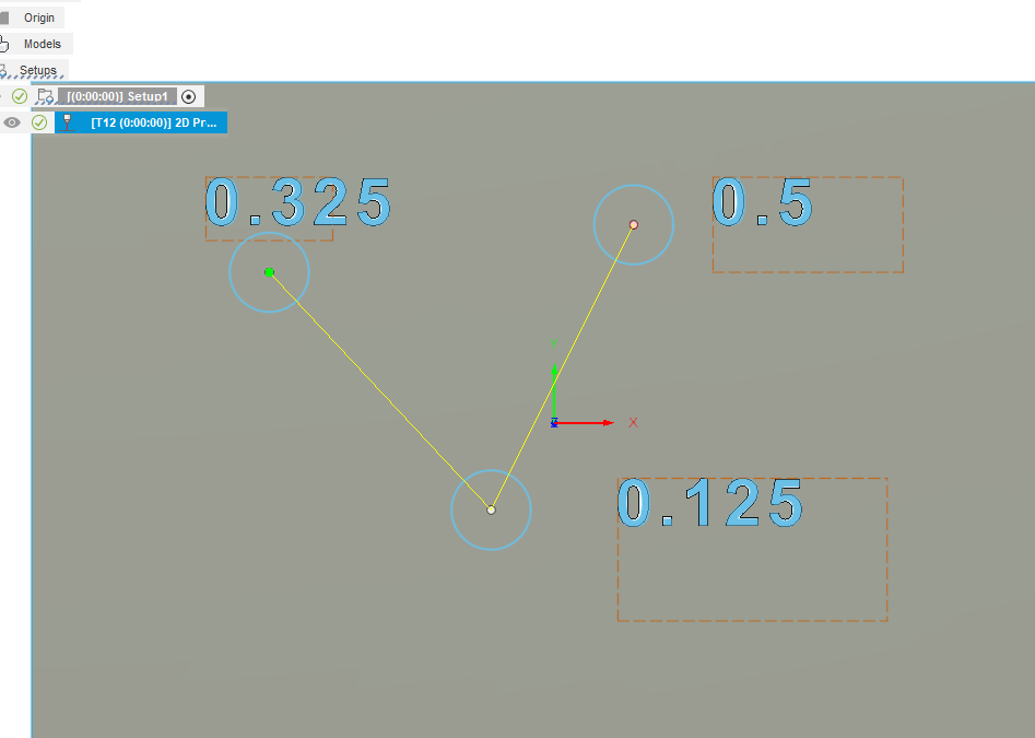

If I edit all the holes to be 0.5 inches, then they will all be included. You just have to remember the size that they need to be drilled later:
Edit: conversely you could make all of your holes 0.001 inches larger than your current tools kerf width and select all the holes as above without creating a new tool. They just might be hard to see on the sketch.
When I’ve done that type of marking I just use centerline cut it will make absolutely no difference in circle size when circle is .001" and then you don’t need to create specialized tool. At least in the testing I’ve done.
