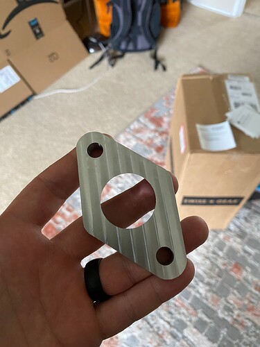

Exhaust flange for a Ford Kent Crossflow out of SS304 (cylinder 1/4, 2/3 get a combined flange). Complete overkill for the application probably, but I went down a rabbit hole once I started drawing it. Transitions from the port out to a 1.5" primary with a step to locate said primary. Cutting went well, and I was impressed with the finish on the part. I did mess up the flip somehow, so it has a step on the outside profile. Not ideal, but not the end of the world as far as screw ups go.

That looks nice! What tool did you use on the conical section? Is that from a ball mill with low stepover and stepdown, or a tapered endmill?
Thanks! First one, 1/4" ball mill with lots of step downs lol

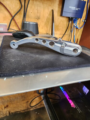

Harley knucklehead kick start arm. Not quite done yet. Very happy with the results. Needs more sanding and polishing…

Beautiful!
What size endmill did you use for the fillets at the larger end?
1/4 ball mill. 3D contour with .004 stepover. It has been sanded and polished.
