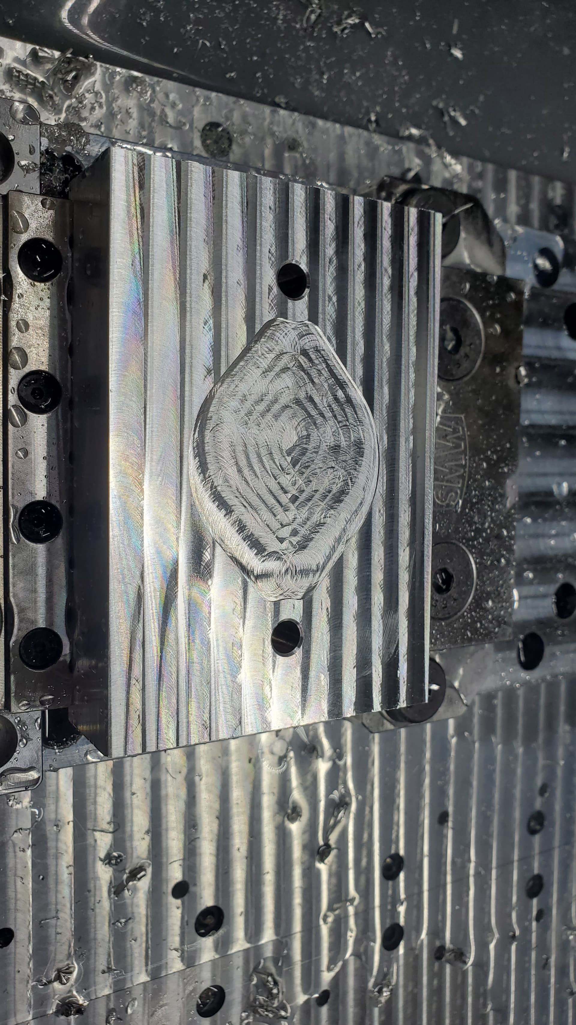

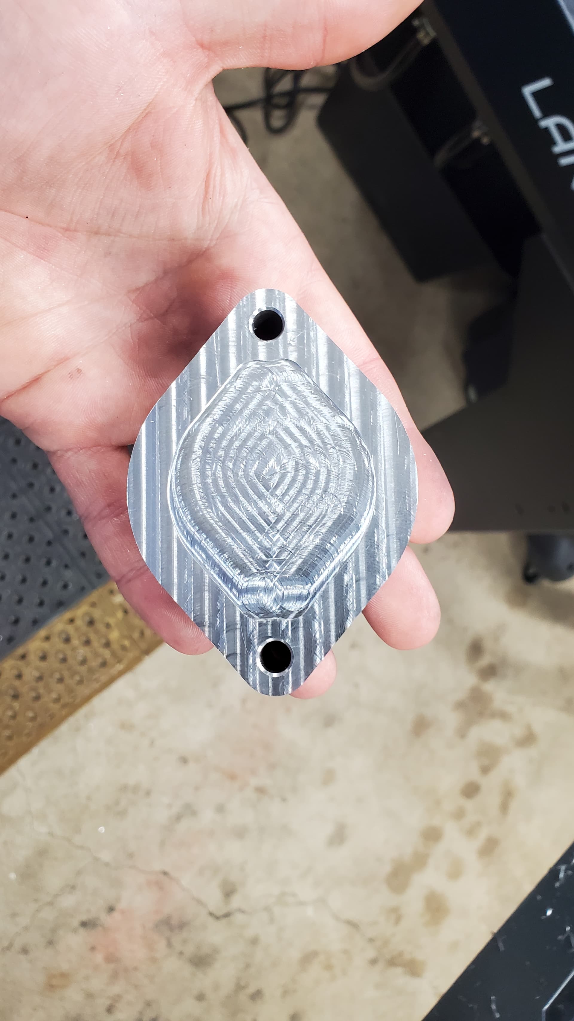

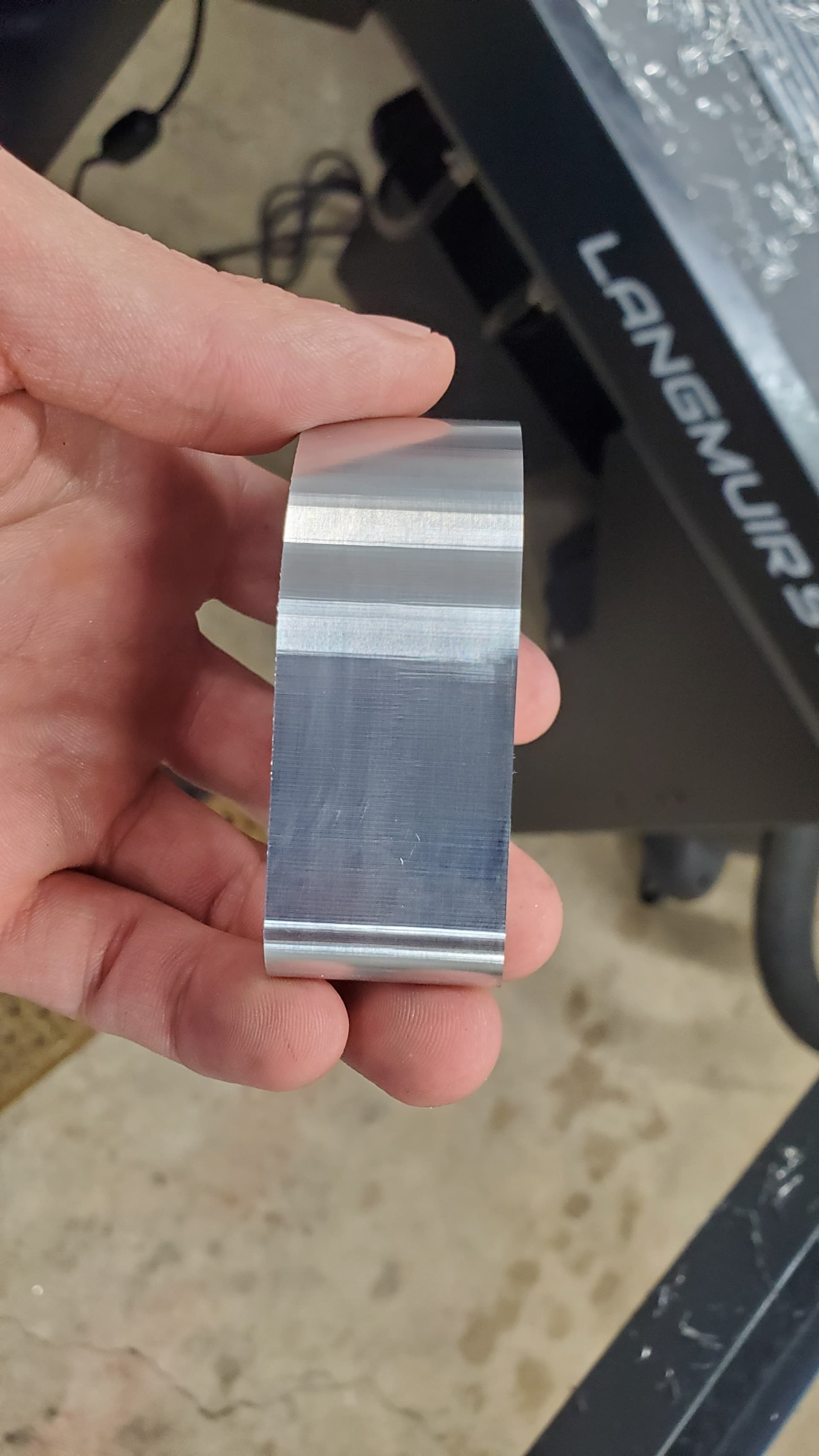

Yes. I just swapped my Y/Z to high power steppers and did a recalibration and resquaring of my machine.
I had a test part to make for testing some engraving but figured I would play around a bit with a dikfer geometry test. The resulting dimensions of my part were all within .001 on all axis to include having a nice round bored hole for testing fitting a bearing.
I suggest getting some 2/4/6 blocks in addition to 1/2/3 blocks. For squaring gantry and calibration I like to use the larger blocks to help decrease error thanks to longer travels.

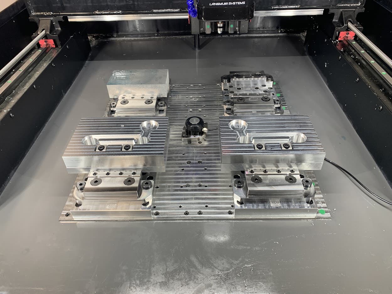

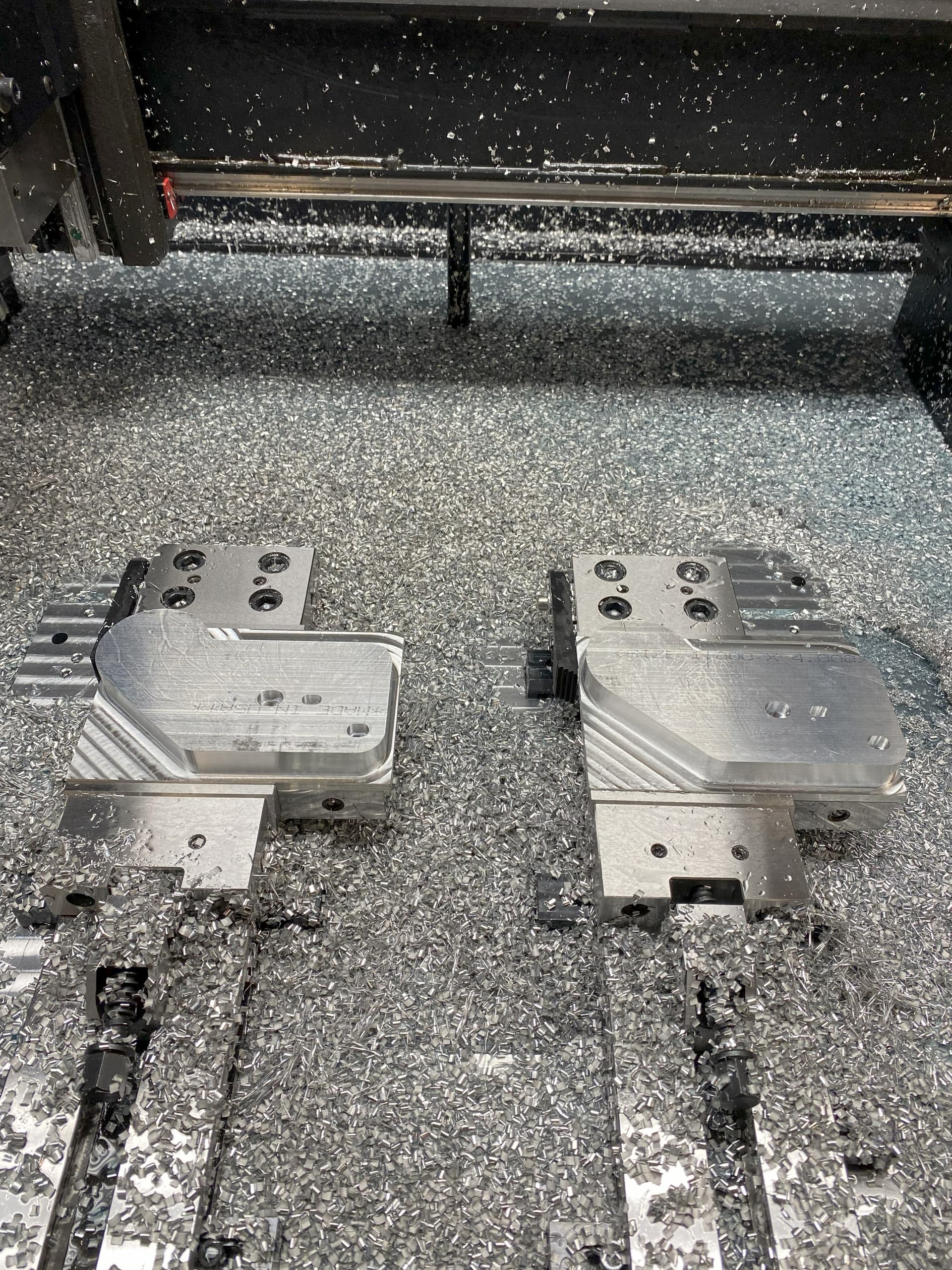

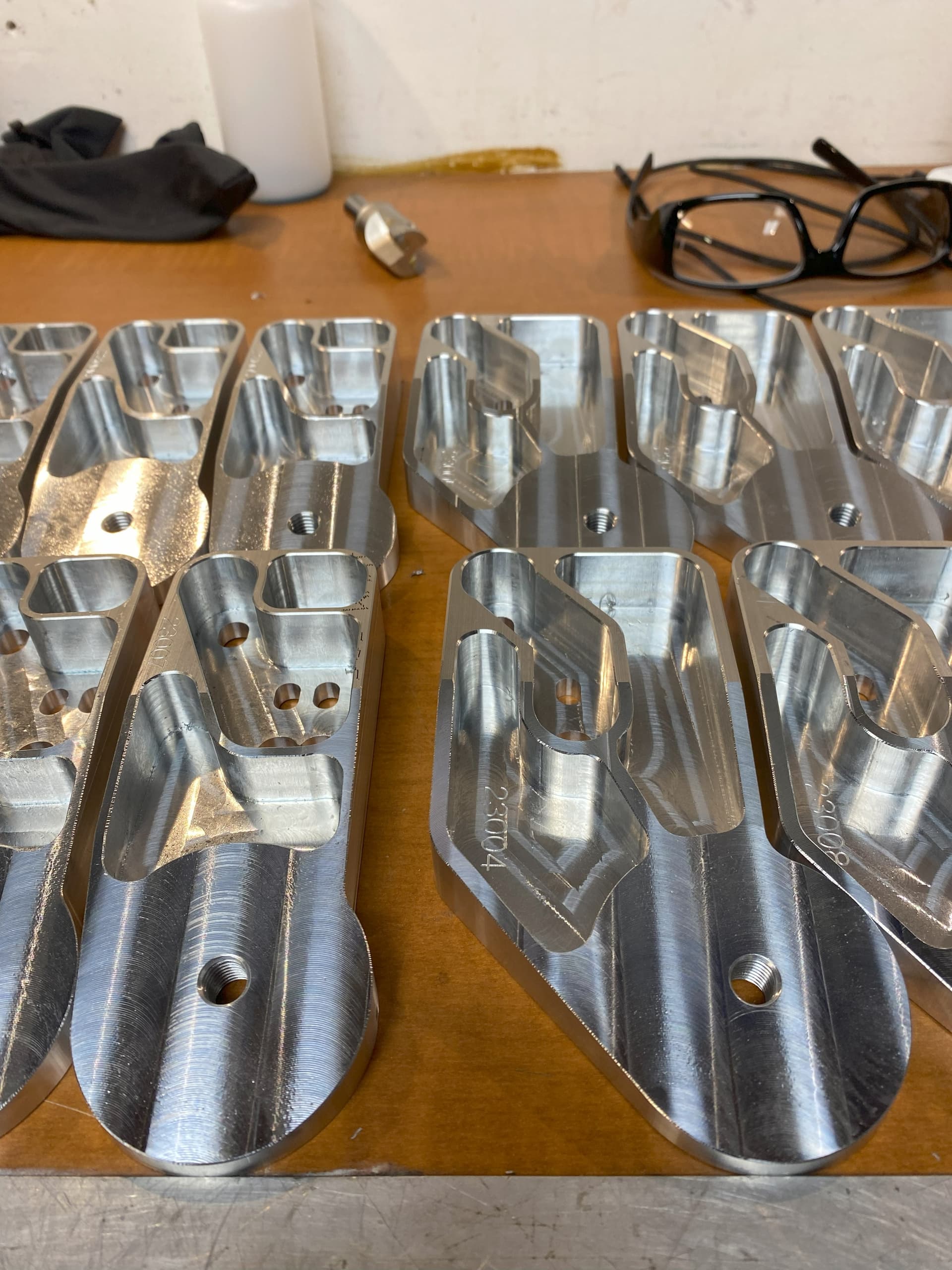

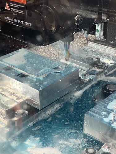

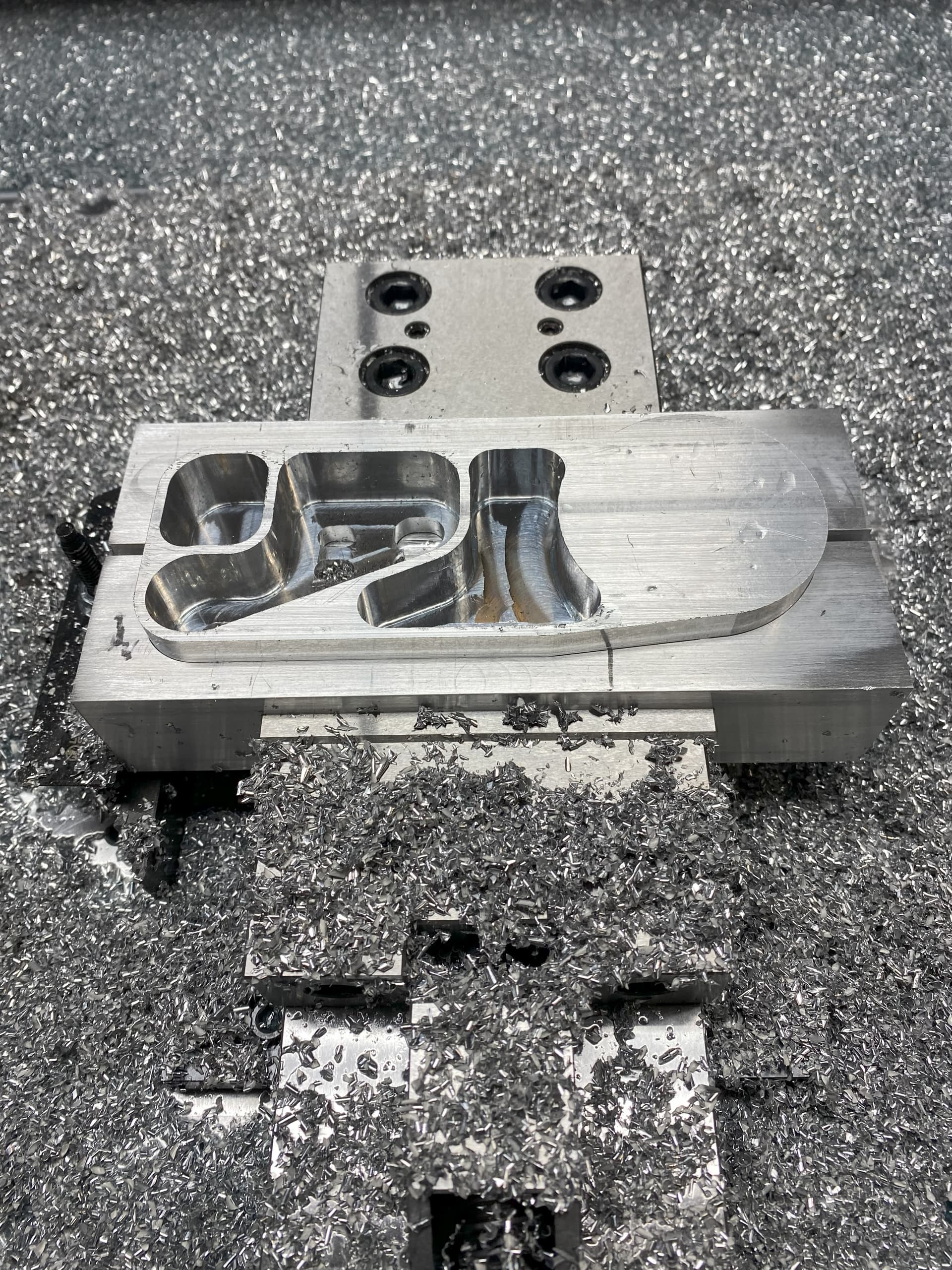

Well, Been gone a lot for my regular work, but finally got my jigs set up so now i can do opp 1 and opp 2 for both left and right parts. So far it has been working out really good.

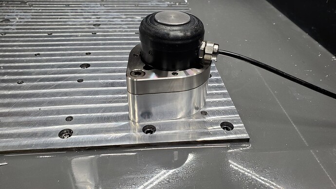

Made a stand off for the tool setter, got tired of not being able to touch off small tools.
Man im running into the same thing. Can you share the file?
MR1 Tool Setter Extension.f3d (77.9 KB)
Here is the file I made, only thing I took a shortcut on was putting the chamfer on the part. I wanted to get back to the job I was running and couldn’t be bothered to put a chamfer mill in. You will just need longer bolts for this to go in the machine, I had some laying around.
thank you. I appreciate it
Did you have to make soft jaws to hold opp 2?

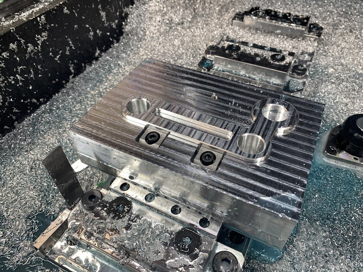

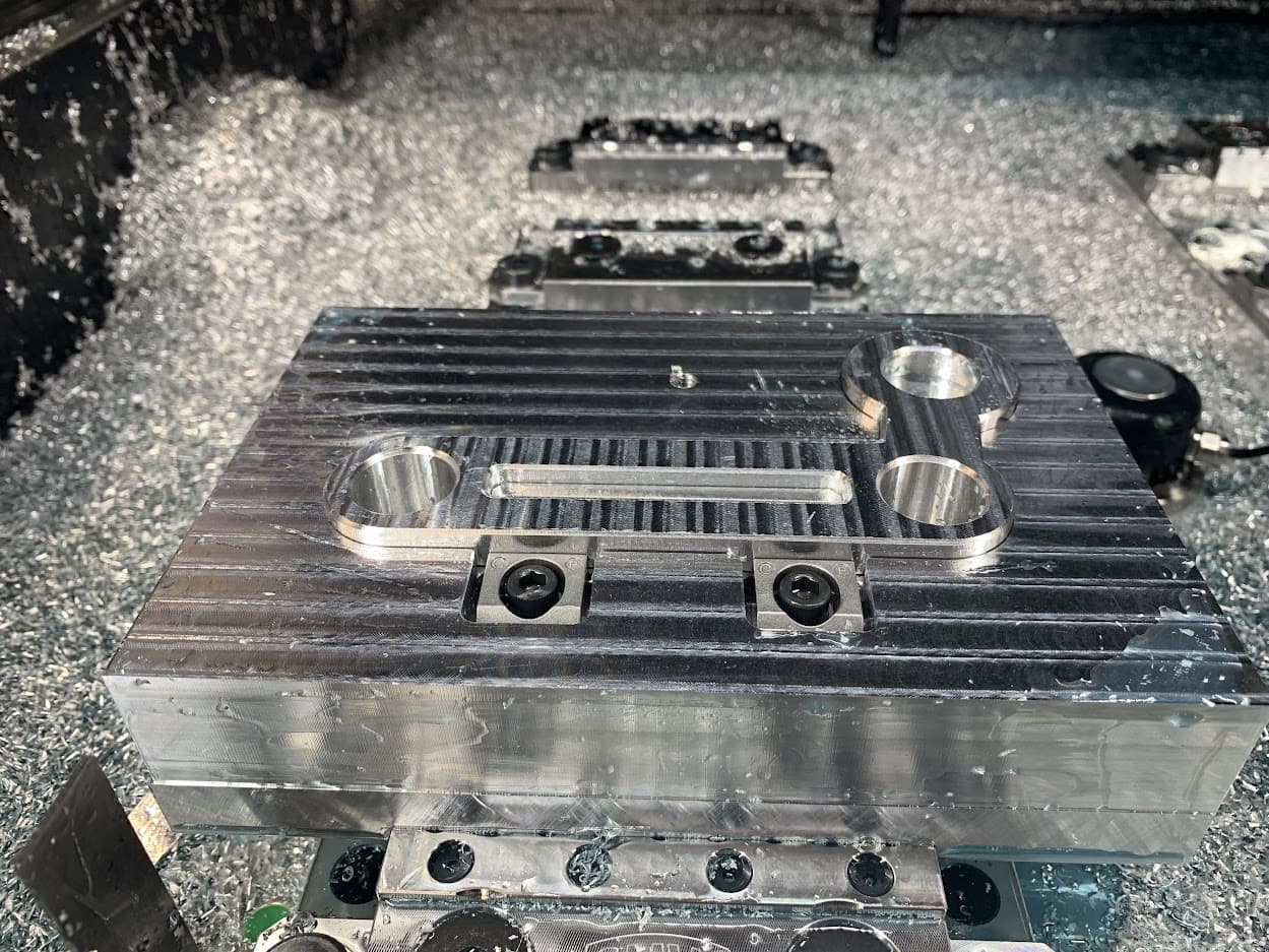

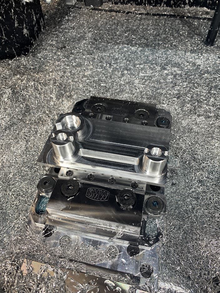

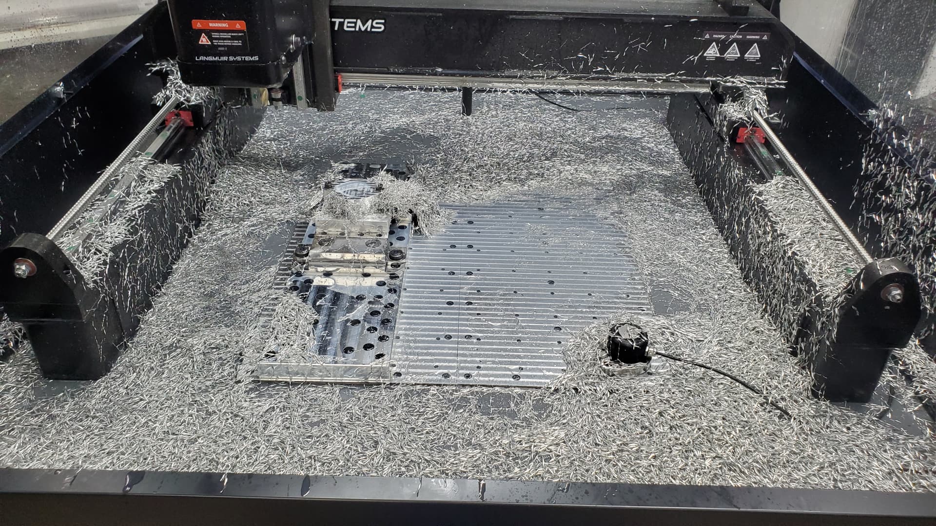

I only took video of the final op. running so I have no picture to upload here (can’t upload video directly to the forum) other than the one of the mess made. First op. was held in the vise and came out looking like the first picture. I faced the part and put the recess in followed by the two drilled holes. My second op. was flipping the part over and repeating the first op bringing in the 1" height and adding in the second recessed area. I then used a plate I had to go in the vise and bolted the part down and indicated it square to the two holes so the profile would be correct to the two holes. With one bolt torqued down I removed the second bolt and used that bore to pick up my zero then retorqued the second bolt. I was then able to finish the profile, that was done using a 2D adaptive tool path with a 1/2" 3FL 1.25" LOC carbide endmill. The part is 1" tall so I took 1" depth of cut at 8000 rpm and a .050 step over.
If people wanted to buy some of these as opposed to making it for themselves I would defiantly do this in two operations and make soft jaws for the second op.
Got ya. Thanks

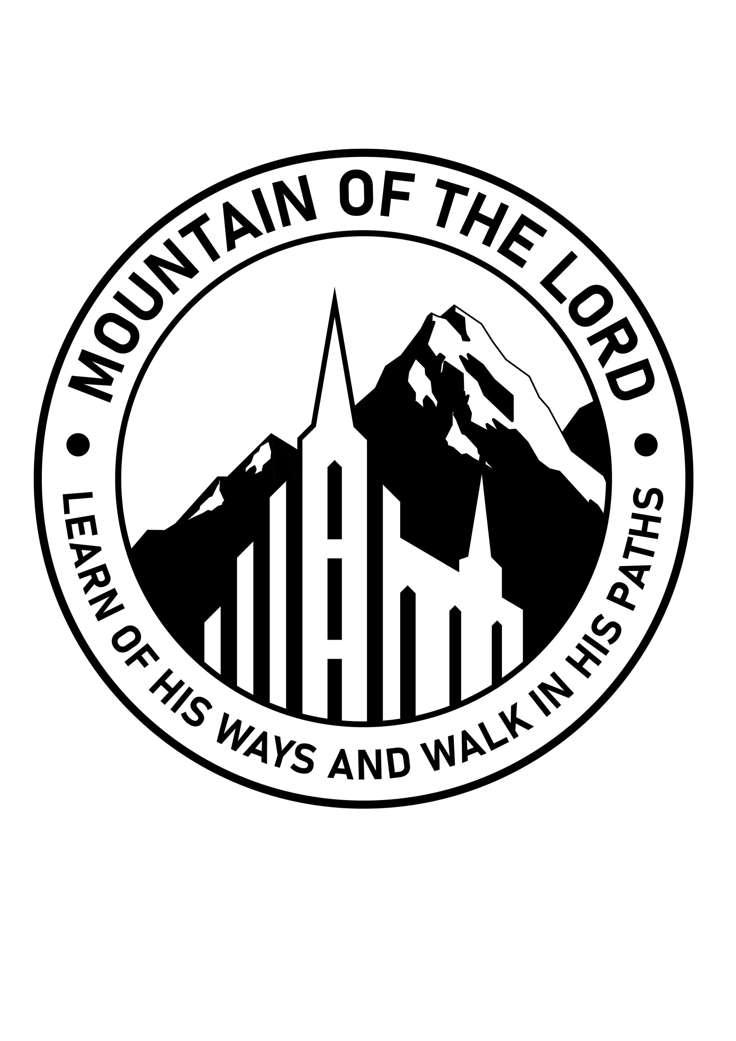

Anyone interested in giving me an estimate to make attached pic from mild steel as a leather branding iron? Needs to be 2"x2" if thats possible to make that small. Or as small as you think it could be made. It would need design raised up about 1/8". Machined from 1’2’ thick metal. all i have is a picture. Needs black areas as branding surface. Customer came to me to do it. All I have is a plasma table.
@ MechanicJon This isn’t really a great application for CNC milling, which is required to have internal radiuses on corners - especially for a part of that size. If I needed to make this, I’d probably get it cast out of bronze and then mill the surface flat if needed.
Refer them to Schild for a branding iron. They make some really cool metal labels too. https://schildinc.com/

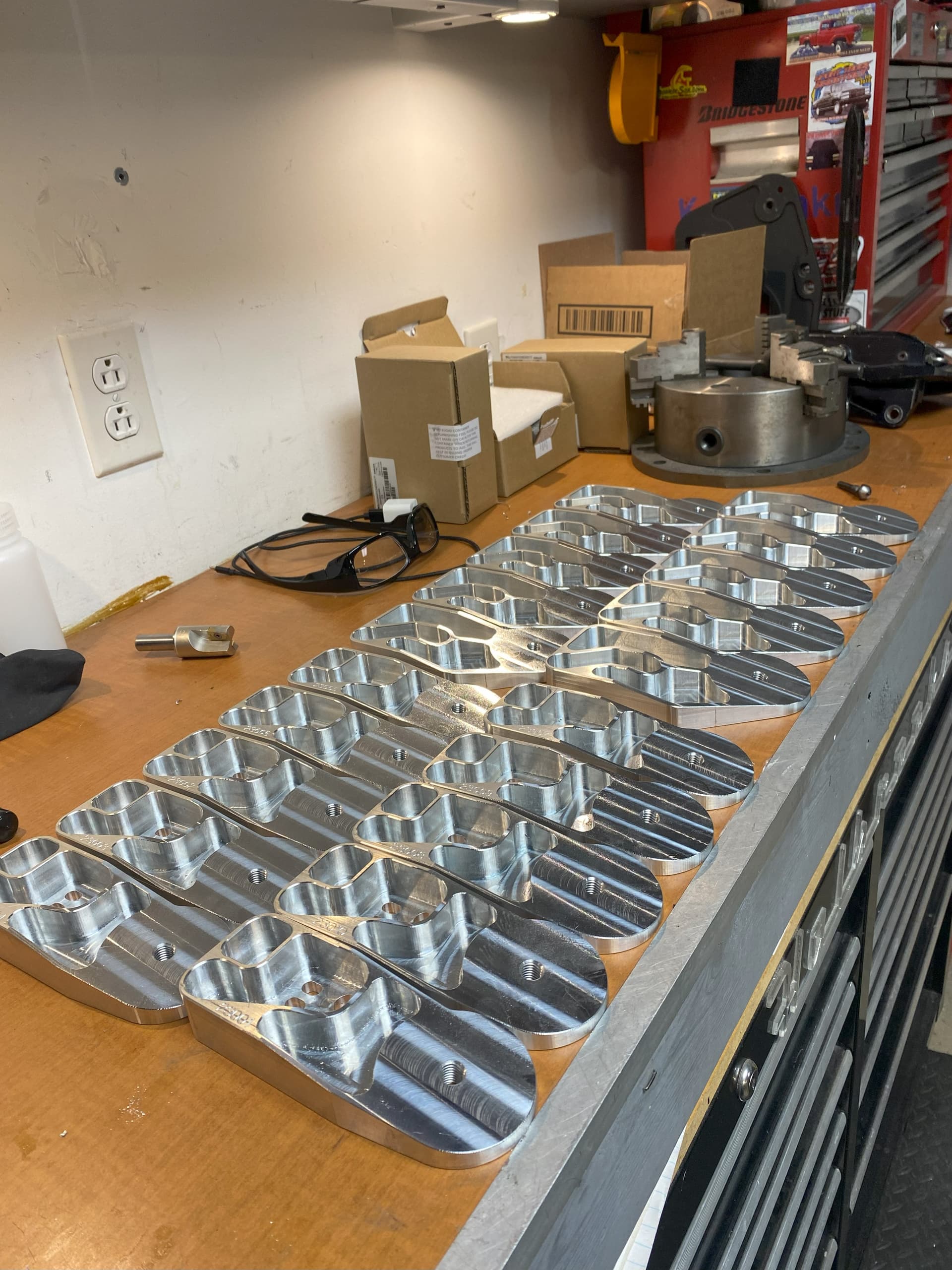

One of the jobs I just finished on the MR1. Machine has ran flawlessly with no issues. Programmed using Vectric VCarve Pro. I use it primarily for 2D and use Fusion 360 for 3d.
They look great what are they???
Thank you! They are engine mount adapters to swap a SR20DET engine into a Nissan Z32 300ZX.
