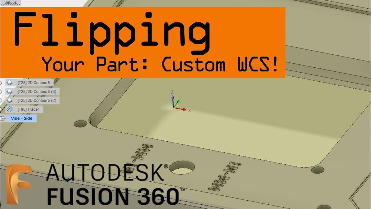

First actual part! It’s a bottle opener. You can see it shifted over about .008 when I flipped it. Not sure what cause it, but I made some adjustments to the tram in-between the first op and second op while I waited for the 3D printed soft jaws. (Took several test prints and days to get them right. Lol)
You know I love brackets!
I had the same problem and this fixed it for me.
Thanks sr71xjet, I’ll give it a try.
