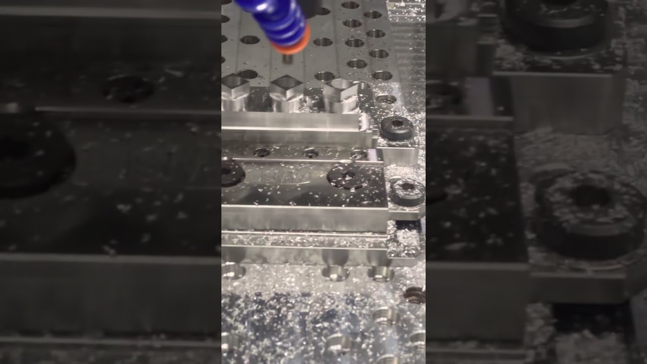

testing few more operations for my MR-1.
I tried a 2D pocket/boring operation and then a chamfer on my previously cut test part.
I used the probe to get a new origin on the previously cut part and then run the 2D pocket with roughing depths and a second 2D pocket full depth to remove 3/1000” left. I aimed at 0.4” hole.
I am impressed with the results I got.
You can see the link on the ops with more detailed description on youtube:
