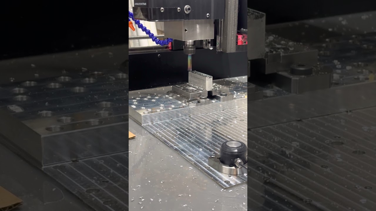

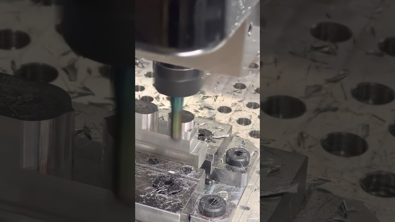

Finally this is the first test piece that I designed in Fusion360 for hobbyist.
I did a surfacing operation with 1/2” endmill 2 flutes and subsequently I loaded a contouring and adaptive clearing operations with the 3/8 end mill and all the suggested feeds and speeds from Langmuir. I was happy not to crush the machine first of all. The process was a bit slow but got great accuracy.
I used the probe and tool setter to define origin and calibrate both tools and all was smooth. Pretty happy.
Looking forward to the new version of cut control.
You can see both operations on youtube here( wait for the high quality video to be ready on youtube.)
Really happy with the accuracy as well.
