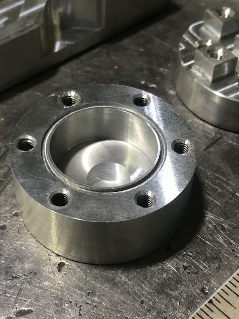

Thank you. Which size tooling did you use on your spacer?
I’d have to look at my setup, don’t remember off hand. I know I made it from aluminum and pretty sure I used a 3/8 flat end mill for everything but the holes and that was a 1/4 drill.

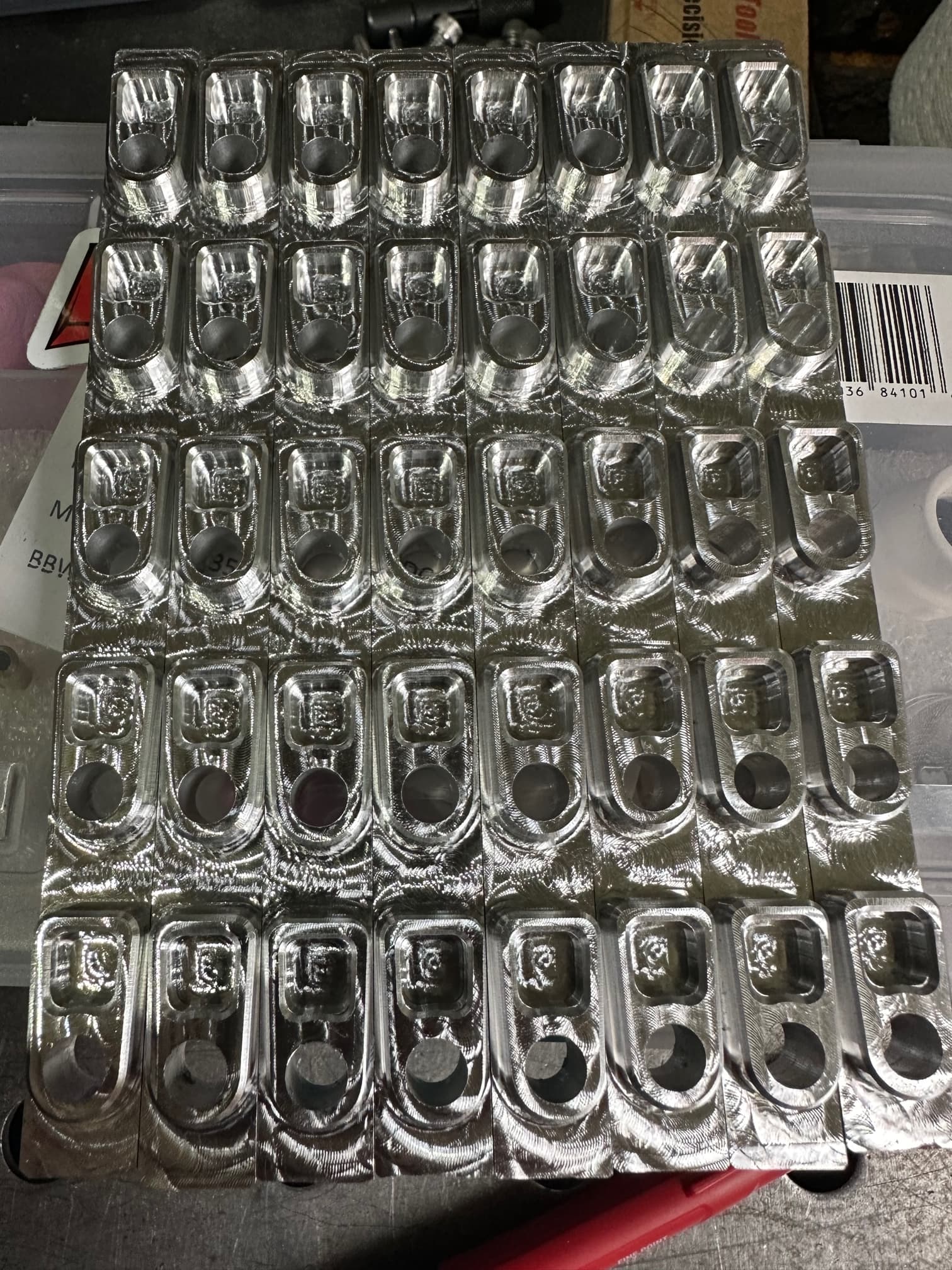

Made a short run of some small parts. I am very slowly figuring things out!

Very Nice!
Thats a rather large handful of parts for slowly figuring things out :rofl:
Looks good!
Awesome job. Those small end mills make my butt pucker. :+1: You the man…
Speeds n feeds and proper stickout. Nothing to it.

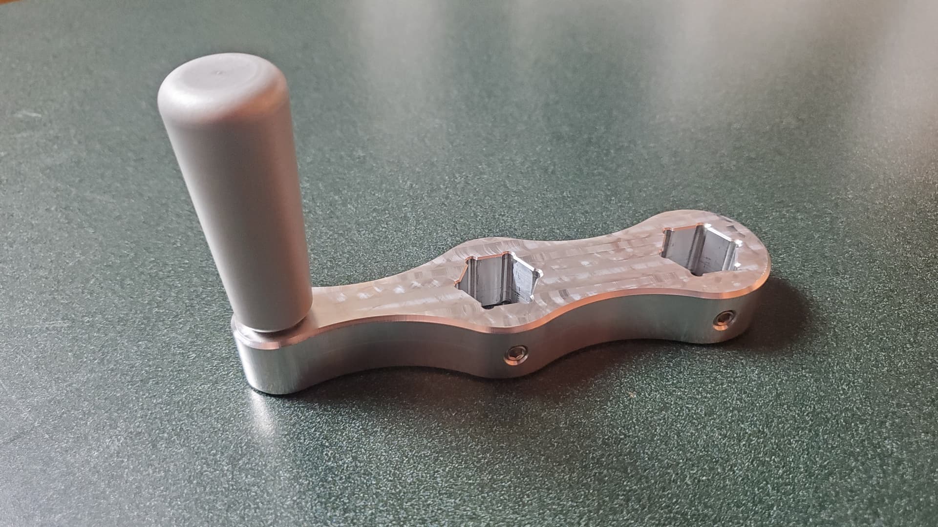

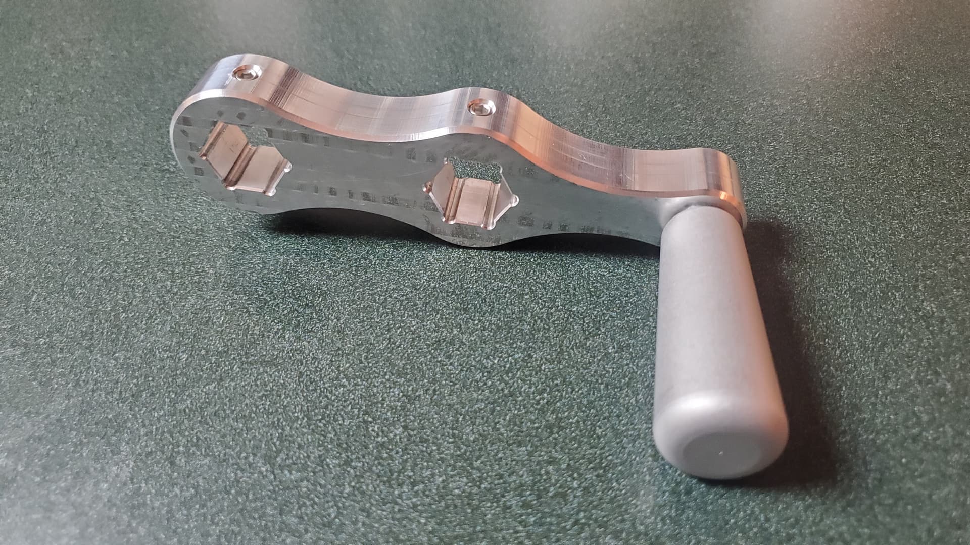

Made myself a speed handle for my vice recently. I wanted one that can handle a little extra torque and has a rotating handle.

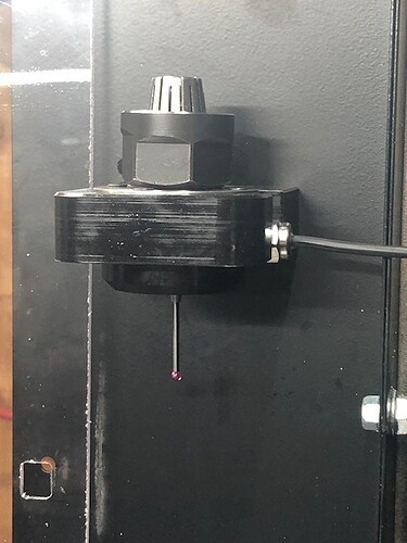

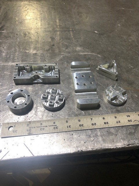

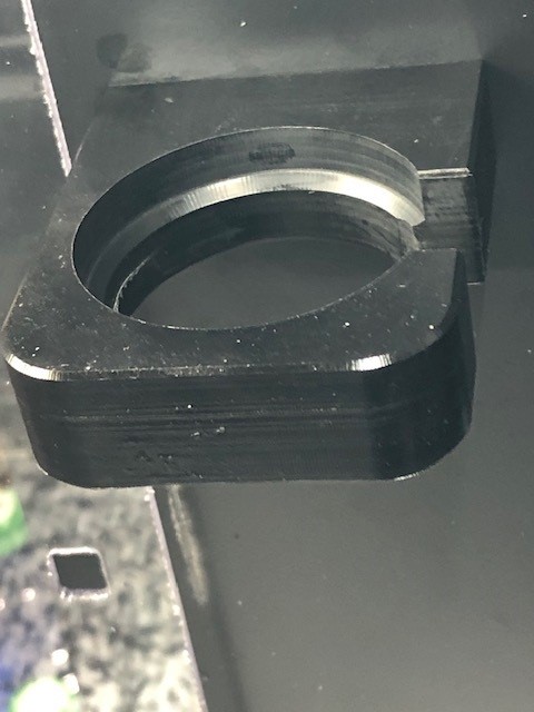

After seen all the cool things being made I’m embarassed to show my little attempts but at my age (71) with no CNC machining background im happy to make it to the toilet!!! I’ve followed Titans of CNC training course (they have CAM examples for Tormach that I modify for the MR-1) and to date have fabricated the following pics. The only “real” thing I designed and cut is the delrin probe holder. I bought extra spindle nuts and keep one with the 3/8" collet with the probe in the holder.

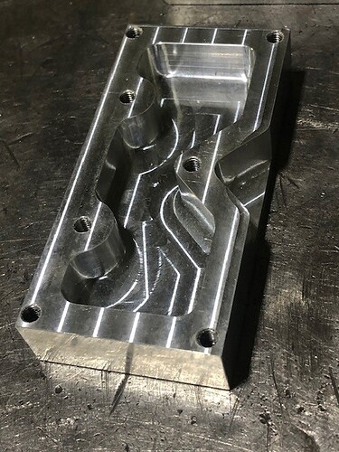

Wrapped up the milling and polishing of some custom door pulls. Last time I built a set I plasma cut them out of ¼" stainless and welded the layers together. This time I used solid ½" 304ss and it was way less work by hand. Still need to weld on the standoffs and the backers plates. But definitely happy to be over the polish stage. The installed picture was the welded version.

Outstanding work. It’s one of the most excellent parts I have seen yet off of the MR1. Kudos :clap:
Hey at 71 and no prior cnc experience them parts look great, be proud of your accomplishments.

WOW I don’t think anyone is going to top that! I take it your all set up for polishing?
I’m curious how long did this take start to finish? I take it you designed and installed?
Thank you sir, glad I have the MR-1 now to make it easier on the body!

Thank you! Yes I’m set up OK with polish stuff. Just tried stuff from a company called Renegade Polishing Products and I’m pretty happy with them. It’s more elbow grease than anything. The design was an established one from the client. As of now I’m probably 200 hours in and I’ll probably have another 60 to 80 hours into it. I On the first set it was only one set and it took 130 hours and I did the install.
Years ago I worked next to a small shop, that all they did was buffing. I think mostly aluminum and at the end of the day those guys would come to go home and man did they get dirty. That black mixture of aluminum and whatever polishing compound they used was nasty stuff.

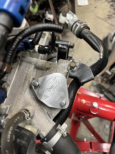

Made up some plates for a K24 swap i am working on lol. machine works great so far. Still waiting for proper bolts.
