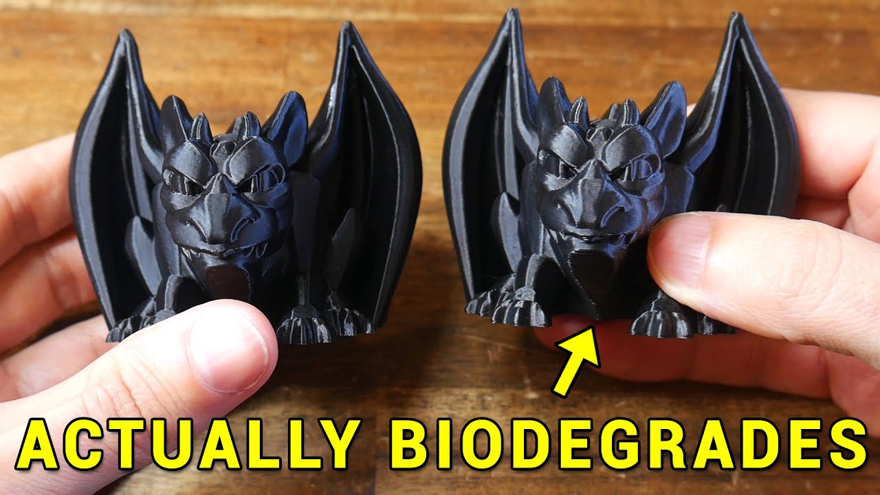

Another new filament on the market. Teaching Tech did a comparison vid. Interesting stuff.

I didn’t like that warping of that PHA.
Neither did I, but there is always a way to counter it. ABS/ASA is horrible about warping on long stretches also.
Agreed about ABS. I have not done anything with ASA larger than about 4 inches diameter on the build plate so I haven’t noticed it yet. I do know it will, but so far it seems less than ABS.
And, I am sure the Brand makes a difference. The ASA I am using is FlashForge and so far I am impressed. ABS was primarily Sunlu.
I had problems with printing ASA warping on larger spans. I turned the plate temperature to 195 C from 170 C, and the problem disappeared. I guess keeping it hot inside the enclosure is the secret.
And slow cooldown.
