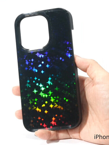

Did you see those cool 3D effects bed plates. This is the Diamond Surface sheet using silk filament.
