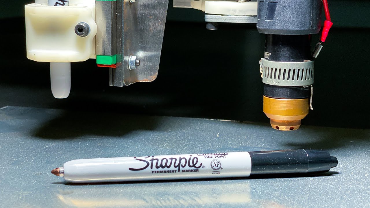

I would like to be able to add markings to my parts. Both for Part number and bend locations. I know I can place these marking digitally in my model but dont mark them as cuts, How do I translate that from my model to my G code? As in have movement of the tool but not have the plasma command fire. I know there is a dry run feature on Fire control but that seems to be on/off and I would prefer not to run 2 different programs of gcode. I will have a pen tool offset from the torch head on my XR.

Here is holder for sharpie. this was something in my head that was simple and easy. I work with people (engineers) that could make this a month long project. I spent an hour so if your using this all the time you might want to improve on design. Your metal must be level or going to have issues marking.

The two tools will have to different requirements on how they run. Also depending on how the pen is mounted, weather replacing the plasma cutting tip or mounted to the side of the plasma torch would adjust the relationship between the tool center and origin .
You will need a a pause for a tool change.
the code for the sharpie will also need . NO THC. no pierce delay, no pierce height, no fire on, no fire off.
if you have Hyperthem 45xp you could use marking consumables the would make marking a little easier code wise. Marking with plasma torch?
or the Easyscriber https://www.theeasyscriber.com/ these two options do keep the relationship between the origin the a the tool center the same which is a huge benefit.
In the end if you want one program when using a sharpie we will need to produce then modify the code for the sharpie then combine the code with standard code to the cut the part.

Once I got playing around with this the other day many challenges started to show up as you described. You could easily overcome the difference of sharpie zero to plasma zero once you knew the relationship between the two points. The thing I was mainly trying to understand was could I get the marker to lift and lower from point to point. I don’t deal with it moving up and down.I think I’m going to order the easy scribe because it’s been on my list of things to play with anyways. So I’ll need to figure out the up and down movement
I might be on to something now… Problem setting parameters for Easyscriber
I did get it the marker figured out. When you go to create Gcode the settings in blue are the ones that matter. Why I couldn’t get it working yesterday was because i was doing “dry run” in firecontrol. That must disable the IHS. Now back to the using both on same design. I need @Bigdaddy2166 or someone to mill me a mini sharpie holder that screws on the end of the Hypertherm retaining cap. if someone makes these, I deserve free one and should get a royalty for daughter’s college fund. If you just want to use sharpie that’s easy but the two together is more tricky. I think you could factor in offset at start of cutting out but that’s much more complicated.

I experimented with Hypertherm marking consumables and used a sharpie with similar settings to the easy scriber. The real trick to this whole thing is getting it to cut and mark sharpie without having to change tools. The ideal would be if you had more then one piece to cut and mark it would mark and cut the first piece then move to the second instead of doing all the marking for all the piece then cutting them all out .
The sharpie tip is going to get smashed pretty quickly and it is a little wide for accurate bend lines. I would how a ultra fine tip would work ? they have a little band of steel to keep the tips shape and be thin.
The other concern is the marker dragging the material around so you will have to clamp the work down.
another down fall is you can out mark one side so bends the other way it would not have a visible mark. so weather your marks are on the good face or not may be a issue.
