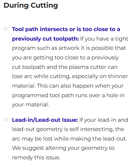

Here are a couple reasons that the cut might stop:

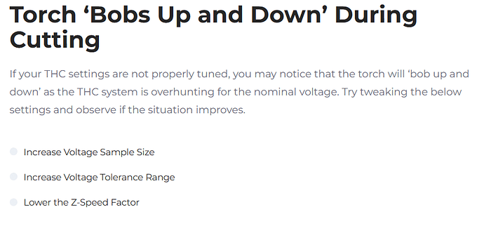

If you are using THC, here are a few settings to adjust to limit the movement of torch:
