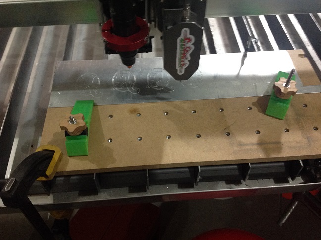

OK guys it runs like it should😍thanks Mike👍 I did find out you don’t need the 5 wall wart to supply the voltage. That was part of my problem
Now to the setup on the metal.
Here’s pic of my setup and what Cutzilla did using my Plate Marker Software.
Cutzilla%20Plate%20Marker
Did you have to play with the pierce delay? I was thinking that 0 delay and the table motion would run out ahead of the etcher contact and too much delay would dig a hole in your material before moving. Curious if you found the right setting. Any chance you could provide a picture zoomed in on the product?
I had it set for .5 second. Boy it is loud too. I will try .2 and see what happens.
I couldn’t get a good close up, I tried 0 seconds and there was Gap when it finished the engrave and started the next engrave. I tried 0.6 the gap just closed. I had the first engraving set for 0.8 instead of 0.5 so I wold guess that between 0.5 and 0.6 is a good start point.6
So I guess you have to find the right speed and then dog the needle valve down in that spot. Anyway, you like the results so far?

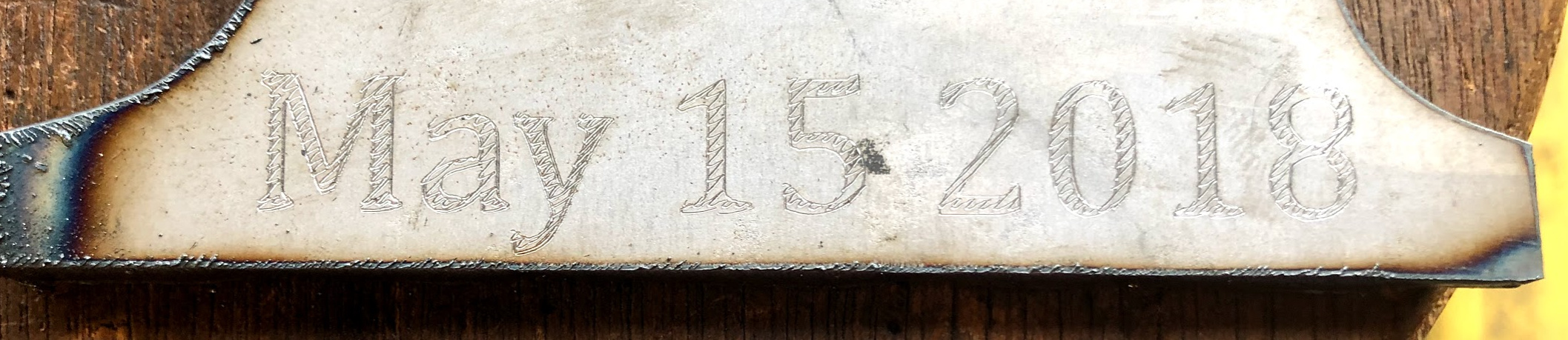

Well it has been a while since i posted last … I have my cutzilla running using the wiring Diagram from mjpotts (thank you !) it works well i have been using a speed of 100 ipm, but still playing with settings … the biggest issue i have is … to engrave and cut there isn’t a good way to set the offset . What i have been doing is slow but works build two programs overlapping each other with a index mark to set the plasma start point. access to io’s would still be a BIG plus and hopefully could setup the offset in the post processor . using Sheetcam could setup both tools in one program and then it would engrave and cut with out a reset in the middle … Cutzilla does a great job !! And I really enjoy my Crossfire Pro for all those little projects in the shop…

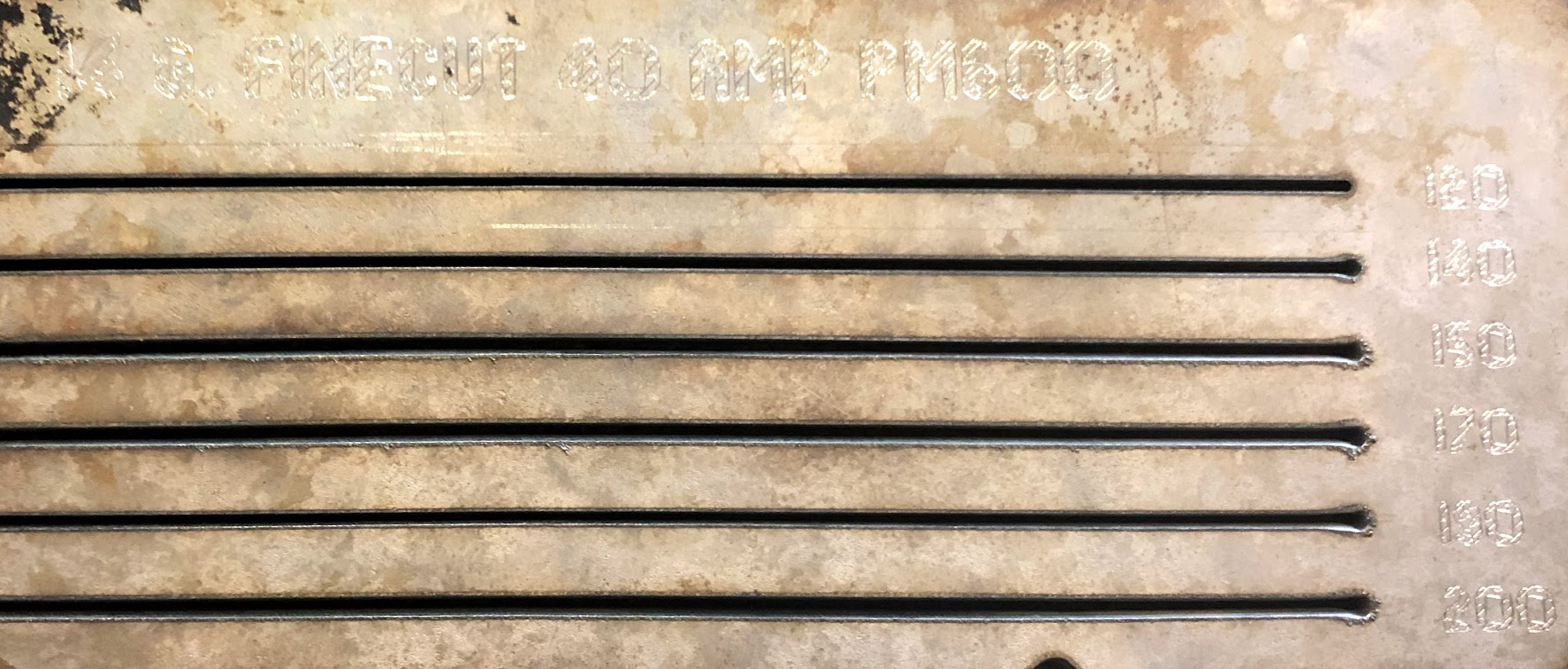

Plate marker Cutzilla in sheetcam use these settings
no offset
Tool# : 102
Diameter: 0.069
Feed Rate: 30
Cut height : 0
Start Delay : 1 s
Pause at end of cut: 0.5 s
