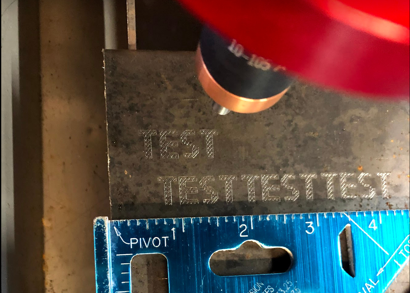

Quick video using Inkscape to add hatching to text, then marking using the EasyScriber.
In SheetCam I added a “PlateMarker” tool. If you don’t supply a cut height the post removes the Initial Height Sensing. So you can either add a slightly negative cut height (-0.001") or modify the post to always do IHS when the toolClass==“MarkerTool”. Also disable THC in Firecontrol.

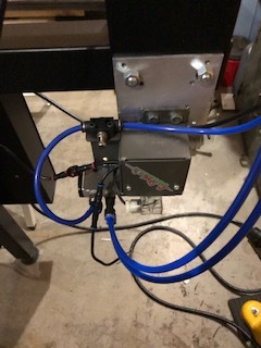

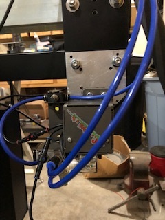

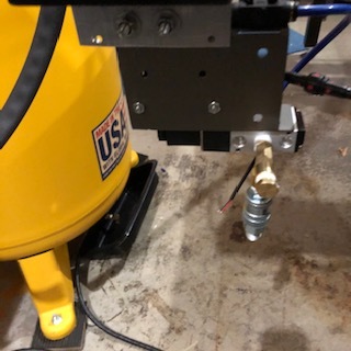

Ok I finished the air for the plate marker. Here are some pics. I made a simple 1/8" Plate, to mount the Relay control box to the Left Back side. I purchased a 1M Roll of 1/4" tubing for 10$, that it.
All that is need now is Langmuir to tell us what pins to use for the Plate Marker.
P1 P2
P3 P4

OK Guys Cutzilla works electrically, with Fire Control . Will engrave something later.

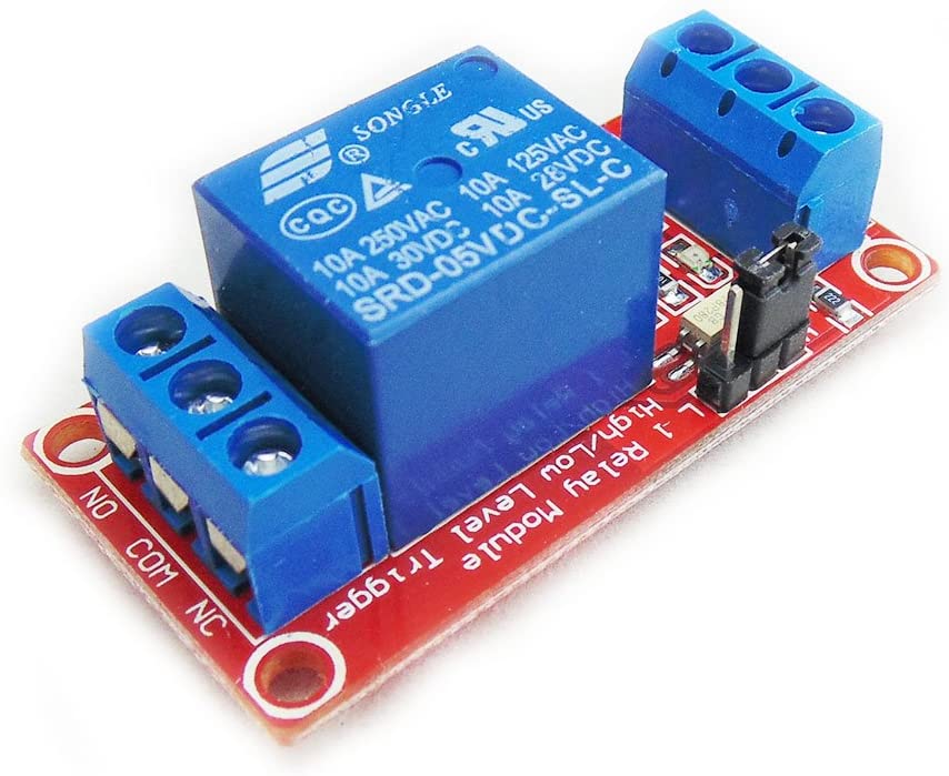

Something is up with the wiring. It makes no sense that the solenoid actuates the simply by turning on the power. What you are describing is 180 degrees to the unit I have. I would think it was tested before shipped to you but(spitballin’ here) maybe one of the relays is wired wrong? E.g., wired to NC instead of NO contacts. The picture below is similar to the 5vdc relay board in the valve box.
You’ll have to check but I think the solenoid uses the NO contacts and the jumper should be set to the “low” trigger. Again, I would bet your unit was tested before they shipped it so be cautious before getting into it but the solenoid actuating when you power on the 12vdc source isn’t right.
Thanks Mike😊
I check the relay it is set for NC and H. You were right.
