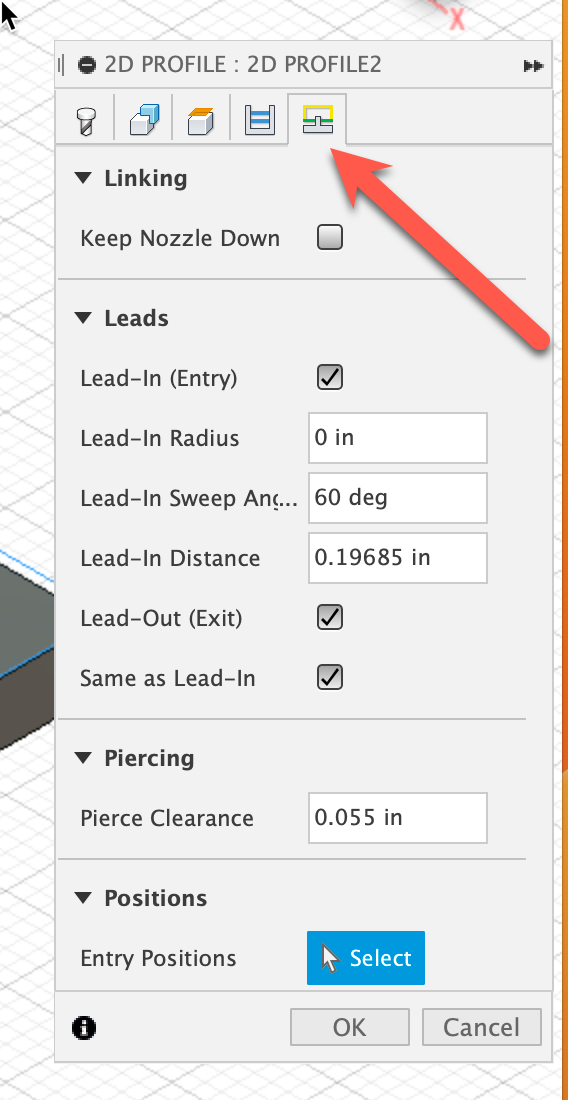

Do you have a cut chart for plasma cutter? A manual perhaps? Here are the places in Fusion you set feed rate, Fedd rate optimization and pierce height. Your pierce height looks very low in this file. .055 is closer to a cut height than a pierce height. What I seem to see is around .15 for pierce height on a lot of cutters but your manual should tell you that stuff.
FYI - Pierce clearance is not pierce height. It adds the value to the lead in / out. I recommend 0.
Pierce height & delay as well as cut height will all be located in post properties when you post process.

ok thanks I will set the pierce height to .19 and pierce clearance to 0

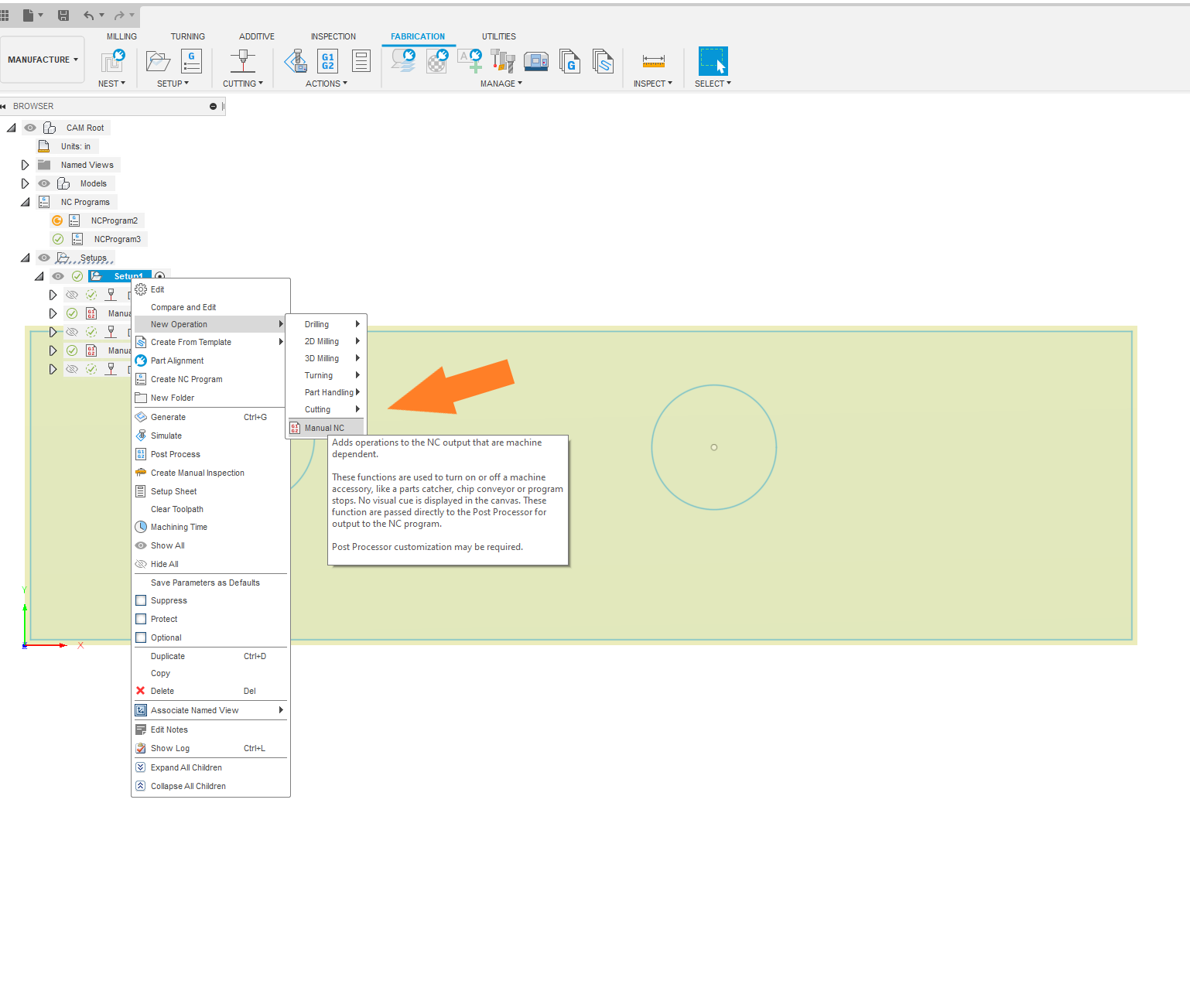

The kerf is set in the tool setting in the tool library of fusion. I already sent you a screenshot above that shows you where to set IPM in the 2D cut profile, first tab. I don’t think you can set pauses in Fusion I think you need to edit the G-code for that. You can pause it manuallly in Firecontrol. I would keep it simple until you have the basics down.
UPDATE: as @TinWhisperer points out you can in fact add it to the g code in Fusion, I stand corrected!
You can. it appears to make proper code but i have not run an actually program doing this way.

here are some screen shots of where to find and see the pauses or “dwell” in CNC talk.
Right click on the setup in the browser bar > new operation>manual NC then select the dwell option and write in your delay in seconds
