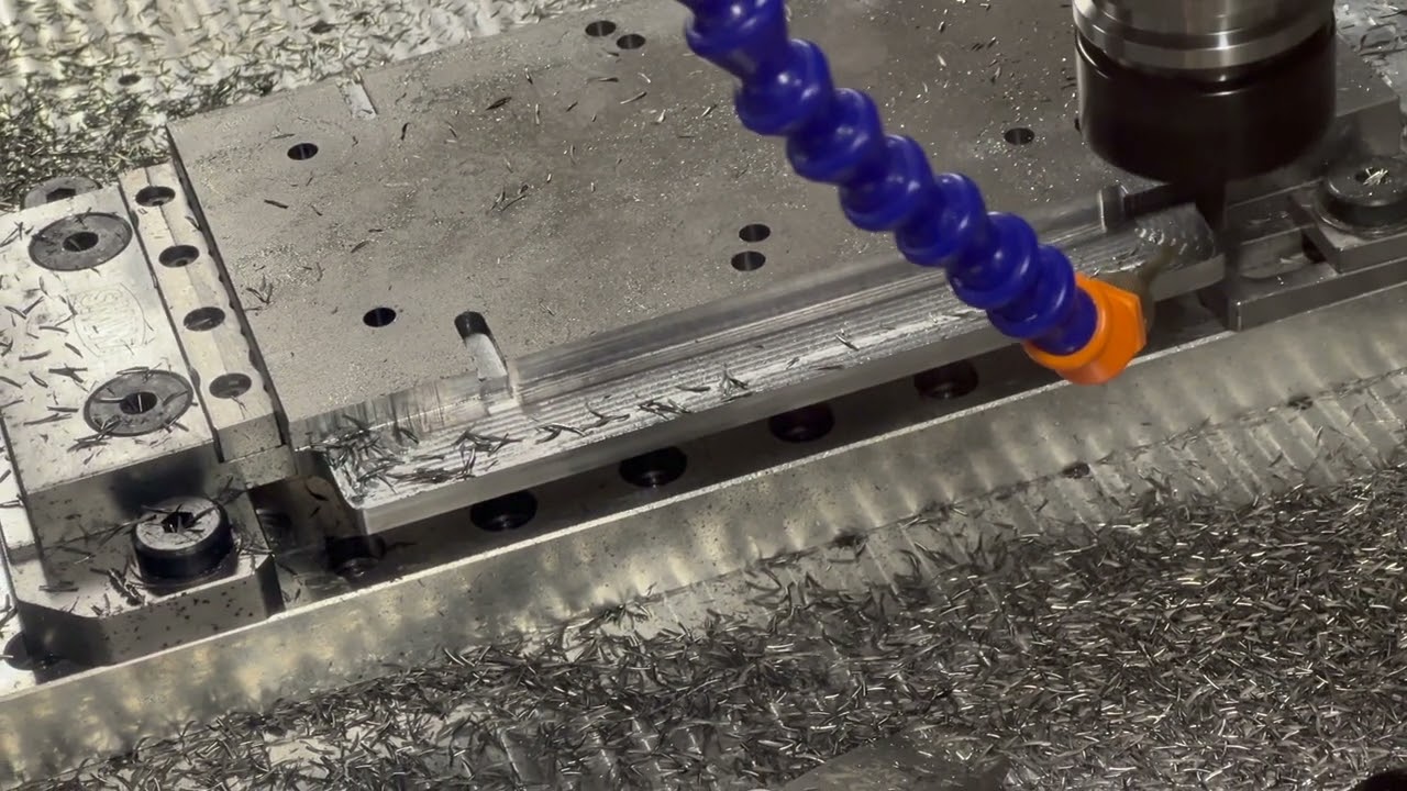

Are you using cobalt drills or carbide? I drilled some 1/4” holes in 6061 .75” deep today with the cobalt stub drills Langmuir sells and used the reference guide. Used the peck with partial retract in fusion and with ref parameters of 1525 rpm, 4.5 IPM, .04 peck and .5” accumulated depth. For the first 1/2” was fine and drill had full retract after accumulation depth reached as set. then started peck for the final but drill packed solid on the final .25”. This happened in multiple holes. I am using dual misters with “kool mist 77 solution” instead of flood…not sure if that has effect. Anyway looking for suggestions!

Yea…sorry I picked off the wrong numbers for the post to you…went back to verify in the CAM that I did use the non-ferrous numbers. So what is in
CAM is 4575 rpm, 6.75 IPM peck, .05 peck depth and .5 accumulation. I retracted after each peck 0.01”. As I mentioned the second peck cycle (after .5” accumulation was reached and there was full retract), the aluminum welded to the drill flutes.
Yes, those are the settings. 6061 is rarely gummy. You might want to spray some coolant from a spray bottle during the drill process. All the settings have worked for me.
Will try that…I use WD-40 on my Bridgeport when drilling aluminum and it seems good but I’m hand feeding and can adjust if I see chip sticking to drill!
With everything being the same. The flood coolant is the only difference.
I use KoolMist 77 on my machine with a Fog-Buster type coolant system. Are you doing full or partial retract on the peck? I have to do full retract when drilling deep holes to make sure that any chips are blown off of the cutting part of the flutes.
The start of this video shows a 3/16" hole being drilled 1/2" deep in steel and you can see the full retracts:
Aluminum is gummier, but I use a similar process, just higher RPMs and feed rates.
i do chip breaking with partial retract unless the hole is greater that the 3X dia as recommended in the “starting Parameters Ref Guide”
