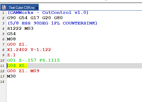

This is the post processor I have developed for CAMworks and the MR1. It has been working for 2.5 Axis ops, Drilling, Countersink* (see below), and I have compared code between this post and the stock one for 3-axis ops and they are identical but I have not ran it yet.
NOTE: for anyone wishing to use this post processor; it is experimental, use with caution and at your own risk.
MR1 V1.3.zip (25.1 KB)
There are two known bugs:

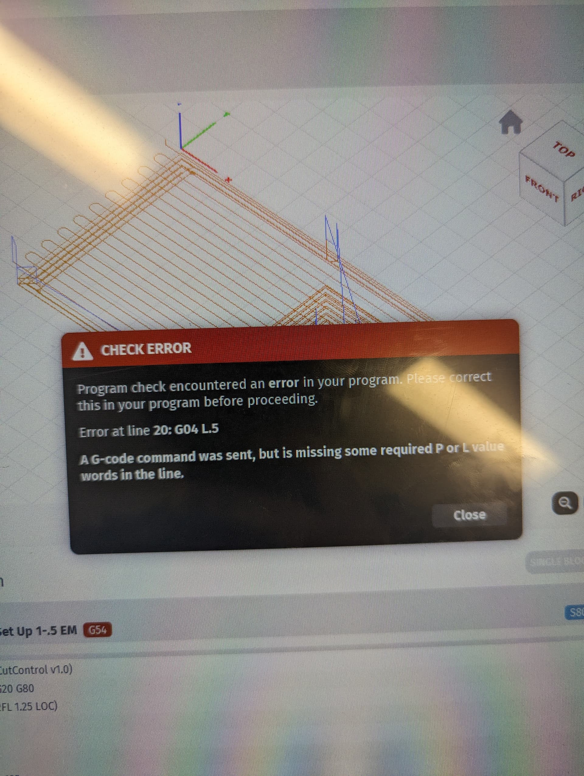

  • When using a spot drilling or other drilling cycle it will not output the dwell P or L values and you get the following error on the machine:
“A G-code command was sent, but is missing some required P or L value words in the line”
Below you can see the highlighted code calling for a dwell time (G04) and then a 5 second dwell (I was using an abnormally long dwell for testing the code to make it easy to track) but for some reason the time is then output as “X5.” instead of “L5” and I cannot figure out why:
Dwell Issue
The easy, but hacky, solution to this is to just not use dwell time and set it to zero.

I think I’ve resolved the X posting instead of L for the Dwell. Give the attachment a go.

Tried this out today, still outputting the same “G04 X1.” line.
Damn, I not as simple as I hoped.
I see where I went wrong! I also changed the dwell calculation value so see if that is also correct now.

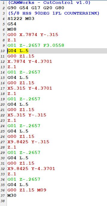

Gave this a try today, it is now outputting “G04 L.5” but the machine still gives the following error:
Here is the code output:
Any Ideas?
Very easy fix. What value were you going for? 5 seconds?
No it was half a second there, for example 1 second will post as “G04 L1.”
Ahhh, yeah the MR-1 only recognizes whole seconds. The dwell function is kind of useless without ms but it kinda sorta works.
