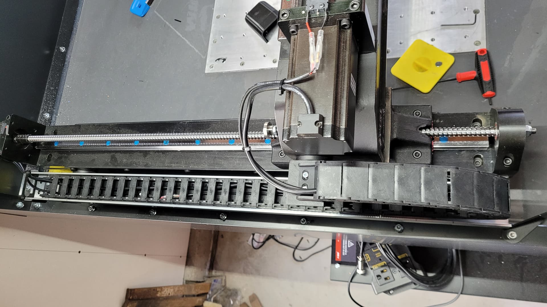

I’m not the most knowledgeable about steppers or servos either. Maybe it’s a topic that deserves it’s own thread.
Amazing build mods… thank you for posting… many I plan to implement… might I ask a question? why are the drag chains so wide? they open up so you really need only slightly more room than the wires they transport…
Also I to am interested in more Z clearance… I was thinking of precision ground “blocks” acting as spacers like 123 blocks… please keep in mind I am not nearly as far along as you are… that is why I ask. thanks…
The inside dimensions for mine are 40mm x 15mm or 1.57" x 0.59".
The y-rail cable carrier will need to carry every cable for the X & Z axis.

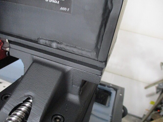

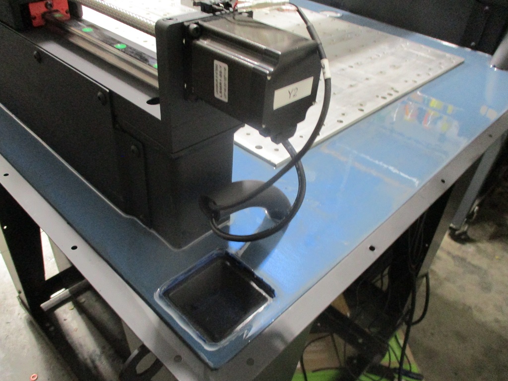

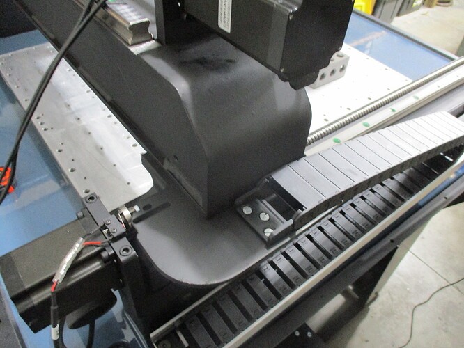

Here are some pictures of the 3/16" Y to X spacers. I will likely remake the left one to move the cable carrier attachment further away from the limit switches. I had to do a little trimming to get to the hard limit and clear the switch.

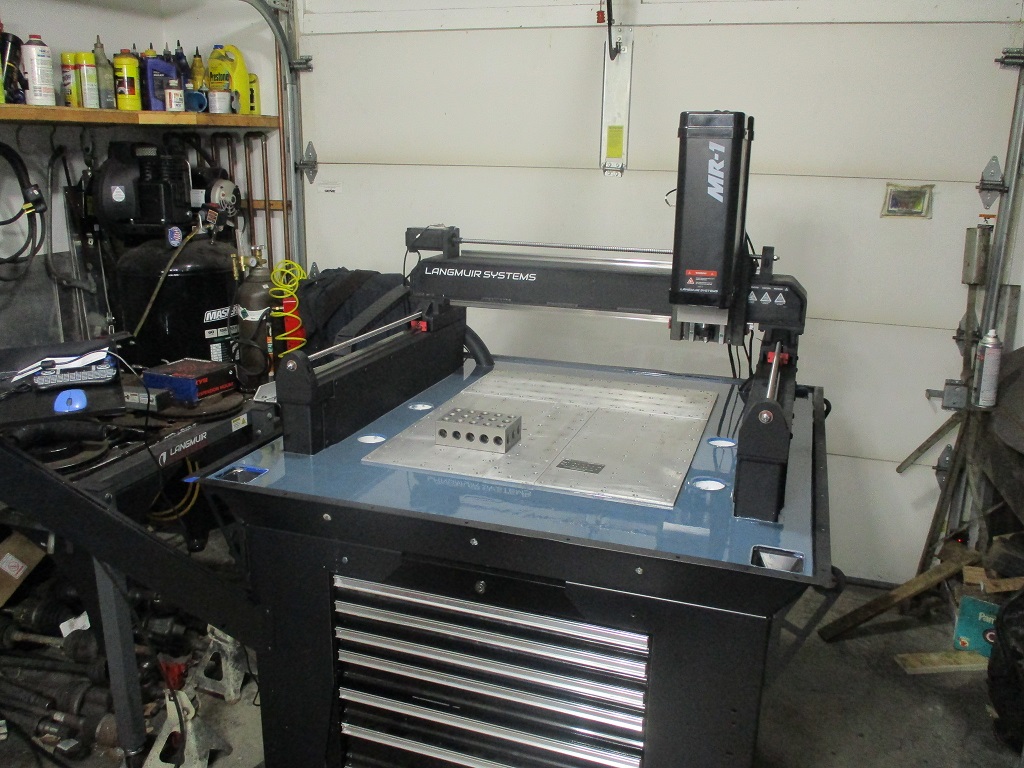

Here are some overall pics showing the current state of assembly.

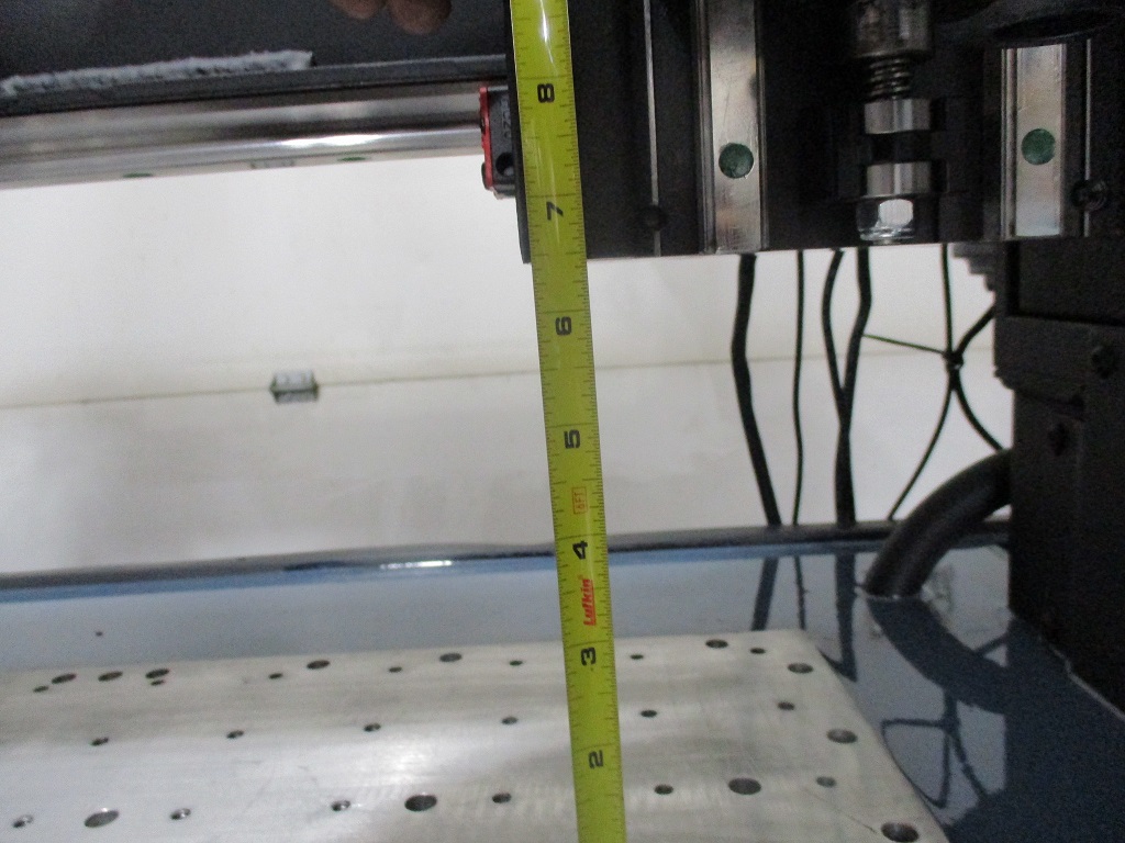

The MR-1 spec is 5.5" clearance to the X-rail. This is measured on my additional baseplate that was .750" thick and stands proud of the Langmuir plates about 0.060". Once everything is surfaced it will be a little more than 6.5".

Since you only get to install the baseplate 1 time, I figured it should be as large as possible to allow clamps to be outside of the milling surface as well as have mounting space for a 4th axis - even if it is manual.
X travel is 23.0" and Y is 21.8" with the stock baseplate being 20" x 20.5".
Several guys had already installed a 3rd baseplate by the time my machine was delivered, so there really wasn’t any concern about surfacing it. I tried to order a 3rd baseplate from Langmuir, but was told they were focusing on shipping machines and would not sell me one.
Faced with making my own, I took a harder look at the width knowing the limiting factor is what can be surfaced. Other people had used the 2" fly cutter to surface their baseplates, so taking it 1 step further… 23" travel + 2" fly cutter = 25" surface area.
I also wanted to keep 2x2 bolt spacing as close as possible from plate to plate across the entire work surface, so that put some constraints on adding the width in 2" increments. 2" (22) would work, 4" (24) would work, but 6" (26) would require an even larger fly cutter and might have issues So I settled on 24" wide.
With the 10" rear plate the overall baseplate is 24x30.

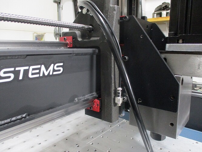

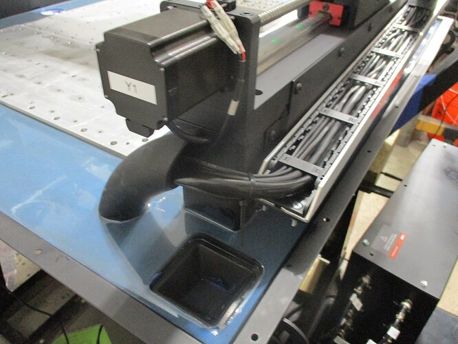

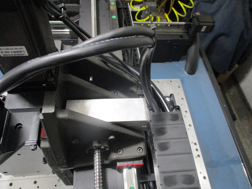

Finished with the fabrication of the cable control rails. I did end up extending the Z limit switch cable about 4’, but once that was done, everything else fits like it should. There is ample cable length to tuck the controller box up under the left hand side. All the cables are currently in place, but I left most of the covers off for fine tuning lengths at each motor/switch/device.
Here you can see the probe and flood coolant hose. Both are longer than they need to be:
Here is the backside of the spindle:
Here is the backside of the X-rail:
Here is the X to Y cable transition on the remade 3/16" plate:
Here is the Y1 to conduit transition:
The Y2 to conduit transition:

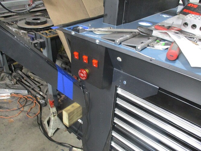

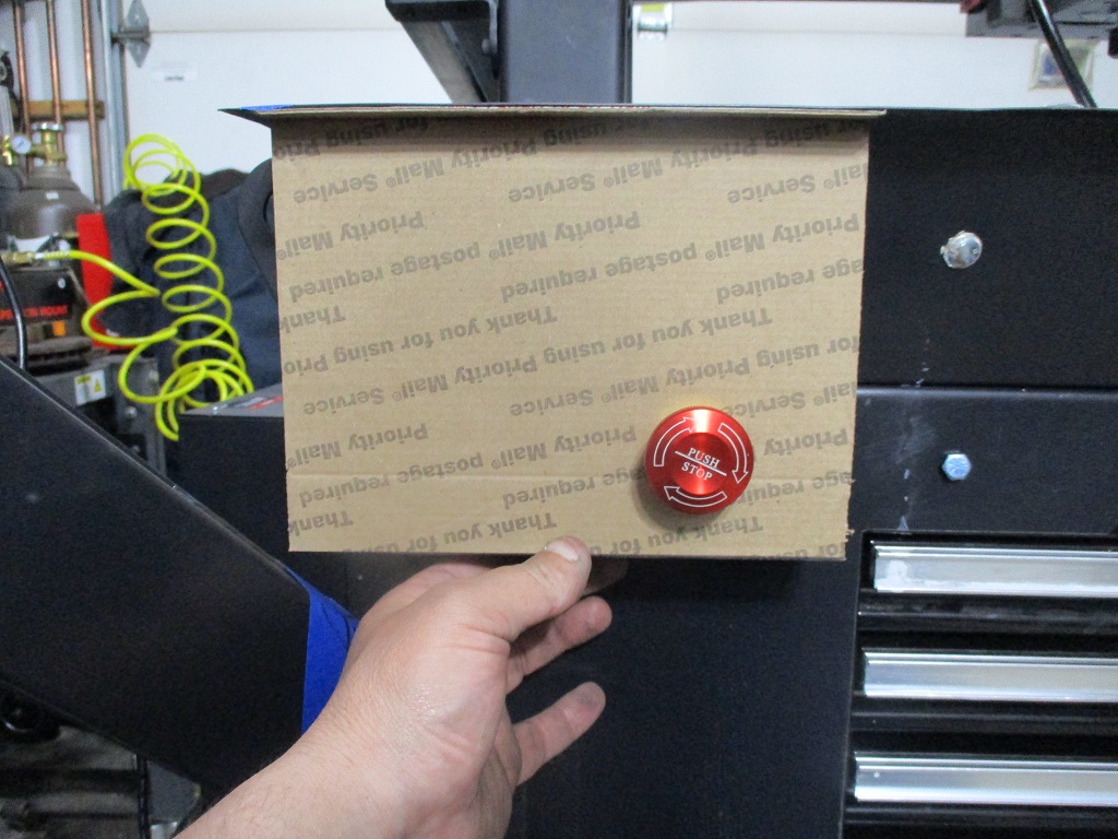

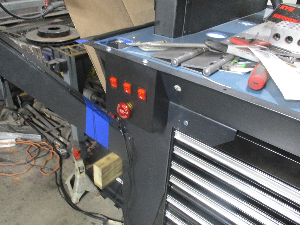

Here I am getting started with the relocate the E-stop, 120v switch and 240V switch to the front of the machine:

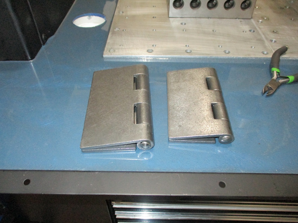

Here are the hinges for the computer stand. One to swing the arm out of the way, one to drop the laptop tray vertical.

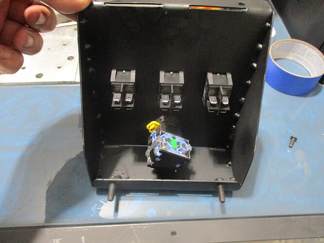

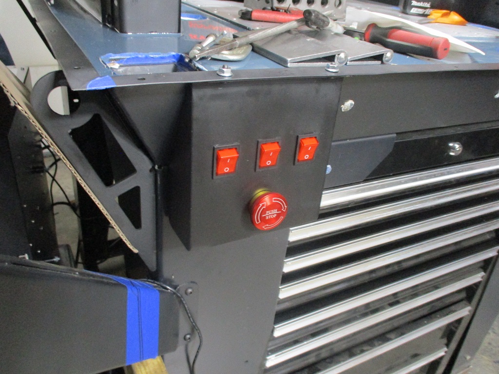

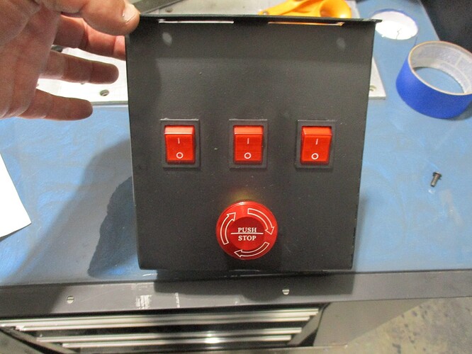

The fabrication of the auxiliary control box is done. It has the e-stop and switches for the 240V spindle, 120V control power, and 120V for the lights. The wires will pass through the leg into flexible conduit back to the control box.
i like that, i moved my estop up but moving those two buttons would also be super helpful.

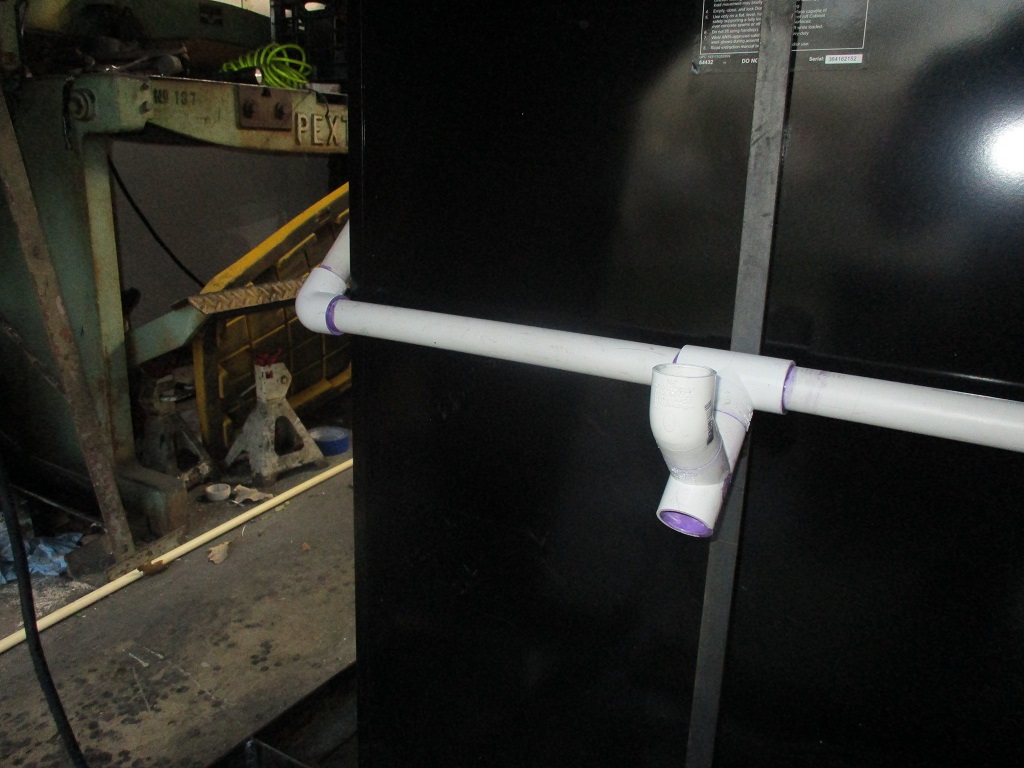

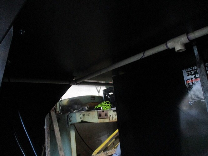

Had some time this afternoon to mostly finish out the drain plumbing. All 8 drains will drain into a single pipe. I am thinking about installing an large filter pod of some kind to collect the debris while letting the coolant drop into the tote below.
