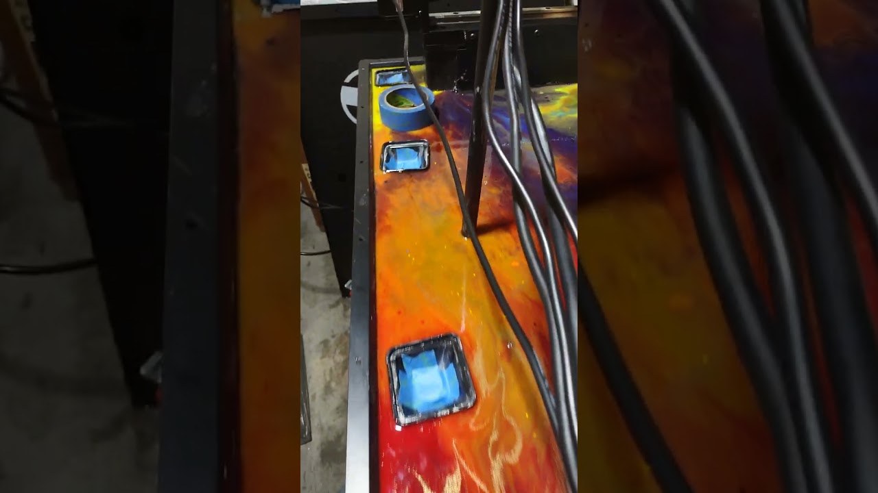

We also located the control box to the front leg so we could turn the thing off if we need to in a hurry not sure if all the cables are going to reach now but we will find out tomorrow

We are looking at that right now what we are looking into is linear rails for the door once we find these we’ll probably make the doors and lexan or a clear plastic of some form

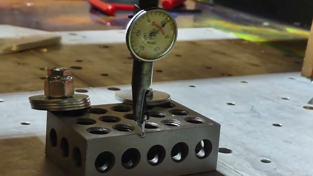

I am a little bit unhappy with what you have to do to get this machine to be straight the guy on the video is constantly doing work off camera this does not help you to find out how long it takes to trim this machine in this is a long and boring process to go for and this is only one of the things that I have the hump with more to come
We are well on the way but there are 1or2 things I am not happy with I do wish this guy will show you what he is doing off camera this drives me crazy trying to figure out what might be the right way to do this or not

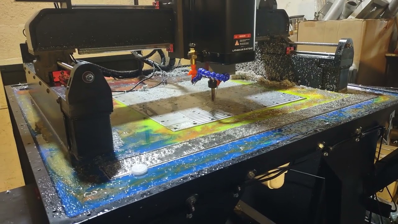

Wow we are getting close a few more adjustments another day or two cut out chips

Chips will be on their way soon just a few small things to do then I can call on some scrap metal
