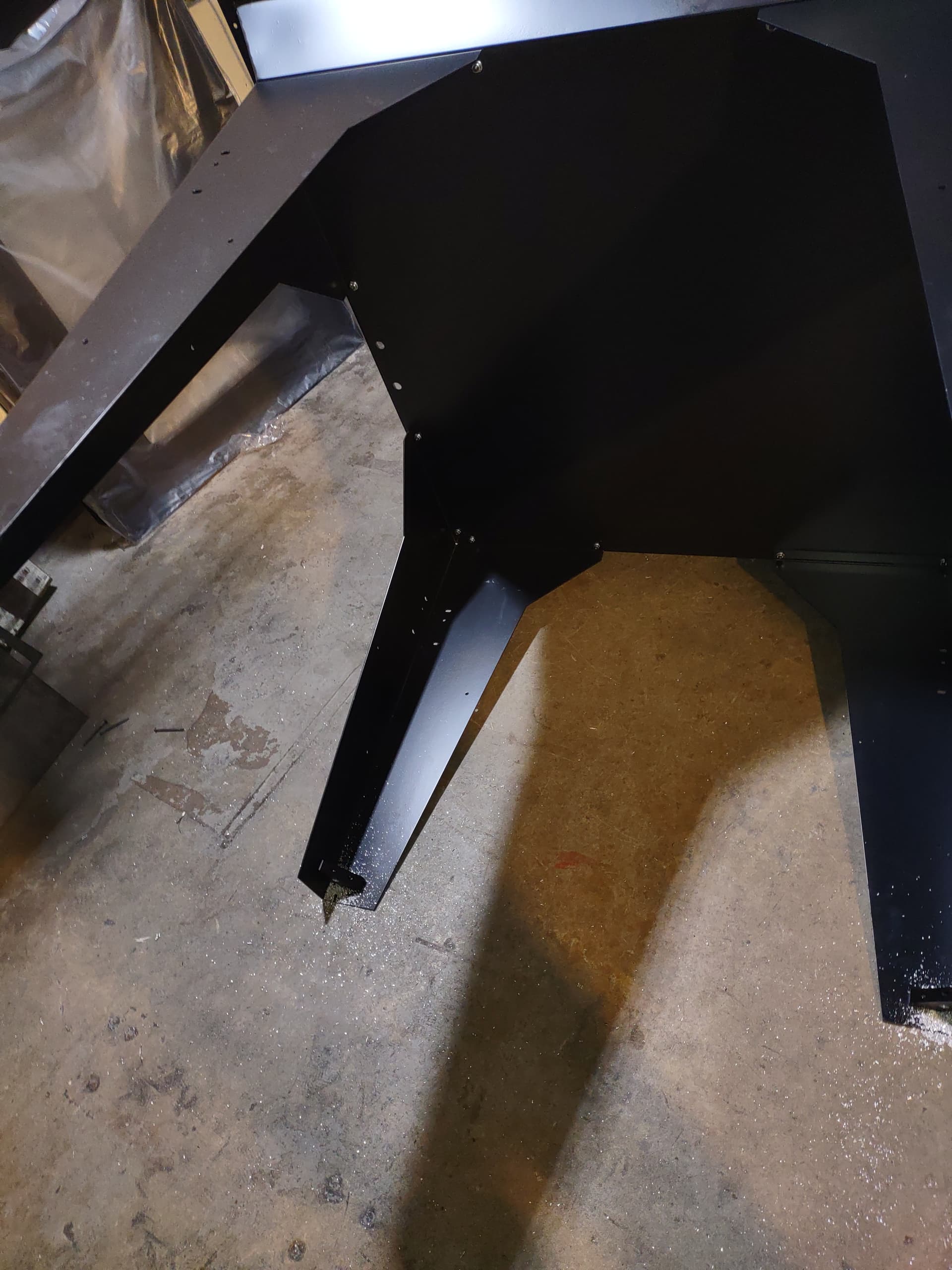

Best out the box is the table and we’ll see where we go from here
Build a steel frame to roll around on when I need to clean up

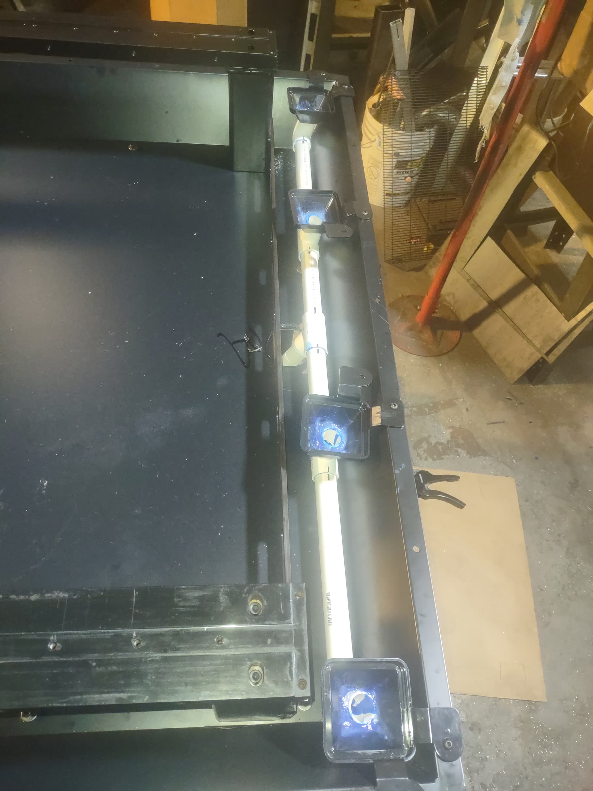

We took a look at the dreams that came with the unit and decided to drill bigger holes for free quarter inch AC drip lines
After sometime looking at this problem we decided to go through the whole we already made with the PVC pipe This look like the way to go for now
The more ideas I see the more confused I get there is a ton of real good stuff on YouTube as well as on this forum but I’m trying to keep it simple and on a budget
One of the things that I am looking at is the final dream before the pump I’m looking to use 100 micron filter to save the pump cuz this thing is needed for most of the work I might be trying to do so my thinking is protect the pump and it will have a long life without any problems

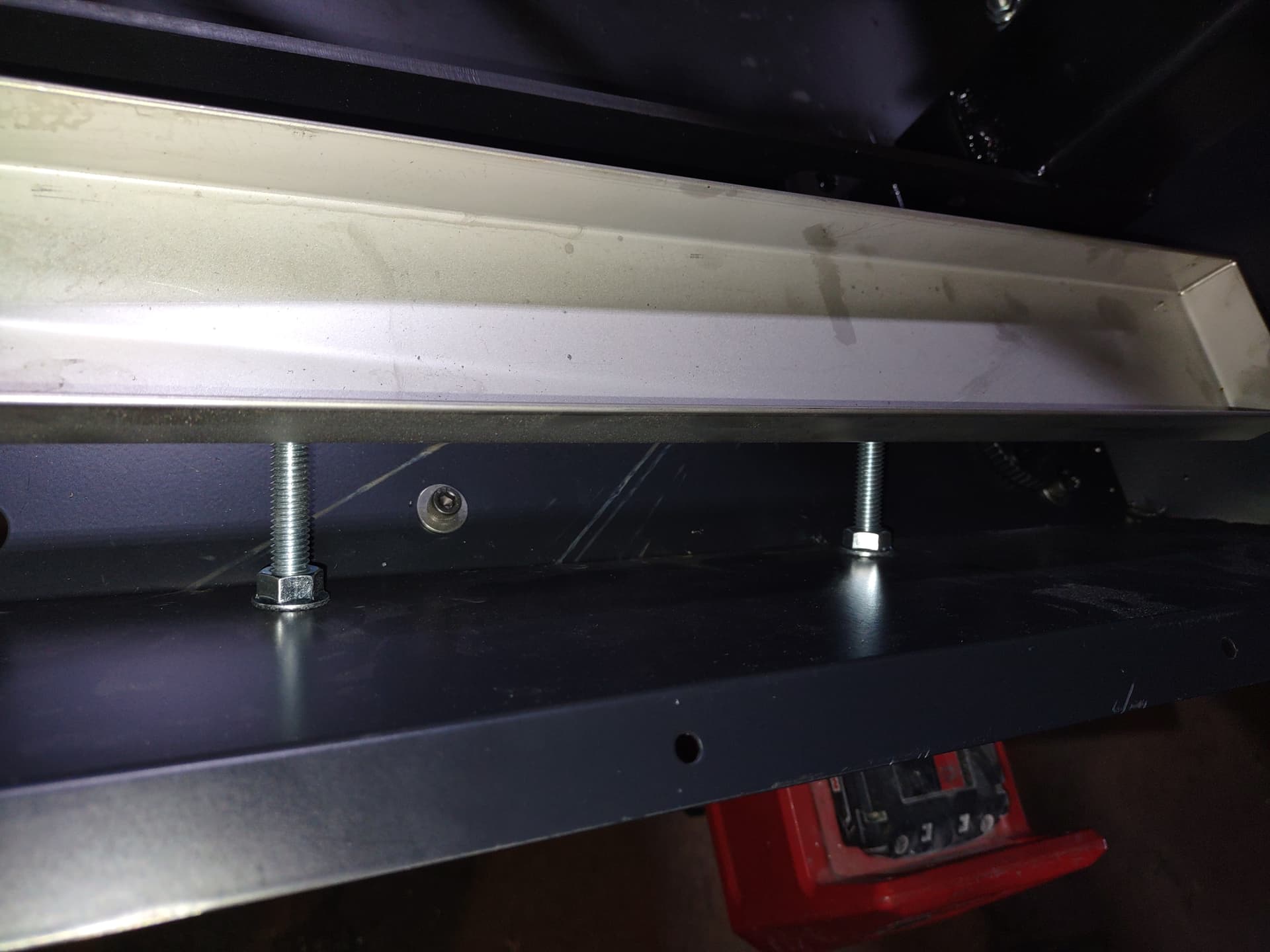

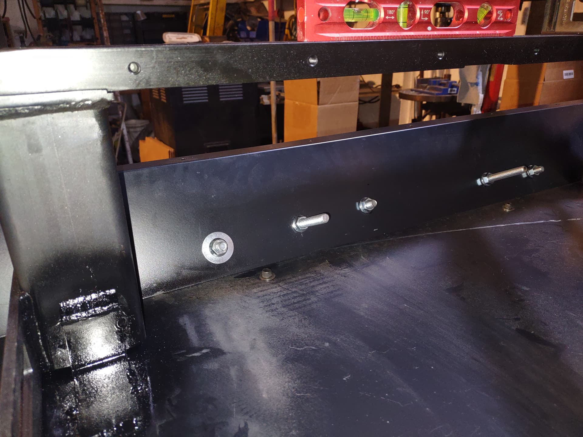

One of the things I see is that concrete will not stick to a smooth surface and there is no way that this thing will stay together over time with vibration there is nothing holding the base to the carrier so we drill some holes and put 3/8 16 boats through the floor to keep everything in place for the long run
We also think it would be a good idea to welding some tabs to keep it all tied in.This is a lot of work and this is only the first day I do not see this thing up and running for at least two more weeks

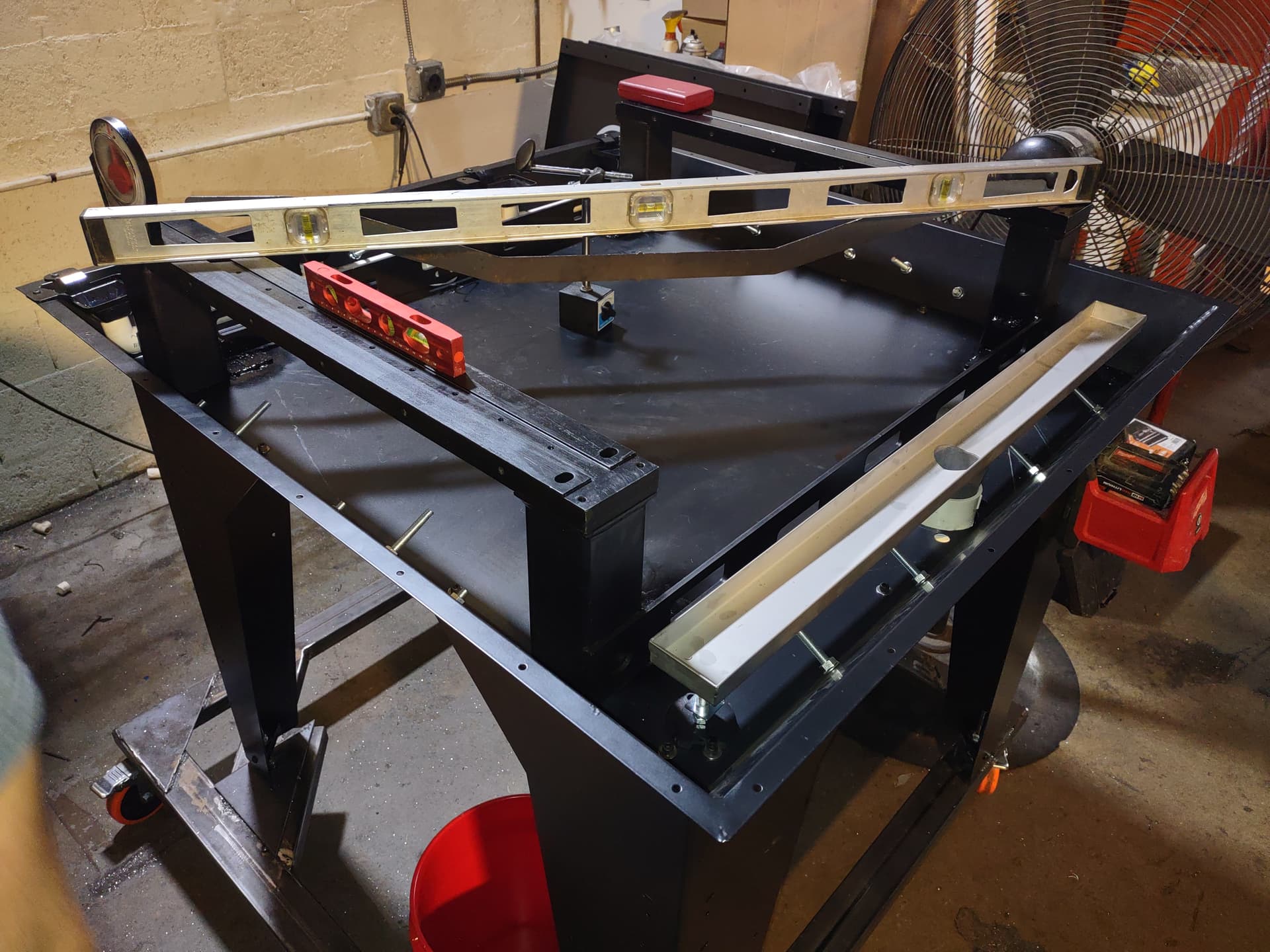

This setup for corner to corner with that flimsy thing to take a measurement from is madness the floor is constantly moving and this thing is constantly wavering around this took up so much time and I looked at the video on YouTube and that did not help either so we had to brainstorm how to keep this thing still so we can get our measurement
GRRRRRR NOT GOOD
It’s just a rough measurement at this stage before the concrete goes in- Once the concrete is in it will be extremely stable (when it matters).
We’ve got a machine here running for 3 years every day (cast iron and steel mostly)- the concrete is perfectly intact. The reason that we do not advise mechanically bonding the concrete to the tray is because if one of the legs were to be bumped, it puts a load through the concrete which may cause it to crack
One other thing to keep in mind, the more ‘stuff’ there is in the concrete, the less concrete there is. Stiffness and mass damping of the base are what give MR-1 its performance.
I would have to disagree with you on this for the simple reason is I have poured hundreds of car Parks hundreds of walls and car park suffer when vibration allows the steel pond to move so vibration of any form will separate a a surface that is non-porous does not have the quality of a porous surface to bond to concrete was my life for over 40 years also what you have to look at is there are many forms of concrete from small pee aggregate to large pee aggregate there are fiberglass infused concrete known as Kitty hair that pump grouts and various other forms of concrete out there this is the most basic form of concrete being used in here which means it does not have all of the bonding qualities that you would get from a kitty hair concrete mix of 4,000 plus PSI
I did a small video to show how this thing works and I cannot post it directly on the forum I think I have to go through YouTube and put the link so you can see how well it works the large drain has a 2-in outlet which I’m going to cover with 100 micron filter this should keep all of the debris out of the pump but this is the way that I did it but there may be better ways to do this but this is what we have for now I will be looking forward to help from members on the forum when I get this thing up and running
Sounds great. No worries. We will assist you in making a chip mess. :grin:
I put that same drain in the back of mine, you won’t regret the extra work to make it fit.
