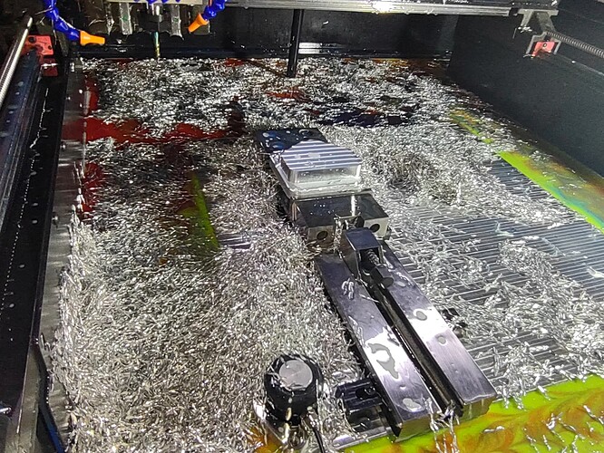

More upgrades on the coolant side
A different view of my upgrade mate
Today was the first day and cut some chips well we can only get better from here
