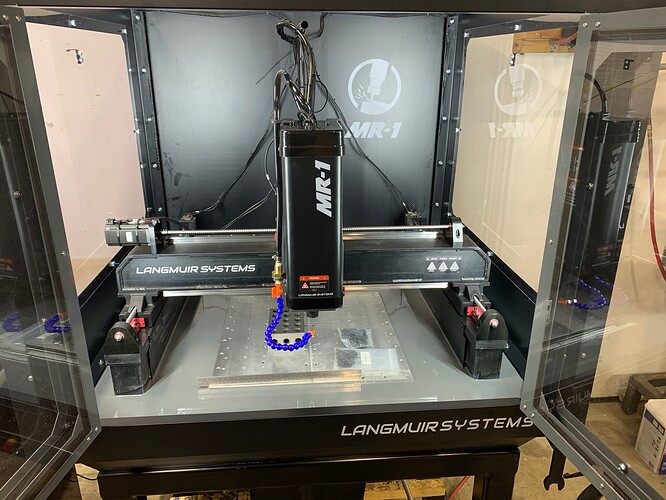

Build of MR-1 SN74
Looks like it gives good light where you have them
Youngest son got bored and made some Nice drain covers. The mesh screens are still inserted as well.

He helped me put this whole thing together. He just started his first year of college at Mississippi State for mechanical engineering. We will be able to have a lot of fun with this thing
Oh boy. It showed up early.
Thats it. You may want a discharge valve on the pump so you can throttle it down some.
I have mine just barely flowing and it works awesome. You’ll see what I mean…

do you know if the flood coolant box is just a relay of sorts? Is the signal just on/ off DC?
I believe so. I don’t know if its a DC control loop? The power supply is DC output so its probably so.
The relay can be DC 3-5volts or can be 12-120v AC.

Hmm I wonder if I can use a standard relay rated for 120v with a 5v coil or If I need flyback protection or some kind of isolation built in. I have a feeling the “Optical” in opto relay has something to do that. This will probably be a better idea. https://www.amazon.com/HiLetgo-Channel-optocoupler-Support-Trigger/dp/B00LW15A4W/ref=asc_df_B00LW15A4W/?tag=hyprod-20&linkCode=df0&hvadid=198090929431&hvpos=&hvnetw=g&hvrand=3422717678390718687&hvpone=&hvptwo=&hvqmt=&hvdev=c&hvdvcmdl=&hvlocint=&hvlocphy=9031093&hvtargid=pla-348614466893&psc=1
Little more progress on the MR-1! Should be getting close to surfacing the plate soon…
Got the extra windows installed on the doors. Wow, this will be much better to keeps the chips and water out of the windows. I cant remember who came up with the idea for the added window panes, but kudos to you. We got the wash down hose, motor, and line installed as well as the lights installed. Thanks to #Bigdaddy2166 he helped me troubleshoot one of the lights that was not working and we got it going. Got all the drain covers finished 3d printed and all installed… Its coming along pretty well so far.

Humm…. wonder if this is going to be a problem before surfacing the plate.
No issues here, just means more stock to take off. It’s not uncommon to need to remove up 0.060" in some areas.

Do you have part numbers or a thread link to the added coolant pump and plumbing as well as the led lights?
Here you go.
Anbull Self Priming Water Pump… https://www.amazon.com/dp/B099YZRB84?ref=ppx_pop_mob_ap_share
XINYIQI LED shop light 20W IP66… Amazon.com
