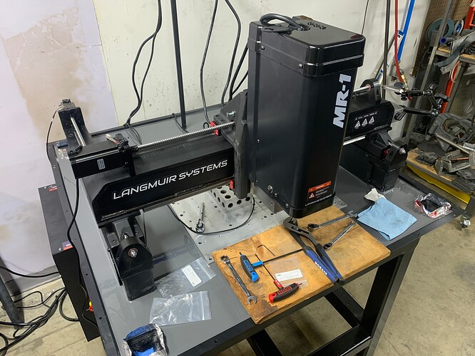

More progress made yesterday. Y and X axis’s complete. Spindle shimmed and installed. Gantry squared and hard limits set. Did a first homing of the machine and it went great. Started a pre assembly of the enclosure to make sure things fit right before final assembly and caulking. Slow process but satisfying. You can actually pre-square the X and y before you put the spindle on. All you have to do is attach your indicator to the bottom of the XZ spindle bearing, the bottom one, and are able to use the servos for the Y and you can manually push the bearing block left or right for the X. This allows you to get it very very close before you put the spindle on and then you can fine-tune it after the spindle is installed.

Well yesterday was another productive day. We got the soft limit set, all the wiring pretty much done and in place of where it’s going to be but just a little fine tuning later on. Still have to install the touch probe and the tool setter but that could be done at a later date. We got the enclosure all put together and sealed and installed the corner drain blocks that we printed off thanks to #custommetalmke. They are great.
Hopefully we will have a tight leakproof machine. Getting very close to surfacing the plate.
Not sure where to put the lights we got thanks to bigdaddy2166’s recommendation.
They work great right here.
