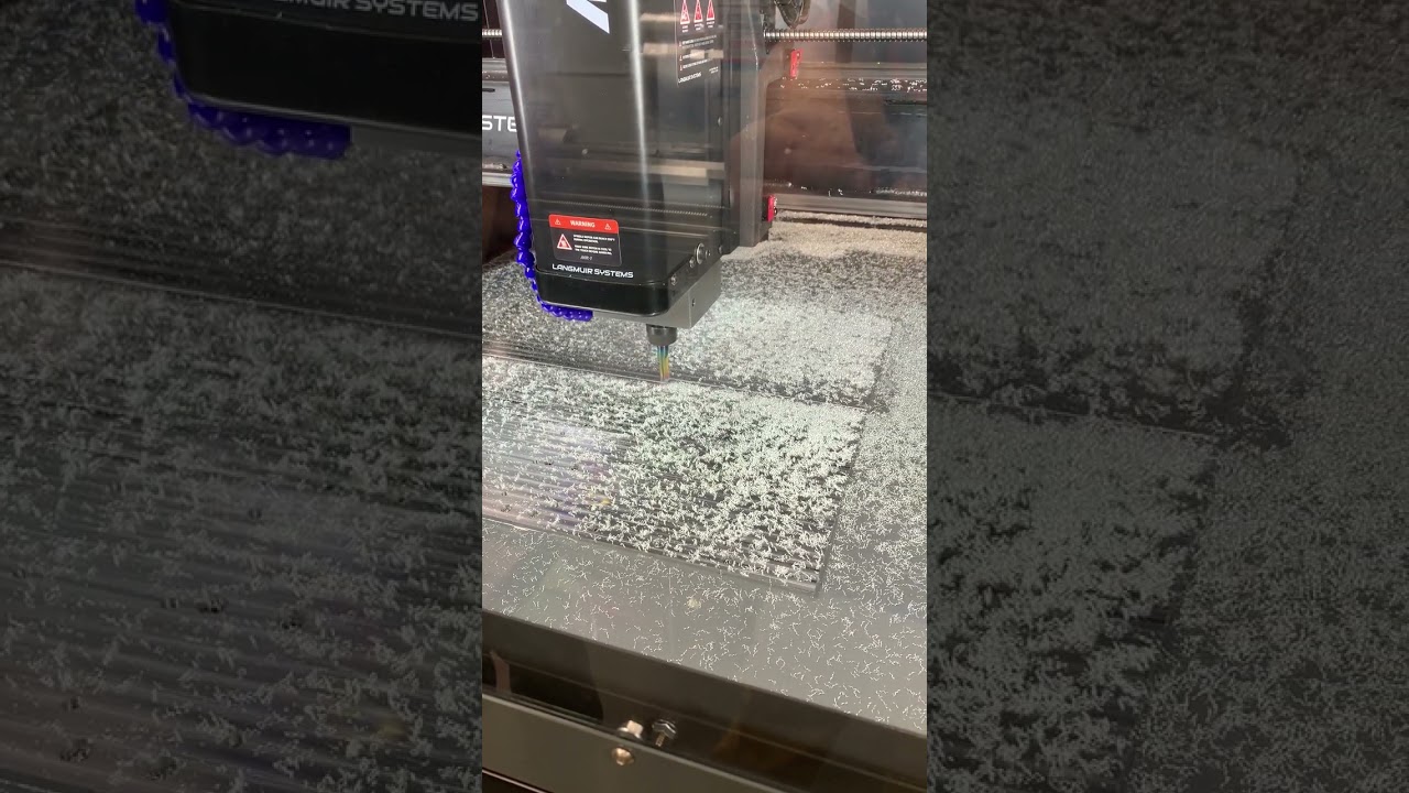

Holy crap… .060"?! I wonder what results someone could get from starting with a better toleranced fixture plate. I would love to machine my own and get hardcoat anodized then add some steel bushings and thread inserts… The baseplate is my biggest question mark with these machines.
Yeah, i thought the same thing. My concern with having to face that much off to start with, is that i am milling the surface plate with a z head that has not been trammed in yet, so really dont know where i stand, and next after i surface the plate, i plan on checking the traming. After that, i will have to surface it again. hopefully not much, but it is still material that has to come off.
Well, spindle break-in has been started…1hr left.
the smaller the endmill you use and the smaller the step over, the less tram matters… maybe find the highest spot, surface it then check tram on that surface with a 123 or 246 block before steping down and doing the whole plate.
Well, spindle break-in is complete and the plate has been surfaced. Man, what a beautiful sight it is. It is the cleanest it will ever be at this point…LOL Going to look at tram tomorrow and see where I am.
Very good job my friend :clap:. I bet, milling that base plate has a very high pucker factor?
Go have a beer and look at it…
It was a little nerving when I hit the start button for the first time but everything went good. Can’t wait to get the first part going
