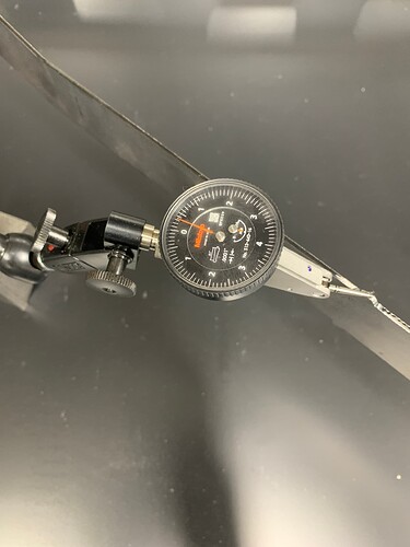

Sooooo…I started playing with coplanarity and found that my Coplanarity gage that was sent, the laser cut dimple(if that is what you call it) was cut terribly. I checked it on my surface table and found it had a rise of 6 thousandths, so there was no way to try and use that in my opinion. Lucky for me, i have a mill and milled it down .008 and got it perfectly flat, Should be a more accurate reading now when I do the check for real. For those of you that have a mill, I suggest checking yours as well and milling. Just trying to get the most accurate table that I can.
Before machining…
After Machining…
Here is a test run, before concrete of course. I have figured a way to adjust the coplanarity with out using shims, I think…LOL.
Thanks for sharing. Just a PSA that we mention in our manual to file this nub flat if needed during assembly; it will achieve practically the same result.
