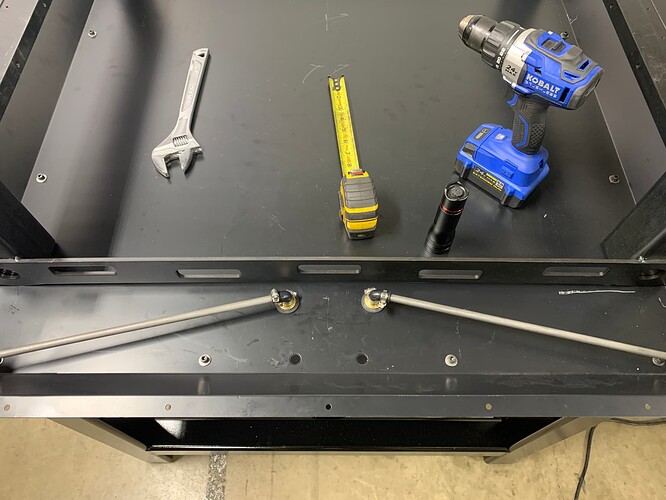

For anybody that has put theirs together, have you got a recommended distance from the wall to place the unit and still be able to do what you need to do while assembling and final placement?
The cabinet needs to be 7" from the wall. Thisw allows the wires plugged into the control box to not be folded over. But with yours, you could mount control box farther foward.
roger. Thanks
I have been busy so have not made much progress with the assembly, but am positioning the tub now. It will be placed in a corner, and my lathe will be beside it along the back wall. The default location for the control box appears to be on the left back leg, which means the end of the lathe will be close to the control box, making it hard to service.
So the question is, Is the cabling long enough to move the control box to the left hand front leg? I have no problems with modding or welding in a support.
Cheers,
MIke
Yes, I believe so. Like I told sr71xjet. You need 7" from wall to cabinet and 11" from top of legs to wall.
The control box wiring sticks out the back and any closer will fold the control wiring.
This is at 7" from cabinet
With my new stand, Ill be making a mount to work with that.
Holes drilled and tapped . Everything lined up Great. Pan installed and distanced adjusted according to directions. Stand and pan put in place for concrete pore. Drain holes relocated due to 3" tubing. Coplanarity has been dialed in to aprox .0002.
